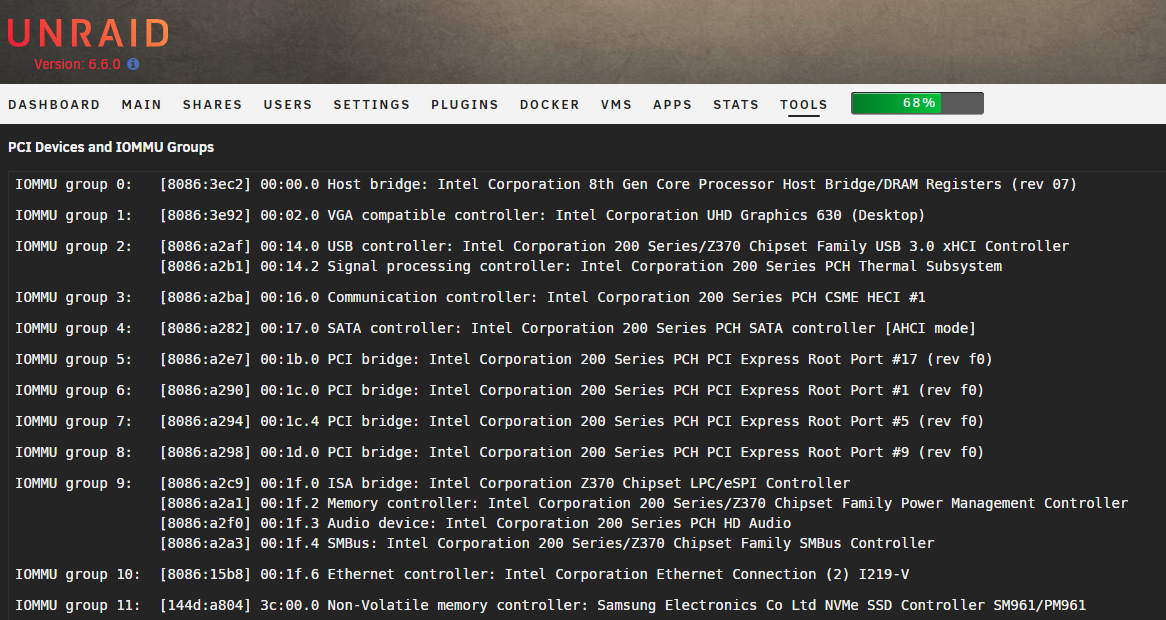

I just received my new NVIDIA RTX 2080 with which I was hoping to do GPU pass-through with to a Windows 10 VM and unfortunately it doesn't appear that UNRAID even recognizes it. I am running UNRAID 6.6 final on a Asrock - Z370 Gaming-itx/ac, with an Intel i7-8700, I have VT-d and IOMMU enabled. In the bios I set the integrated Intel GPU to "ON" and I also set that as the primary (although I also tried with PCI-e GPU as the primary and got the same results). I also tried with the integrated graphics set to auto.
I don't know if its a matter of the card being too new for unraid to recognize it or if I am missing something else. From all the guides I have read, it seems that unraid should at least see the card and the trickery comes in when trying to do the passthrough but I am not seeing the card under system devices and it is not an option for the GPU within the edit VM settings. I have already tried the basic hardware troubleshooting of re-seating the card and power cables, and i dont have a second pci-e slot to test on so I came here.

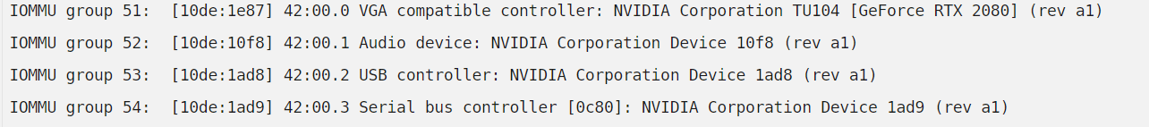

I was able to get my RTX 2080 passthrough working on a Threadripper system with a Gigabyte X399 Designare motherboard. Initially I got an 'IOMMU group is not viable' error, which was due to the card having an internal USB controller in the same IOMMU group. After changing PCIe ACS override to 'both' under VM Settings, IOMMU groups were split up and I was then able to boot the VM with the RTX 2080. Performance has been great. I plan to try passing through the USB controller at some point in the future as well.

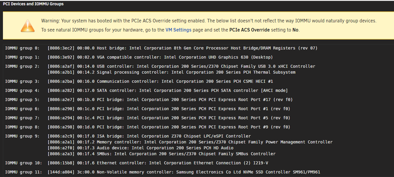

I just tried setting my PCIe ACS override to 'both' and rebooted for the heck of it and I got no change unfortunately.

No, I didn't have to do anything special. I have the Founder's Edition card. It's definitely odd that it isn't showing up in lspci for you, so I'd have to guess that it's motherboard/chipset/CPU related. Also wanted to mention that I am running in UEFI mode.
An update on my previous comment, I have now passed through the NVIDIA USB and Serial bus controller devices. I added vfio-pci.ids=10de:1ad8,10de:1ad9 to my syslinux config for them to show up in the VM template in Unraid. Seems to pass through fine, but no use for it it yet. I tried to plug in a flash drive but it didn't show up in the OS, so not sure exactly how this port is configured to function. I know it's meant for things like VR headsets but was hopeful I could also use it for regular USB devices. I'll have to test a keyboard or something basic like that.
