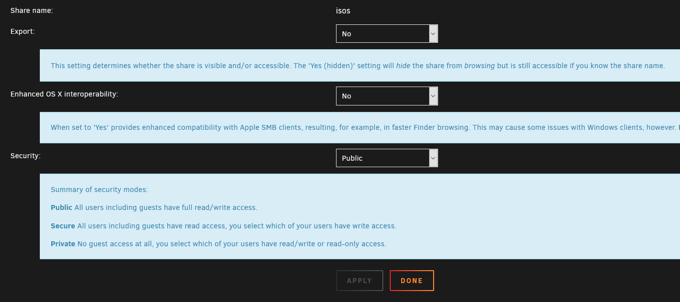

Got to that share'a SMB security settings and check that "Export" is set to "yes"
4 hours ago, Bytales said:
What the hell am i doing wrong,
Enabling Help on the ISO share's config page tells you what is going on.
By default, the ISO share's SMB Export setting is set to No.  This means that even if you know the share name, you cannot map it (this is what is happening in your case).  If you set it to Yes (hidden), it will not show up automatically when you browse to the server in the Windows Network, but, you can map it since you know the share name.  If you set it to Yes, the ISO share will show up automatically when you browse to the server
As johnnie.black said, you need to set it to one of the "yes" options.

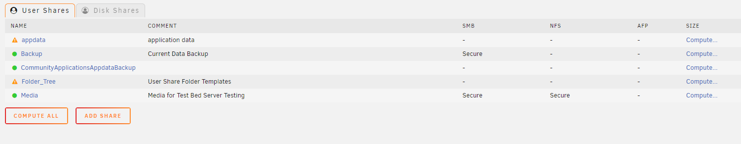

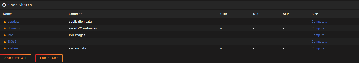

I have followed these instructions and I still am having issues connecting to the share via Network explorer in win 10. Iv previously been able to connect to SMB shares on a FREENAS 11.2 server. Any ideas? I also noticed in the shares section under the SMB column there is simply a dash "-". Refer to image.

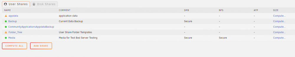

It will look something like this when you have things correctly set up:
In this case, I am exporting two shares (Backup and Media) via SMB and both of the shares have the security set to Secure (which means anyone can read but only specific users have write privileges).  One of these shares (Media) is also being exported using NFS.

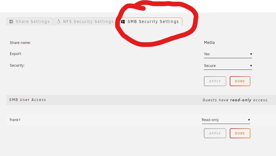

This is the setup screen for the SMB share of the Media share:
(I have all of my shares setup so that Ransomware can't not have read/write access to the share!!!)
You also have to turn on SMB---       Settings  >>>   SMB   >>>  SMB Settings

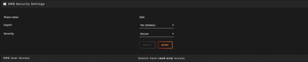

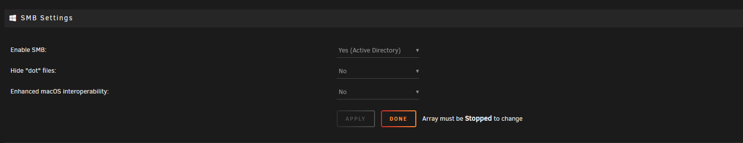

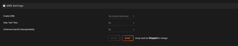

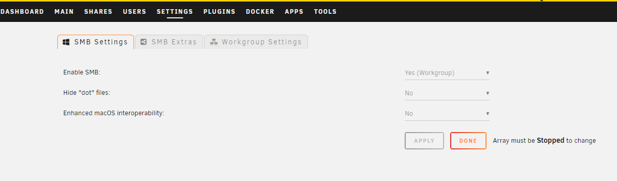

I have already completed both of these tasks before asking for assistance. this is the reason why i am stuck. Screen cap to show the settings
Edited by QAZT
Im a dummy
Sooo.... Reason it didnt work. I had not changed SMB SETTING "Yes" to workgroup. I had it set as an active directory and that wouldnt work...
As I understand it, Unraid has some Active Directory functionality built into it but it can not serve as a Domain Server.  You have to have a server that is running one of MS Windows Server Operating Systems set up to serve as the Domain Server.  Then you can have your Unraid server join to it.  See here for some more information on this:
