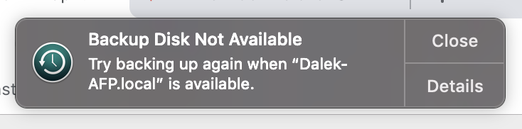

I have Time Machine set up and have configured as i've read in a couple of other topics but it's really never been very reliable.  I've just opened Time Machine, told it to start a backup and it looks for the disk and then comes back with the following error:
Is anyone able to help me troubleshoot it and make it locate the drive automatically and backup more consistently. Currently TM can't even locate the drive.

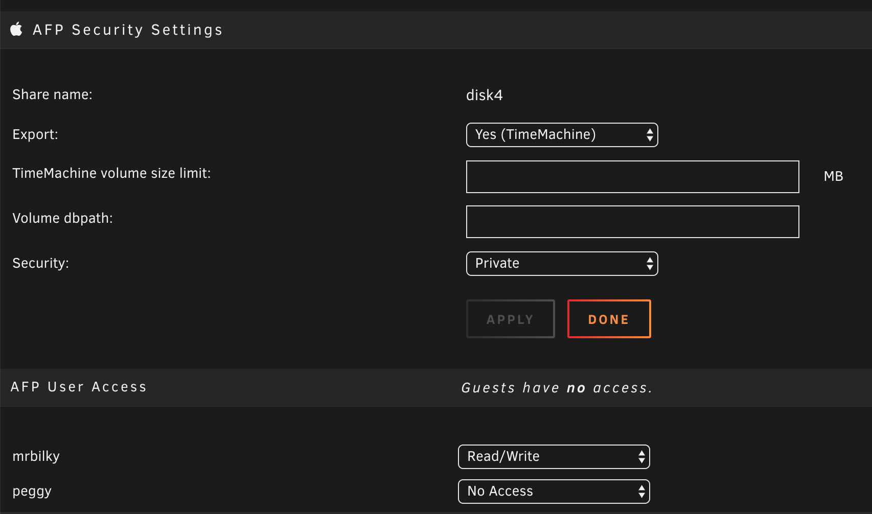

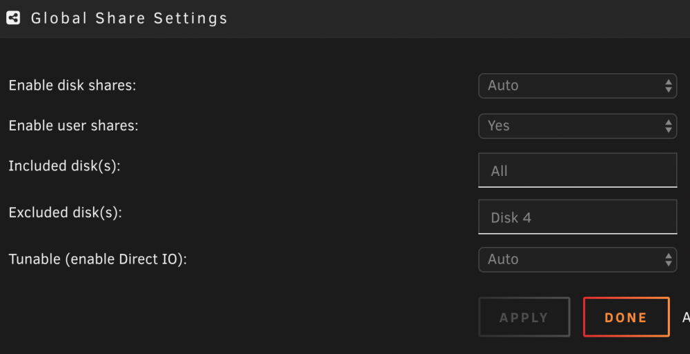

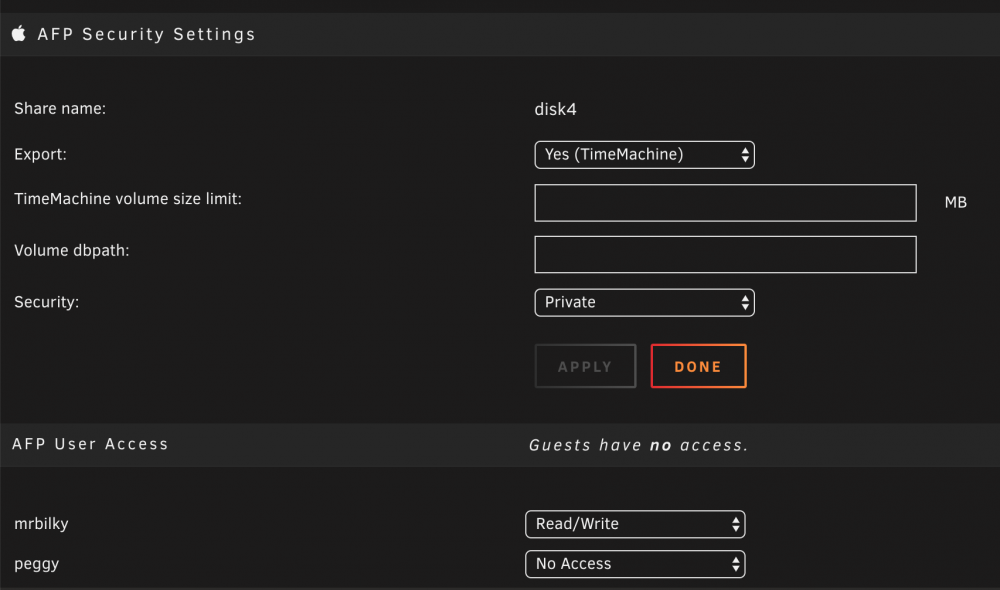

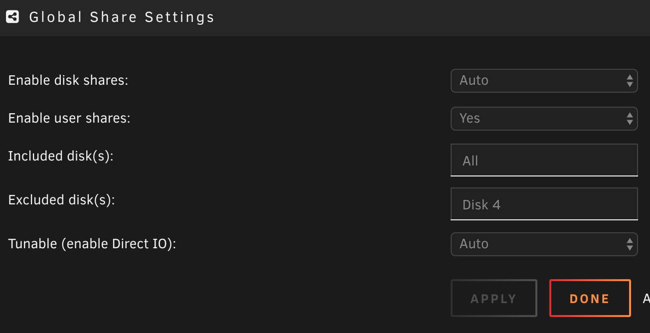

Mine is working fine before and after Mojave update are you using a disk share that is how i'm setup also I excluded disk 4 under global share settings and have enabled disk share set to auto
