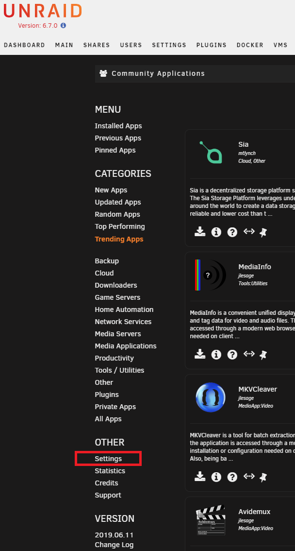

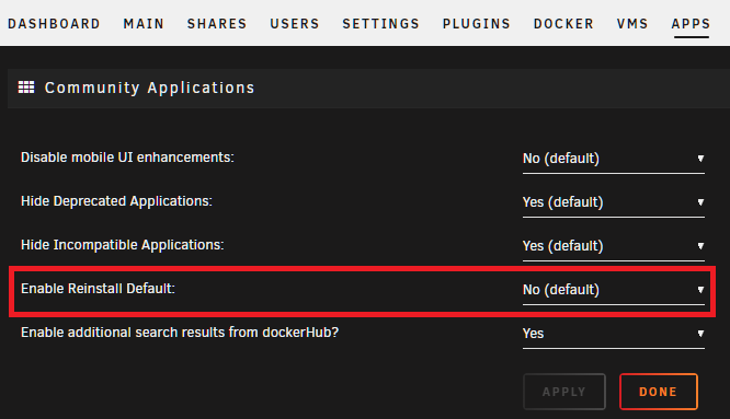

For those that stumble over the problem, this is how to re-enable the ability to create a duplicate docker container.
Setting to re-enable reinstall default can be found on the settings of the CA page, change Enable Reinstall Default: setting from No (default) to Yes

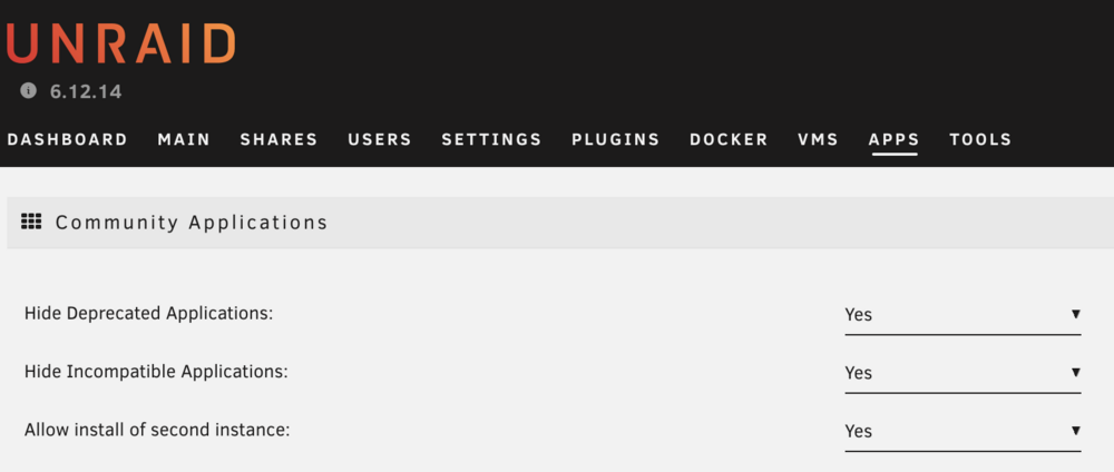

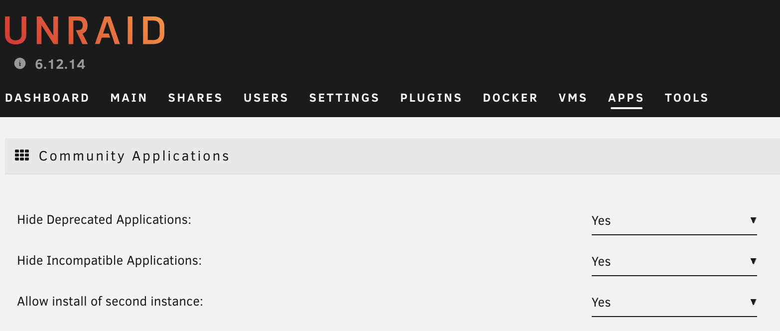

Small update, now it is called "Allow install of second instance", still in Apps / Settings menu.
