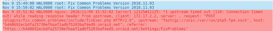

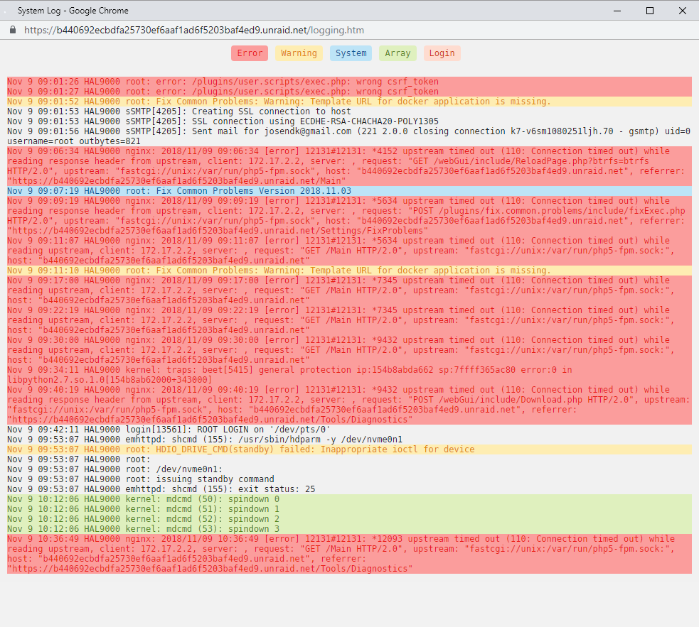

Got home to this log:

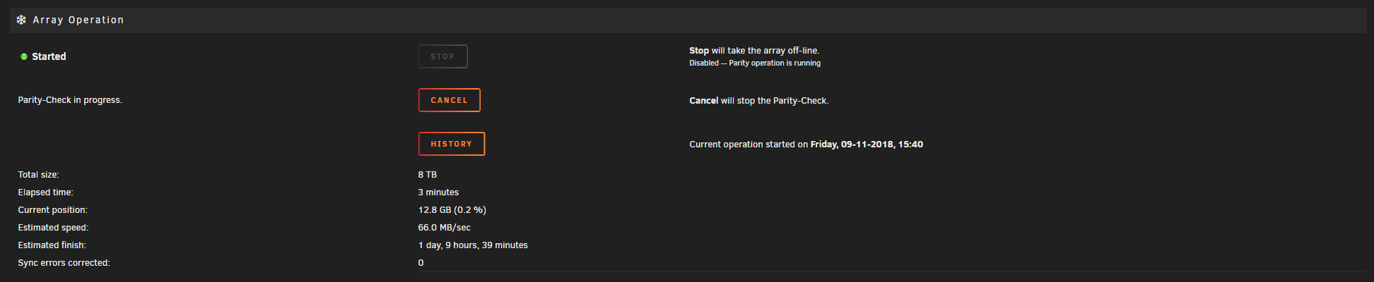

It started, parity check runs and dockers started too. I am looking at this now:

Edit: Not sure I can do that though, the "Scanning" when I enter the page seems to stay there forever. This is in the log:
Edited by JohanSF
I'd like to know exactly what the nginx errors you're seeing are about, as I've seen them myself on occasion but I've never seen an explanation for them. The Web GUI pages are really quite complicated and for nginx to serve one up it has to retrieve the sources from multiple locations, most of which are dynamic and dependent on scripts completing and returning the necessary code. That looks as though it's failing here and causing the unresponsiveness.
Can I restart the plugin? I don't want to restart the whole server now that the parity check is running.

Except for the nginx errors, which I also don't know what they mean, though I see them frequently, all appears good, cache is fine.
That is good news, do you have any idea what do to about them? do I have to restart?
