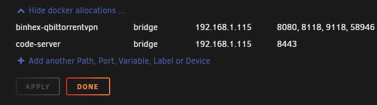

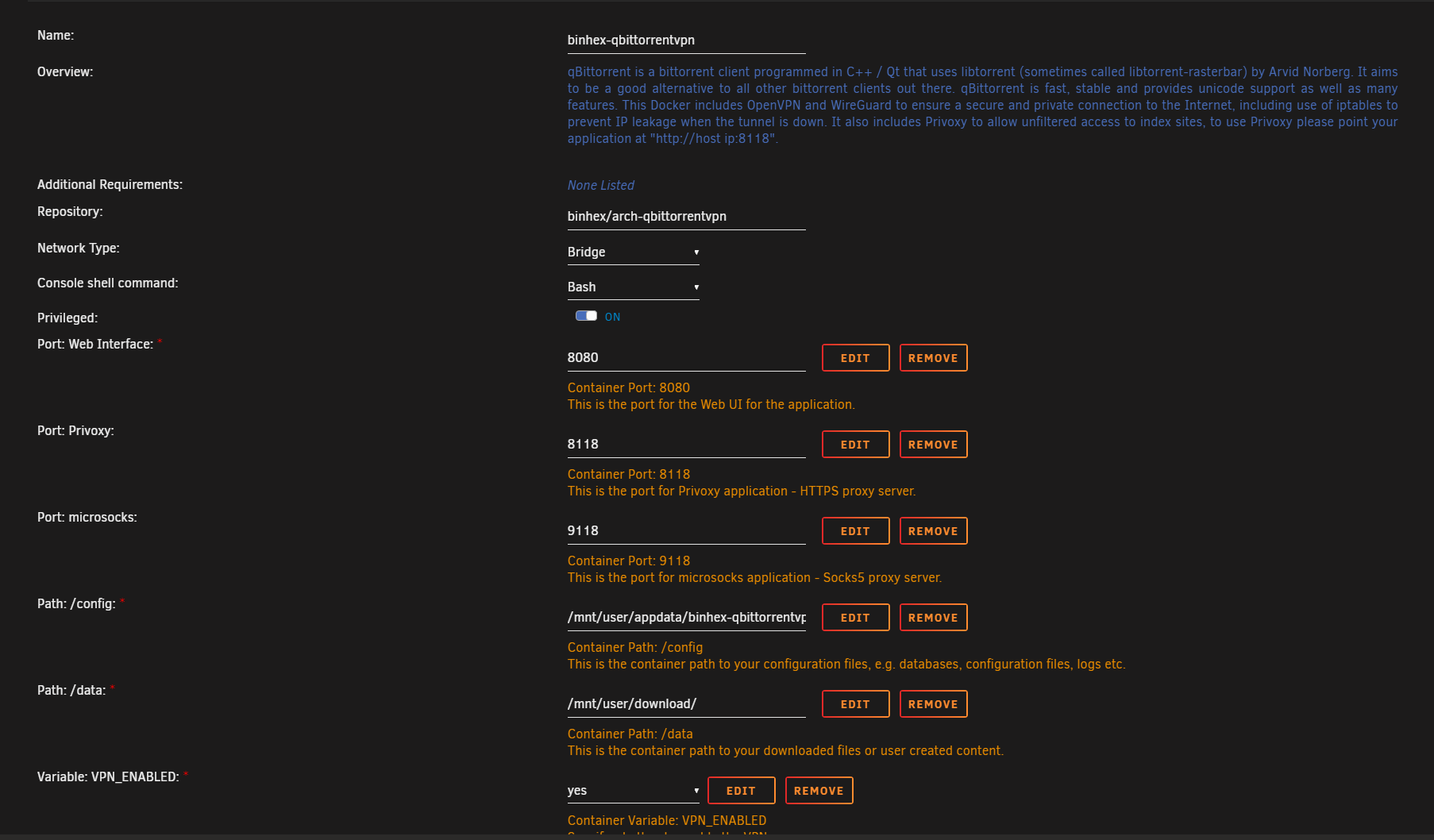

Beginner and now building a unraid server (ver. 6-12-10). Following Riffsphere home assistant utube video and got stuck. The appdata config path selection does not show on my edit page and I have this error page.
I believe the problem lies with this missing path.
Issue is the 'AppData Config Path' as well as the drop down across from it are missing.
What am I missing? Mahalo for your patience.

Ok so update container page, but where? Path: /shared: ?
Please click the show more settings and then post a screenshot of the bottom section of the page.
what it is;
What it should be;
hope this helps.
page bottom;
Sorry, I wasn't clear. I meant show more setting near the bottom of the docker config page.
It may be that with recent changes to unraid cache pools that default has been removed from new templates. Try adding it manually by selecting the Add another path link and enter these settings.
And then Apply.
You the man my friend! Started right up. Now on to configuration. Glory to Ukraine! Glory to the Heroes! Give em Hell!

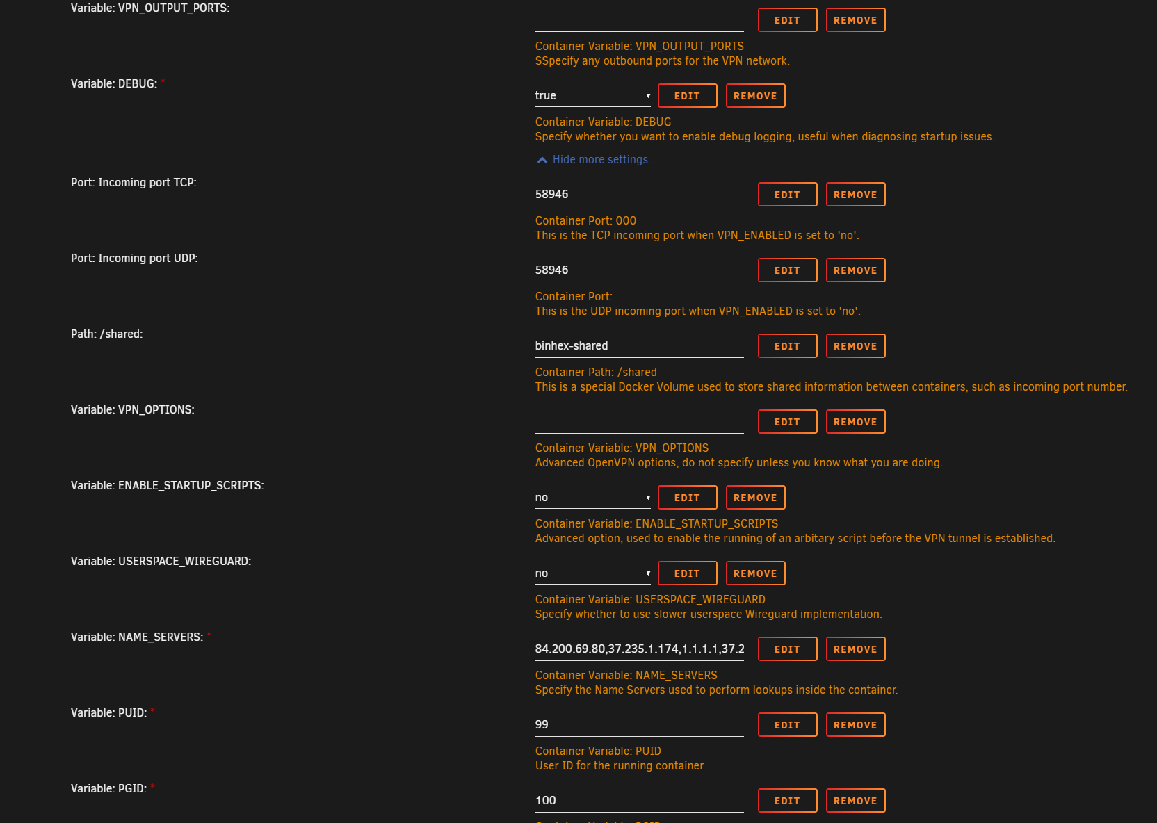

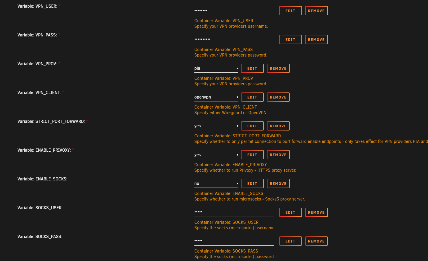

Followed setup instructions what i thought was perfectly.
I use PIA already so just put the us Atlanta .opvn file in the config folder along with certificate and .pem file
container starts, but the gui never loads no matter what browser or device that i use.
When i look at the log after starting, it seems to be missing alot of info

[info] Script finished to assign incoming portimage.thumb.png.7defc56847d5ef6f51ebb041dd537432.pngimage.thumb.png.c98174a9667625273f5f5e0e097bde35.pngimage.thumb.png.d7506d1d2fc49b33e366104b0ee90573.pngimage.png.1a705b81fe7966346ccdd450e31fdb85.pngimage.thumb.png.be50a4b44418a49a42516b5264e34bd6.png
supervisord.log
Edited by clydeshelton
This is probably your issue-
info] PIA endpoint 'us-atlanta.privacy.network' is NOT in the list of endpoints that support port forwarding shown below:-
You have strict port forwarding set to “Yes” so you’ll need to choose an endpoint that supports it from the list.
im a literal idiot. ive been dealing with this for 17 hours and your response legit was a 10 second fix and now it works.
THANK YOU!
