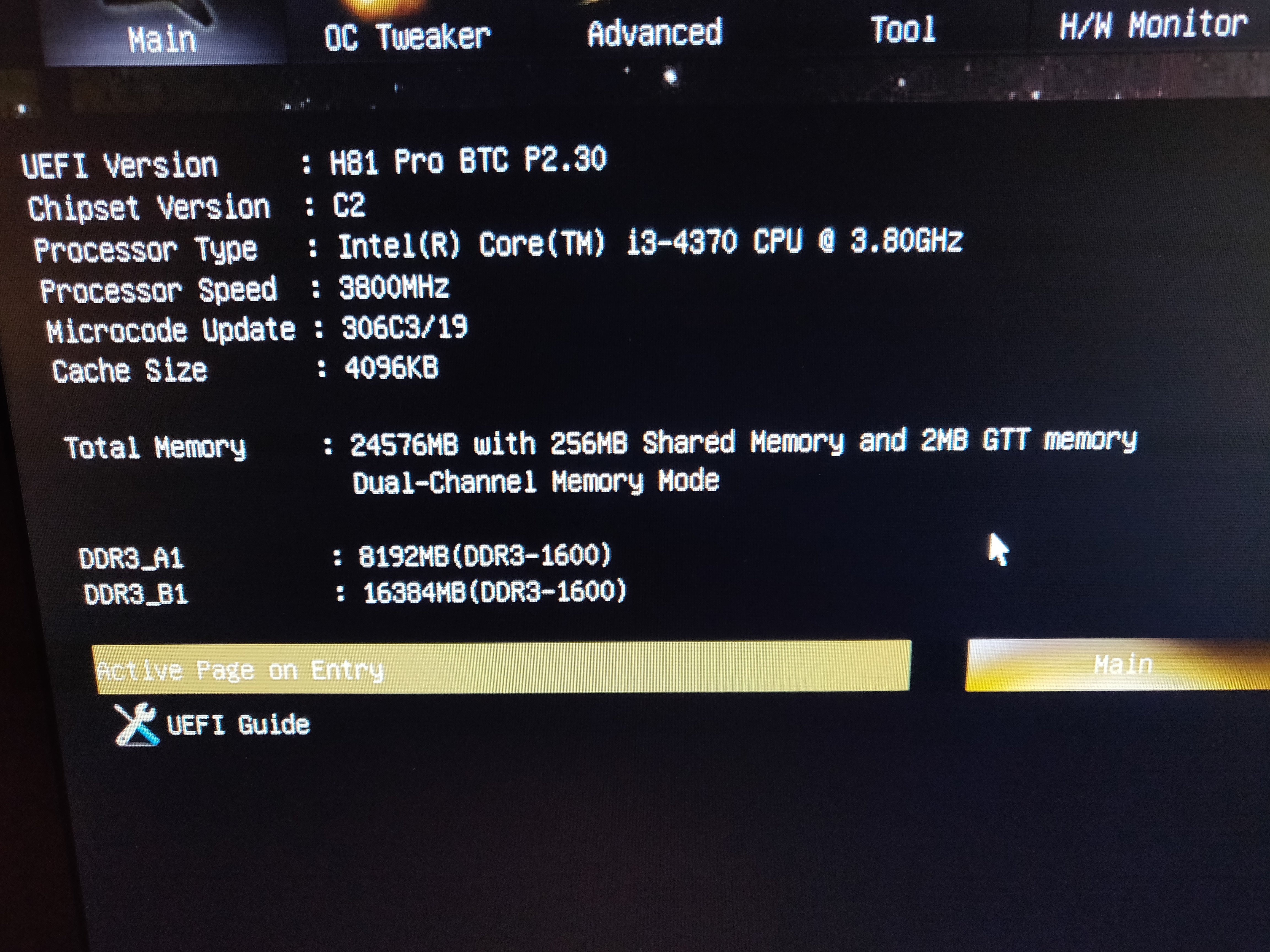

Upgraded RAM, Bios shows 24gb, unraid 8
i had 2 8GB ram installed, 16 total.
Now i ordered 2x 16GB to upgrade it to 32GB.
If i install only one 16GB Server wont start (restart, restart, start no screen and after some time shutoff)
If i install 2 16GB Server wont start (restart, restart, start no screen and after some time shutoff)
If i install in slot a 8 GB and in slot b 16gb server will start normal and bios shows 8gb in a and 16gb in b.
But unraid only shows 8gb, do i need to do anything to get it working inside unraid, or is it just incompatibity?
I thought, if it shows in bios, it should work?!
(my mb officially only support max 16gb in both slots, but ive read that sometimes more can also work)
Do i need to reset anything in unraid to make a ram upgrade working?

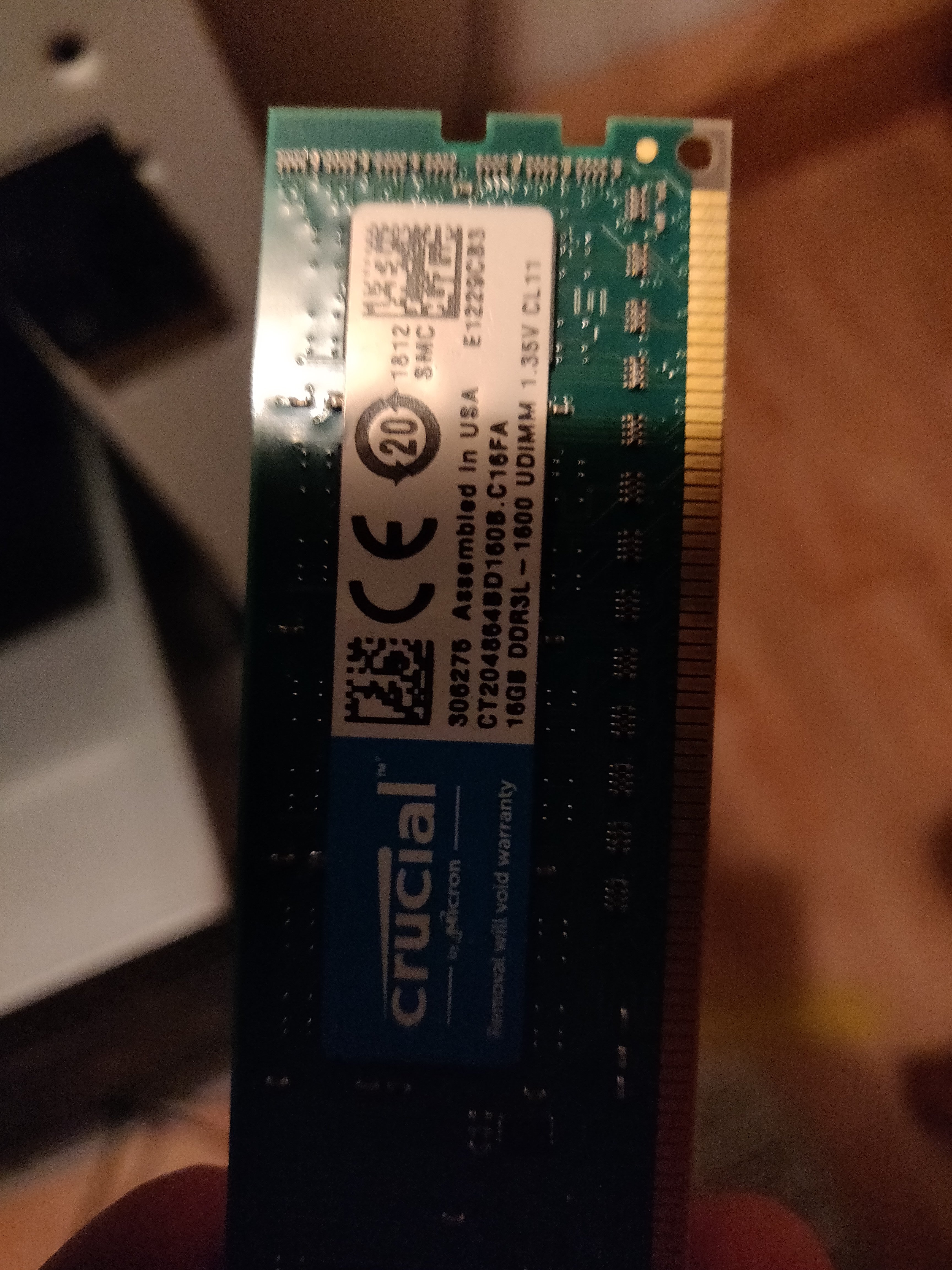

2x Crucial CT204864BD160B 16GB Speicher (DDR3L, 1600 MT/s, PC3L-12800,
Old RAM is:
2x PV316G160c9kbl
The question is why bios shows both sticks, but unraid dont...
(Memory sizetotal usable7.661 GB
installed8 GB
max. installable capacity 16 GB)
Edited by nuhll

In bios it shows
Stick a: 8GB 1600
Stick b: 16GB 1600 with correct manufacturer.
Total: 24gb.
That statement right there is the telling factor.
Doesn't matter what the BIOS shows as installed, only the 8GB stick is available for use. Period.

16GB DDR3 are rather uncommon, except ECC registered DIMMs, and likely unsupported, H81 boards only support 2 x 8GB max.

Just now, nuhll said:
My only question was if its normal that bios shows its working, unraid not.
It can't work in Unraid or any other OS since it's not supported by the board.
So boards can show ram, even its not working?
Yes, it's a bios bug

Did you try just using that DIMM on its won, does Unraid recognize 16GB?
Like i wrote, it wont start with only 1 stick or 2 new sticks.
Only with 1 old and one new stick...
