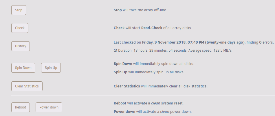

No, just normal assign data disk as array member. If no parity disk in array, then array "check" will read all disk in same time instead of parity check / correct. Those are read check only, nothing about file system, the purpose was verify system stable or not.

No, just normal assign those disk as array member. If no parity disk in array, then array "check" will read all disk in same time instead of parity check / correct.
Oh. OK. That system does have a parity. So, will that make a difference?
