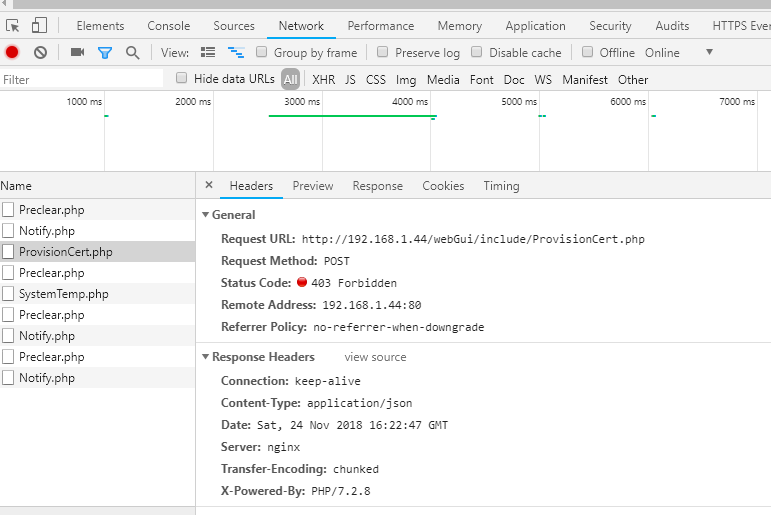

I am attempting to provision a certificate to get HTTPS running on my unraid 6.6.5 server. When I click the button labelled 'PROVISION' it just hangs and does not display a message. Looking at the network communication using Chrome's dev tools shows that after about a second a 403 Forbidden response is returned:
Does anyone have an idea as to what the issue might be?

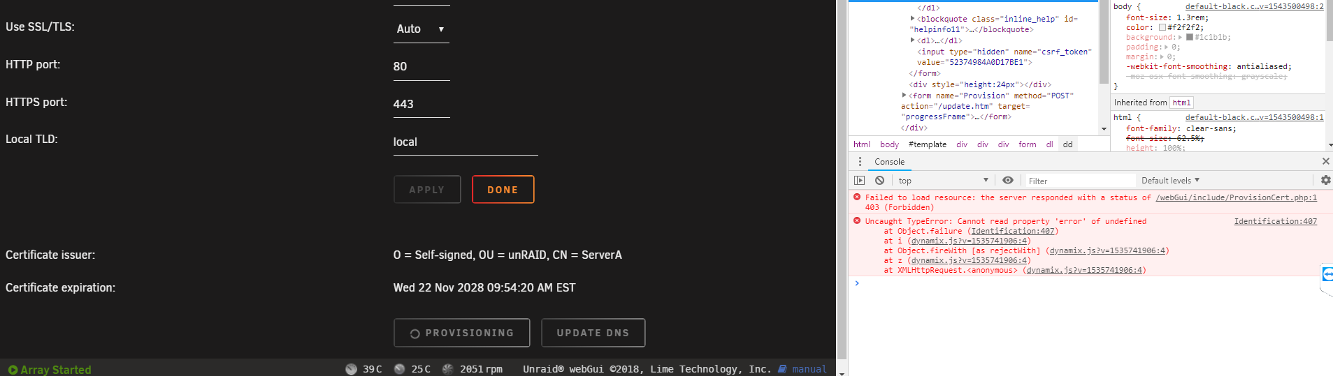

It's not the other end.  This is an actual bug.  You can't even Renew a Cert under 6.6.5, and the 403 error refers to the local file, not a remote url.

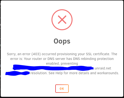

Ok, on my end, I do get a 403 error, but I get an error message in the webGui as well
Gonna try on another system where dns rebind isn't an issue.

Ok, definitely recreated this issue in the lab now so we will work to get it resolved.  Thanks to those who reported!
This issue should be fixed now.  Please retest.
It's working for me now. I retried it and got a dns-rebind error message, then after disabling a setting on my router I was able to successfully provision an SSL certificate. Thanks for getting it fixed @jonp!
