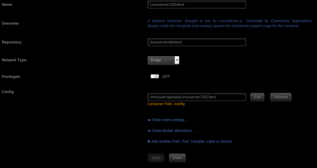

Help with Linuxserver.io's DDClient
Has someone has tried and gotten this to work with CloudFlare?
https://hub.docker.com/r/linuxserver/ddclient/
599631916_Screenshot2018-11-3015_51_02.thumb.png.05a679ba22b96d8f83a276020852fb42.png
I'm getting these errors:

Edited by vurt
You need to set the PUID and PGID. Will most likely fix your issue.
I'll make a template for it this weekend.
