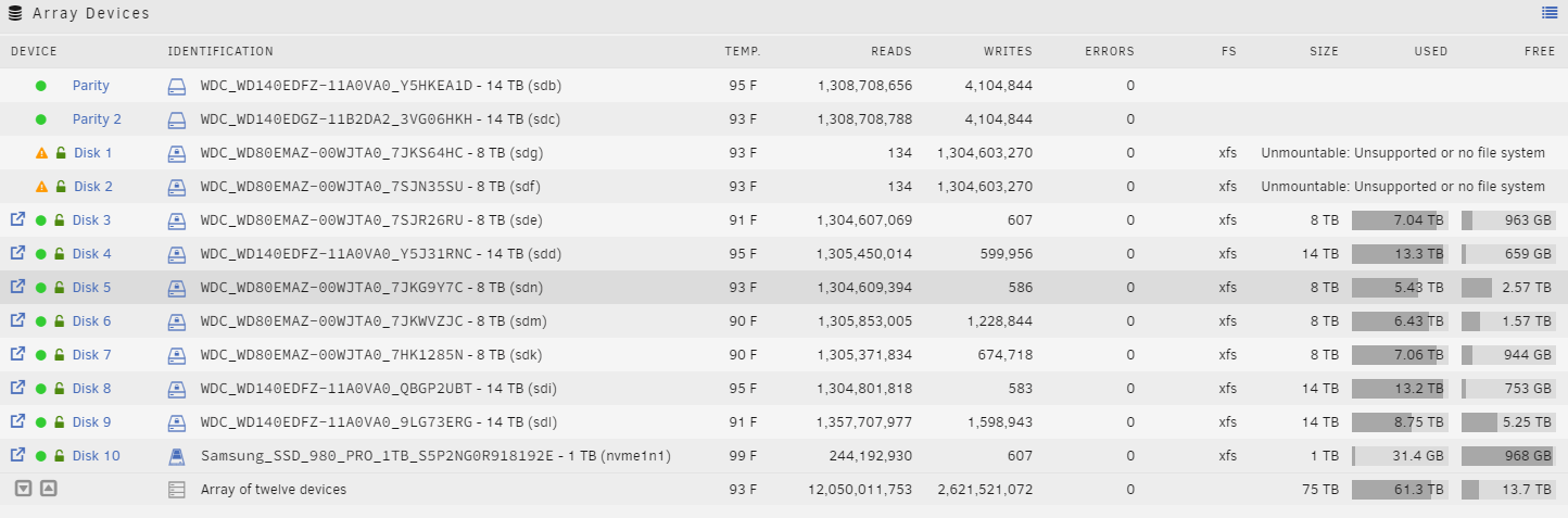

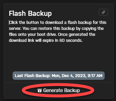

  2. Thanks @JorgeB! The rebuild is still running but I'm guessing you are right and the unmountable drive won't be mountable. Here are the diagnostic files from my server. Please let me know if you spot anything or if there is anything else I should try. Thanks!! tower-diagnostics-20231209-0938.zip
  3. Ok, I think things are okay....with a HUGE thanks to Unraid for the new Unraid connect service 🙂 If you have been saving Flash Drive backups In Unraid Connect, this is where you download the most recent backup: It makes sense, but it might be easier if it said something like download/generate backup. Or maybe it was just because I was in a panic. Once the backup was downloaded, I copied it over the new Flash Drive that I was going to use. Next, I booted my Unraid server using the new flash drive. I then signed into Unraid connect and it gave me this option: Long story short, I am SO glad that Unraid Connect is an option and that I had set up my server to use it. Two of the drives were unmountable, but they are now being rebuilt. My hope is I don't lose any data, but I'll know more in the morning. Thanks to everyone!

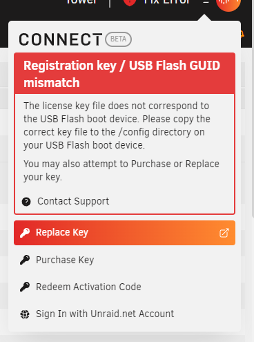

  4. Please help. I had to replace the power supply in my Unraid server. When I did that, I accidentally put the PC case on its back, which bent/broke the USB flash drive that was plugged into the back of the motherboard. I tried to boot off of the broken drive but the computer does not recognize it being plugged in. I downloaded the USB Flash Creator and created a new flash drive using Unraid 6.12.5 (the version I was running on my server). It installed okay, but I can't find any way to restore my Flash Drive backup from Unraid Connect. I do have local backups of the Flash Drive but they are stored on the Unraid array (I realize now that was a bad idea). I have 10 data drives and 2 parity drives in this system, as well as 3 SSDs that I use for the cache drive and as unassigned devices. The array was encrypted with a password/key. I apologize but I’m really freaking out about what to do to fix this. I have been using Unraid since 2014 and this is the first time I’ve been scared that I will lose all my data and my configuration. Is there any hope? Can someone at Unraid send me a copy of the Flash Drive backup from Unraid Connect? Or a Pro.key file for a new flash drive? Or what should I do?? Thank you for any help that you may be able to offer. Scott

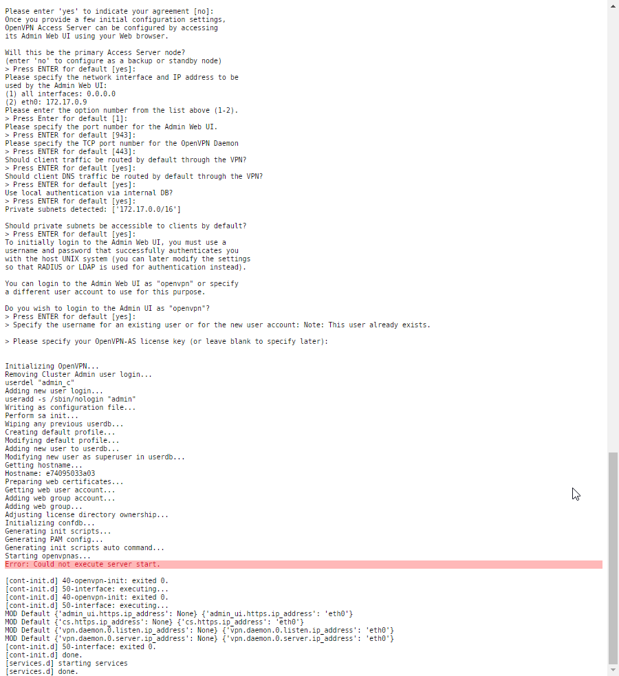

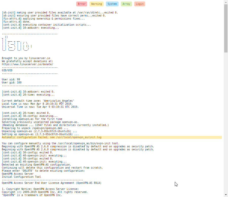

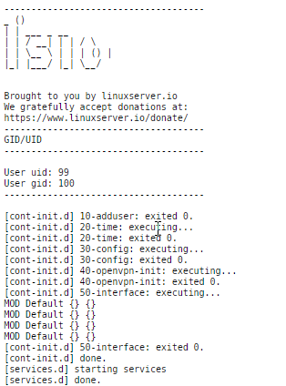

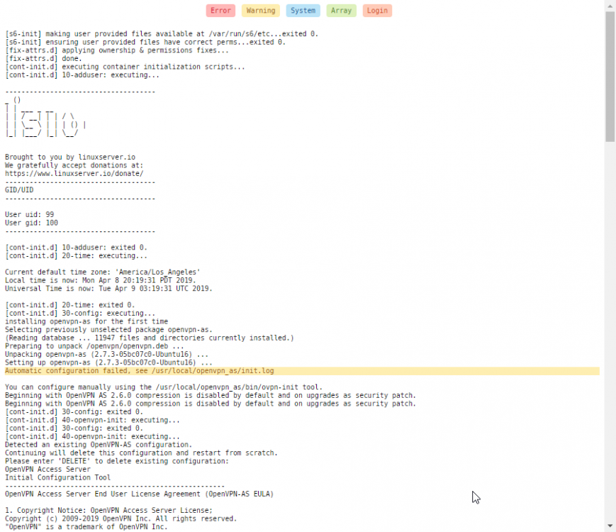

  9. I was also having problems getting openvpn-as back up and going. Tonight I made sure everything was completely deleted and the I download the linuxserver version using the Apps tab. This way it wouldn't be using any of the settings that I might have in my personal dockers (I don't know if this part really mattered though). After I first ran the docker I saw these errors in my log file: ... But after that the web UI was working again. I stopped and started the docker and everything seemed to come back fixed: The last part I had difficulty with was figuring out where I could download the connection profile. I finally found that if I changed "https://###.###.###.###:943/admin/" to be "https://###.###.###.###:943/?src=connect", I was able to download what I needed. I'm sure there is an easier way but this did seem to work. Everything seems to be back in order! Sorry for such a long post, but I thought it might be helpful to see what I saw.

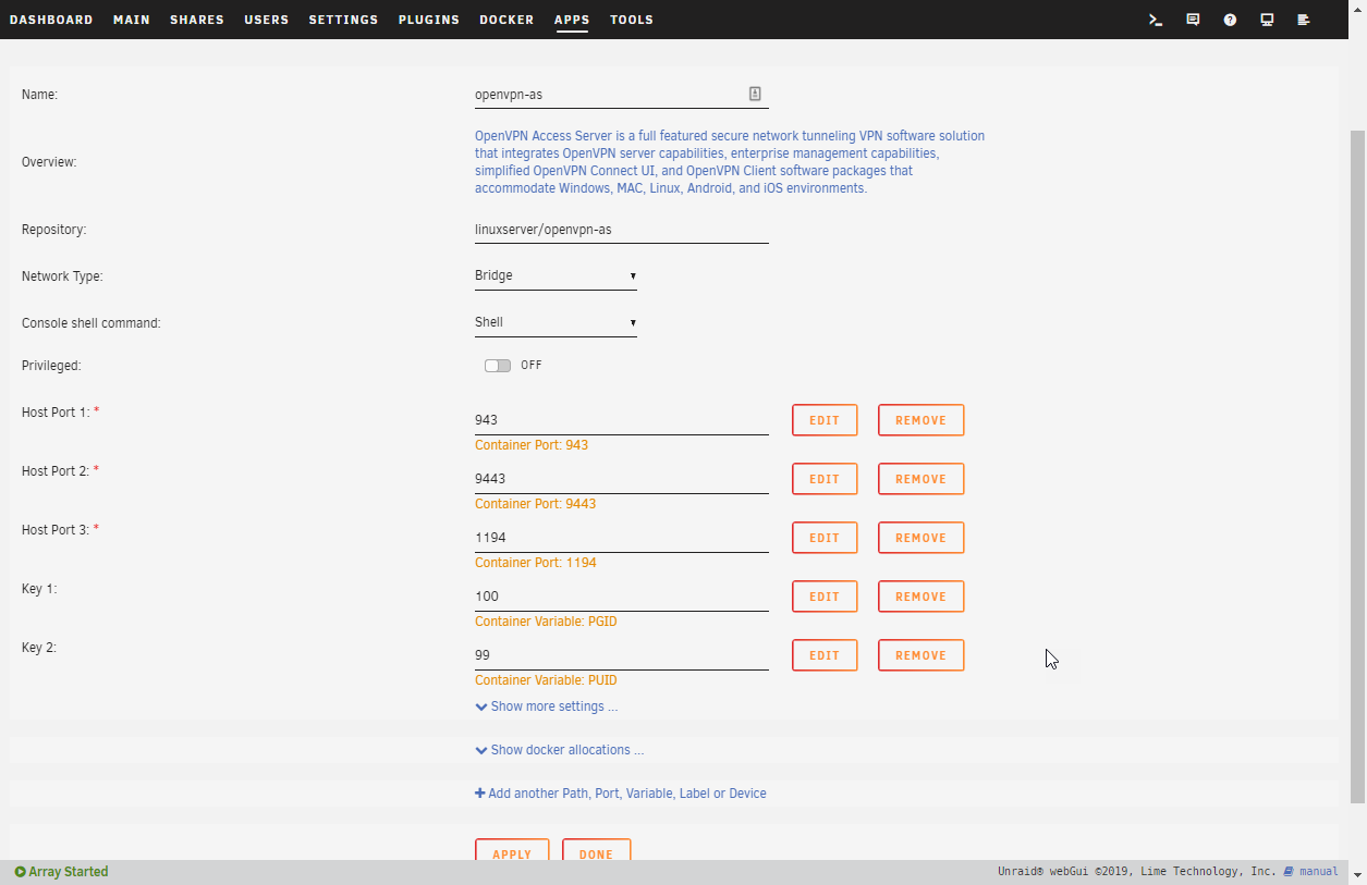

  11. Thanks! This solved my problems. I left the INTERFACE variable alone (it was set to eth0 anyway) and changed the network type from Host to Bridge , saved the changes and openvpn-as started working perfectly again 🙂
