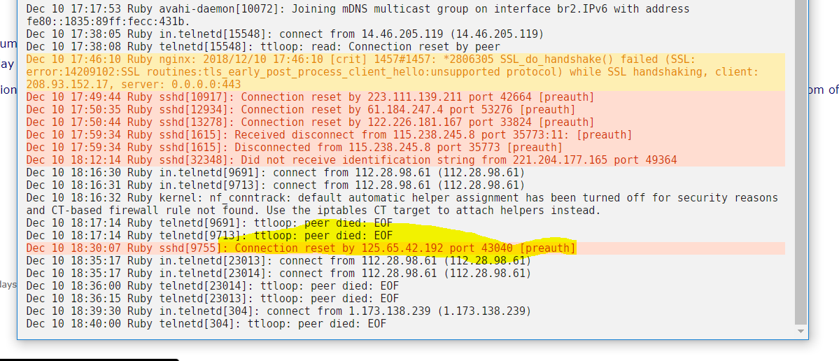

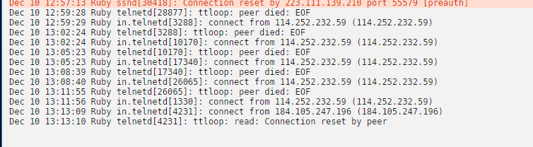

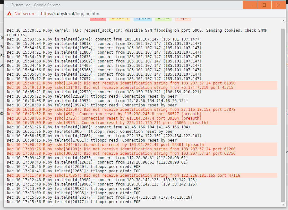

I happen to look in the unraid log. I found that someone from china is trying to telnet into my server?

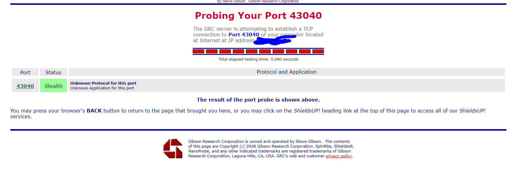

When I check ismyportopen.com I show all ports in the log are showing as closed. so not sure.
Are you still getting telnet attempts?
I sure am! last one was like ten seconds ago.
Right now its 17:16 for time
Such requests should not be reaching your server if it is behind a router!   You have not by any chance put the server into a DMZ zone on the router (as that means your are bypassing the routers protection against incoming connections from the internet)’/

You are also getting ssh connection attempts.  This usually only happens if you have open ports or have your server in the DMZ.

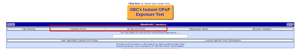

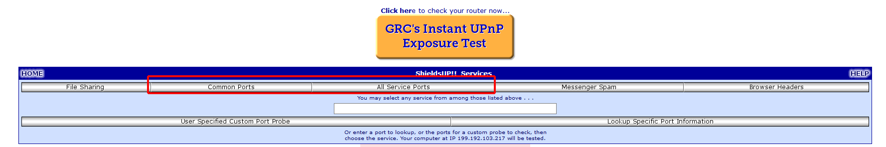

Go to this site and click the Proceed button after doing a little reading.  Then run the Common Ports and All Service Ports scans to see what is reported regarding port security.

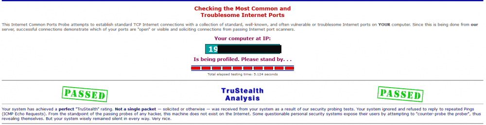

You want to see results like the following:

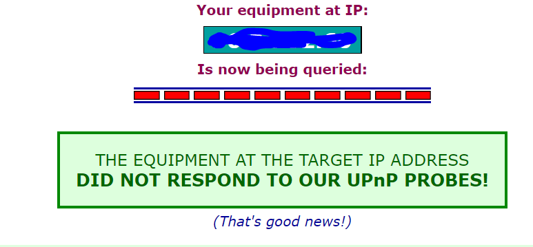

I ran it.
I ran the 2 test you recommended and both came back success.

I ran it.

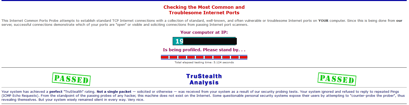

You ran the UPnP probe.  Did you also run the Port scans (highlighted in red)?  The results should look like what I originally posted.
Sure did and came back passed.
Sent from my Pixel 2 XL using Tapatalk
OK, just making sure.  If your router passed the port scans it is very strange that you are getting ssh and telnet connection attempts.  Somehow, your server is exposed.

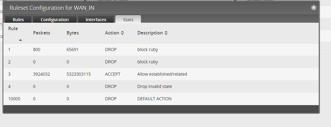

Trying to use a wan_in rule to block all ports till i can hear from manf. I show lots being blocked!
