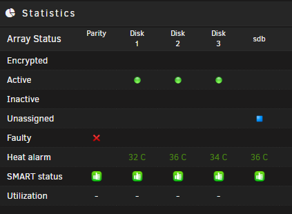

Hello all. Just logged onto the server tonight to get some configuration files and met this:

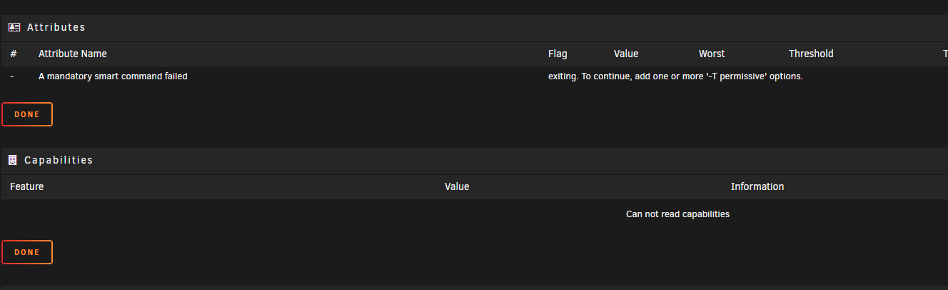

I tried to see what the problem was with it but SMART shows:
Attached diagnostics. Is this drive completely dead? I'm about to go somewhere on vacation and would like to refrain from ordering any drives, as they will arrive after I'm gone. Thoughts?

Parity dropped offline:
Dec 10 06:24:36 derrickserver kernel: ata4.00: disabled
Most likely because of a bad SATA cable:
Dec 10 05:53:41 derrickserver kernel: ata4: SError: { UnrecovData 10B8B BadCRC }
Replace the SATA cable and post new diags.

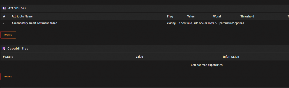

I think the drive is done for, because now it shows some basic drive information, but doesn't give me any attributes. When I try to start a SMART test it immediately stops, with no result.
SMART attached. RMA drive after vacation?derrickserver-smart-20181211-2051.zip
No, you just need to enable SMART:
SMART Disabled. Use option -s with argument 'on' to enable it
You were right, enabled SMART and running a self-test.

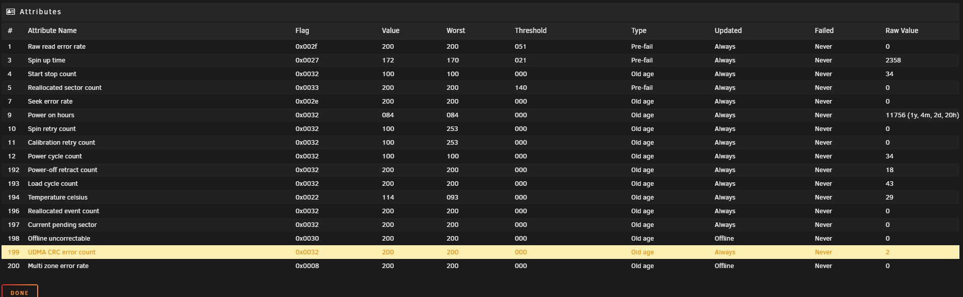

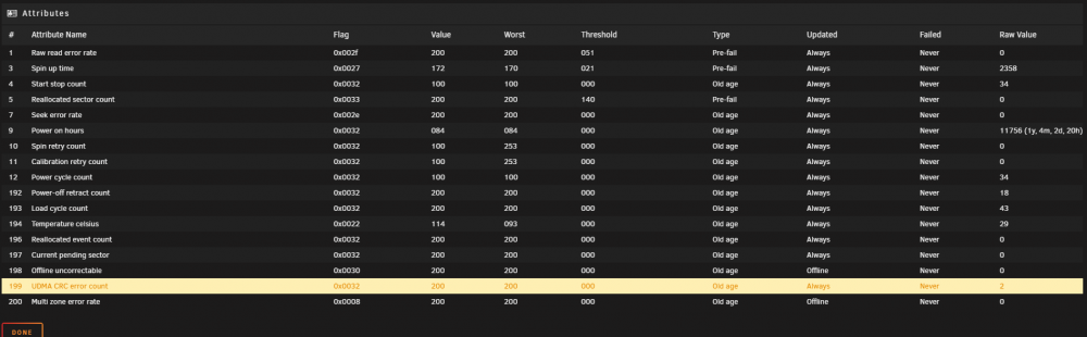

SMART attributes don't look that bad, but I'll leave it to you experts because I'm probably getting my hopes up too soon.
Attached SMART report in full. Currently running a short self-test to see if the CRC errors will go away.
EDIT: Finished short self-test without error, but the UDMA CRC errors are still there. I'm really out of time, so is there a way to green ball this device if the SMART looks good?
I haven't been able to find a spare SATA cable, will probably have to pick some up over vacation. Is this drive good to go? How do I reenable it if it is?
derrickserver-smart-20181211-2116.zip

Just now, johnnie.black said:
SMART looks perfect, except for the CRC errors but that's not a disk problem, replace the SATA cable and re-sync parity.
https://wiki.unraid.net/Troubleshooting#Re-enable_the_drive
