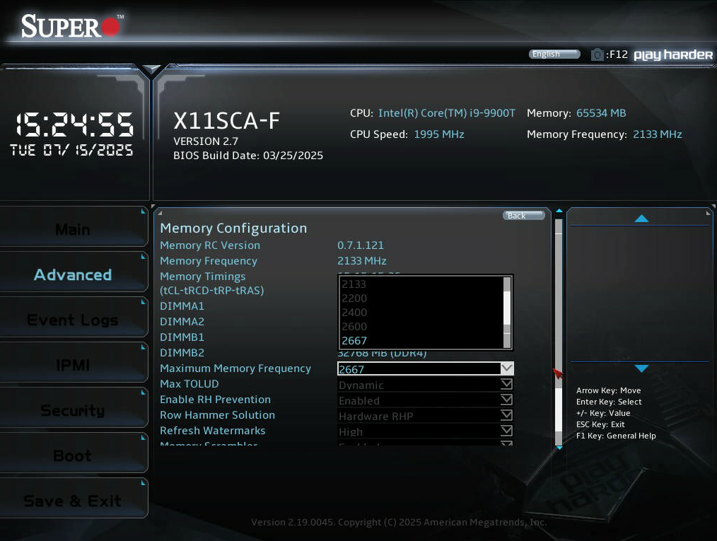

Just picked up this board from ebay and currently setting it up for UNRAID.
Does anyone know how to manually set my 2 x DDR4 Corsair LPX modules to 2933 or 3200mhz?
All I see is the memory freq option and a max speed of 2667mhz, cant see any other OC options for the memory.
On 7/15/2025 at 4:26 PM, mikeyosm said:
Just picked…
That’s because the motherboard doesn’t support higher memory clock speed than 2667 MHz so it will down clock any RAM capable of higher speeds. https://www.supermicro.com/en/products/motherboard/x11sca-f
Maybe this is hackable somehow, but unlikely.
