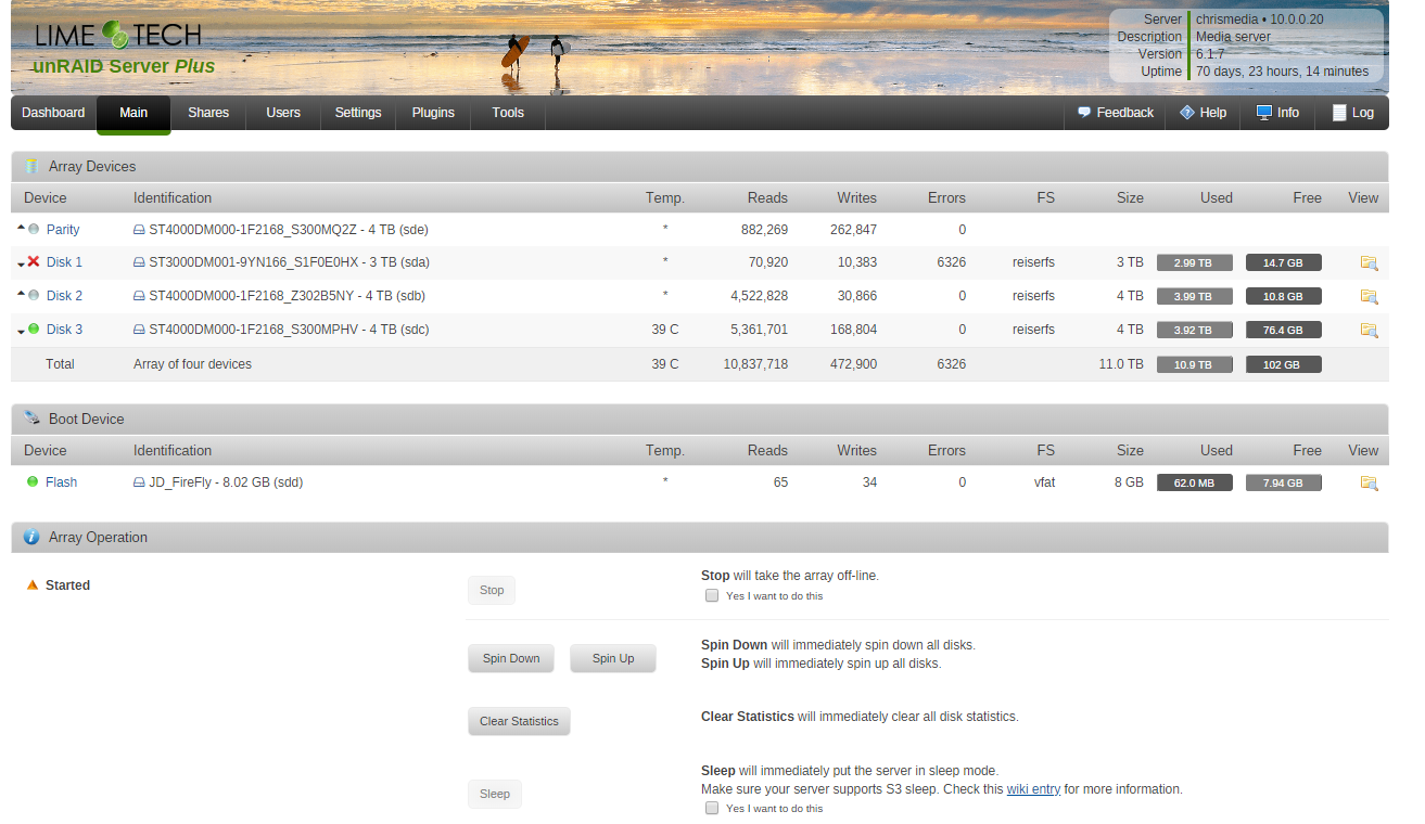

here is an older screen grab from back on 6.1.7 when i saw 6326 errors against this now automatically disabled disk.
Don't know why the first diags was showing parity invalid. Don't know which diagnostics to trust. I guess if we can hope parity is valid then  parity swap as johnnie said in the 2nd post.

3 hours ago, crizz11 said:
Probably should run file system checks in diagnostic mode and see if we can get the filesystem back first, unless the file system is unmountable because the auto option broke and needs to be manually set to ReiserFS.
In any case, the next thing that needs to happen with this array after the disks are all healthy is a migration off ReiserFS. Performance has got to be pretty miserable with those large drives that full, and it's not going to get much better with 10TB disks.
what file system should i go with?
also with that failed disk being emulated, I can access all my files no problems.  This is why i thought adding a 10tb as parity 2 would work fine.
