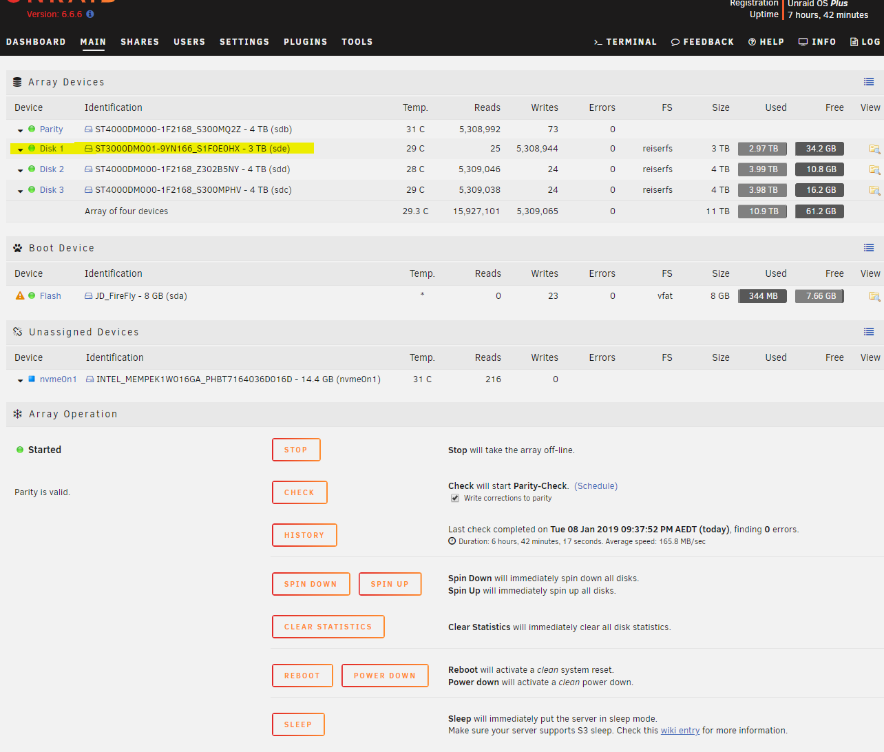

Looks like disk1 has rebuilt successfully

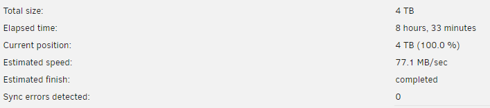

Before moving to the next major step, I suggest a non-correcting parity check, after that completes with 0 error, collect and post diagnostics. We need to be very sure the array is truly healthy.
ok thanks, i have kicked that off

very strange i was watching as the rebuild was in it's final moments and 100% did not reboot after it finished.  Also on top right of page it says my uptime is 10 hours now, would suggest i haven't rebooted?
On the Dashboard page that disk 1 that i rebuilt has 1 smart warning "UDMA CRC error count: 3931
On Main Tab it is all zeros in the errors column.
