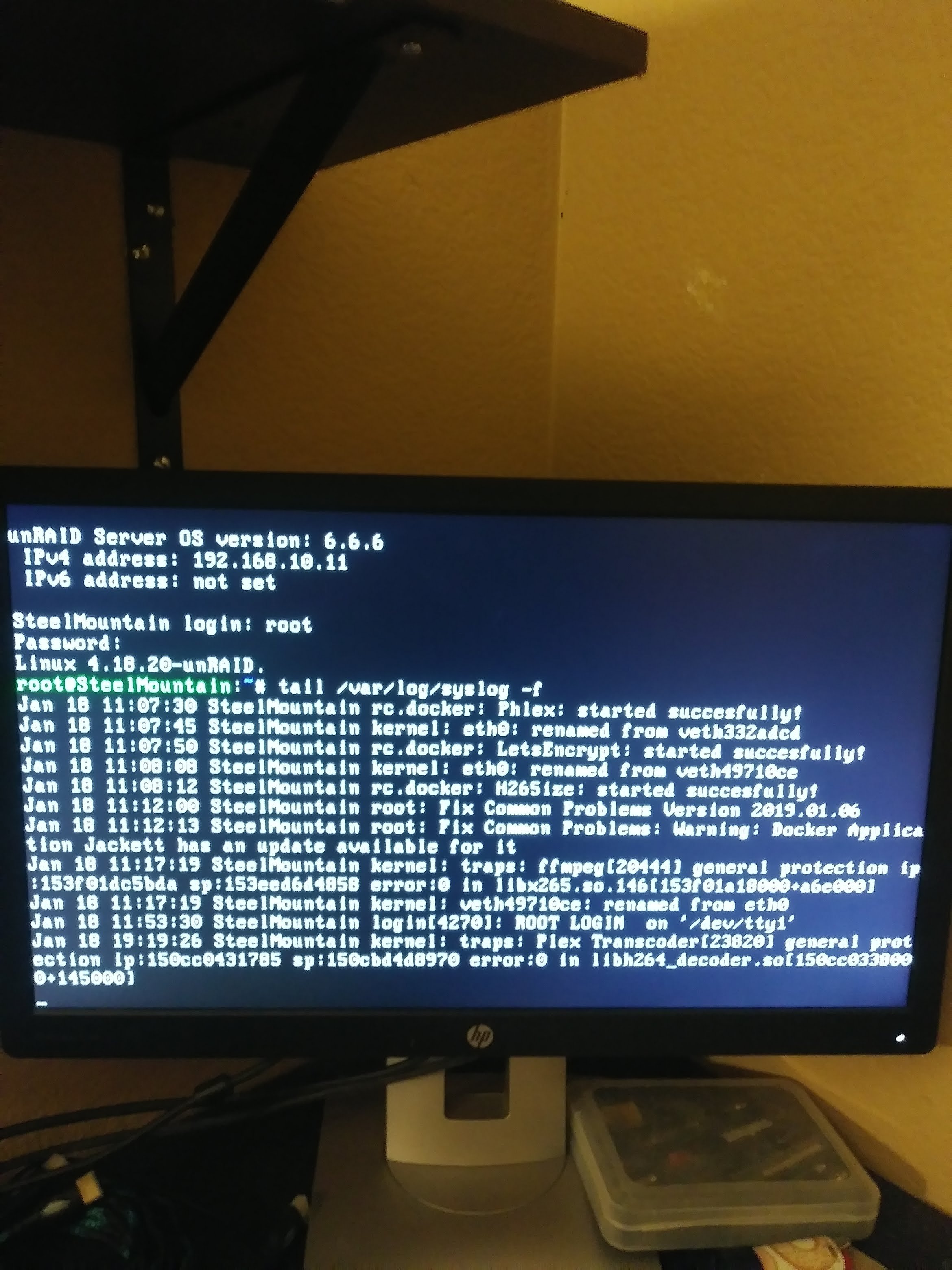

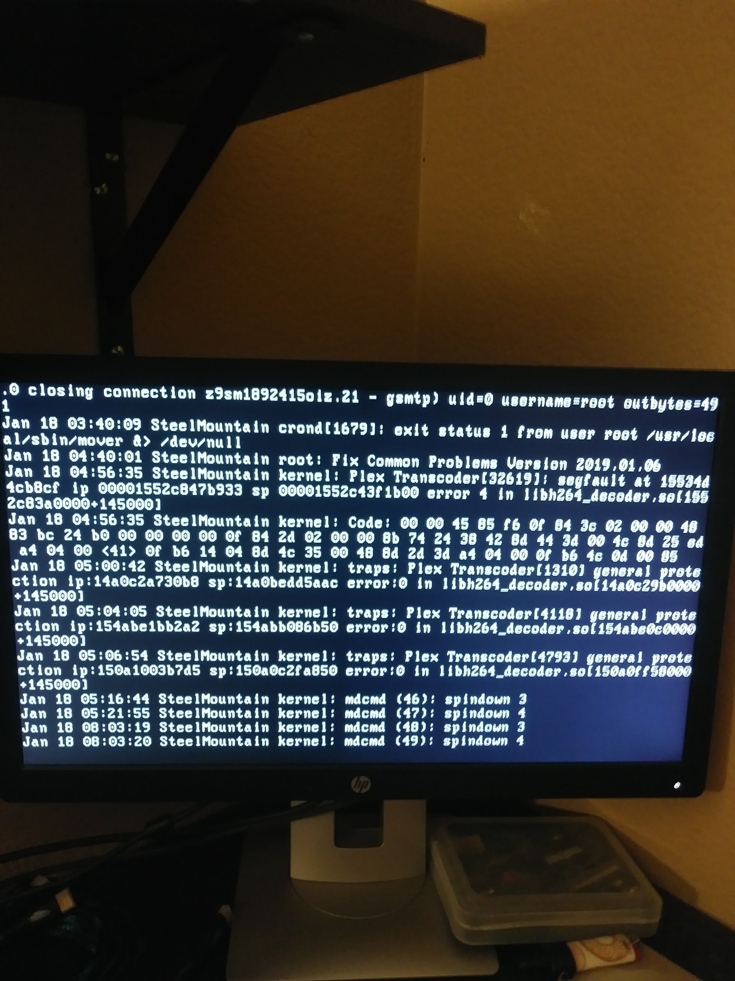

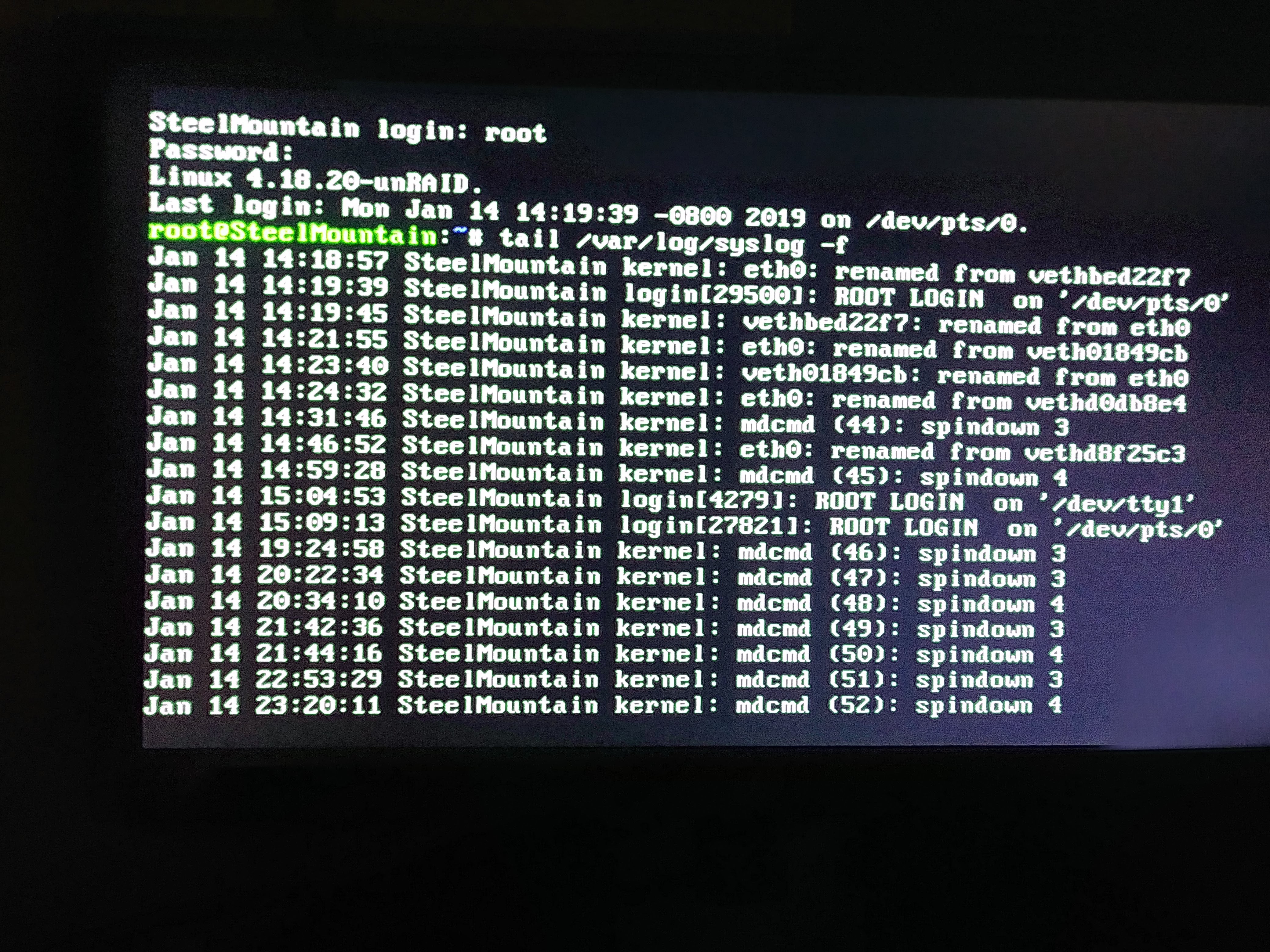

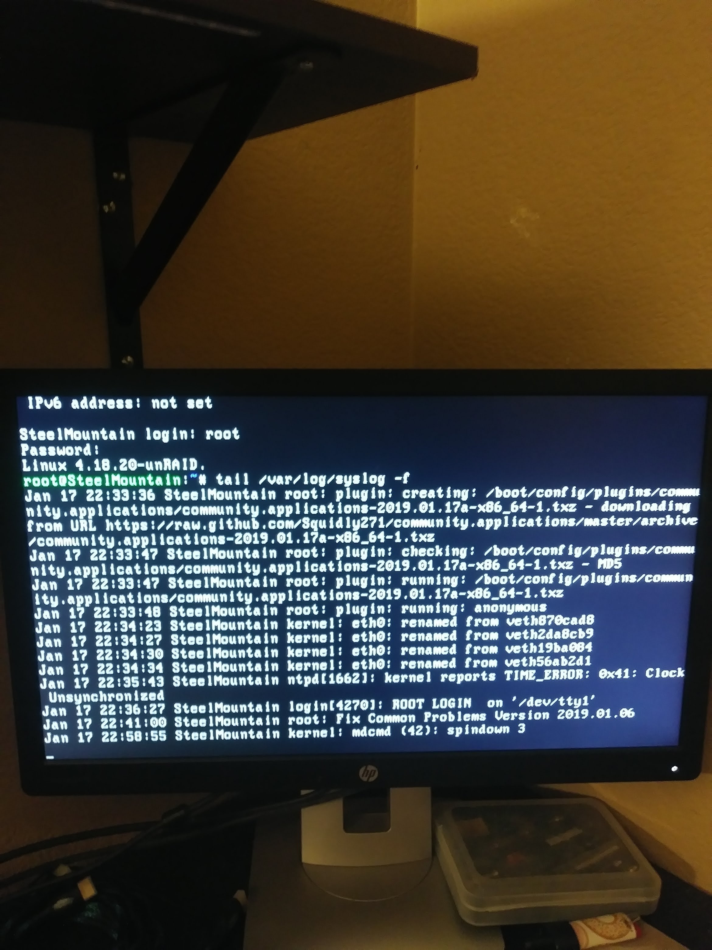

January 14, 20197 yr Another test. Boot up with a monitor and keyboard attached and load up the console (not the GUI). Login and then type the following command:tail /var/log/syslog -fThis will start printing the system log to the screen. Then when the system crashes next, take a picture of what's on that screen before rebooting. Sent from my Pixel 3 XL using Tapatalk
January 14, 20197 yr 41 minutes ago, DaemonHunter said: Yes I have a keyboard/mouse attached. both are unresponsive as if system locked up. I have not done a memtest yet. Would you recommend that for start? Thanks, DaemonHunter steelmountain-diagnostics-20190114-1416.zip You have a keyboard/mouse attached, but, no monitor? If you can attach a monitor, it will help in troubleshooting. Your diagnostics are after the last reboot so, of course, there is nothing in the syslog related to what might have causes the previous crash. The syslog, since it is stored in RAM, is reset on every reboot and information logged before then is lost. Try running 'tail -f /var/log/syslog" on the console or an open terminal window (leave it open). This will actively monitor the syslog and the last few lines of the syslog will be on your console monitor/terminal window when the server locks up and requires a reboot. Before rebooting, take a picture of the monitor screen and post that. Perhaps there will be a clue in what was last logged before the lockup. Have you noticed any call traces in previous syslogs? Do you have any dockers assigned custom IP addresses. I ask because this produced call traces/server lockups on my main server until I discovered a solution. A trurl mentioned, a memtest will determine if you have any memory issues. Run it at least 24 hours. It's an option in the unRAID boot menu, but, you need a monitor on the server to see what is going on with a memtest. I don't think the version included with unRAID has file logging. Edited January 14, 20197 yr by Hoopster
January 14, 20197 yr Author Sorry I guess I should read my response before sending it. Yes I have a monitor attached as well. I am tailing the log files currently and will let you know the outcome when it locks up. @Hoopster I have not noticed any call traces in previous syslogs. All dockers are assigned via static IP. Thanks, DaemonHunter
January 19, 20197 yr Community Expert Maybe a coincidence, but a couple of those screens show GPF with Plex transcoder. Which plex are you using? Does it happen if you don't run plex? What about that memtest?
