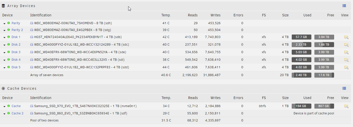

My array and cache drives so far:

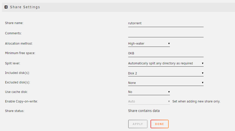

rutorrent dive set to ONLY include disk 2:

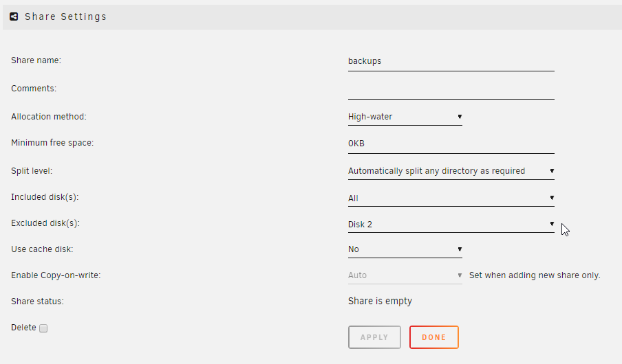

I've told all those shares to exclude disk 2 so not sure why they are there:
UnRAID never moves files between array disks.     When you tell UnRAID to exclude disk2 for a share you are telling it not to use disk2 for writing new files.   However any files that are already present are still used for read purposes.   You will need to manually move files you think should not be there to another disk..

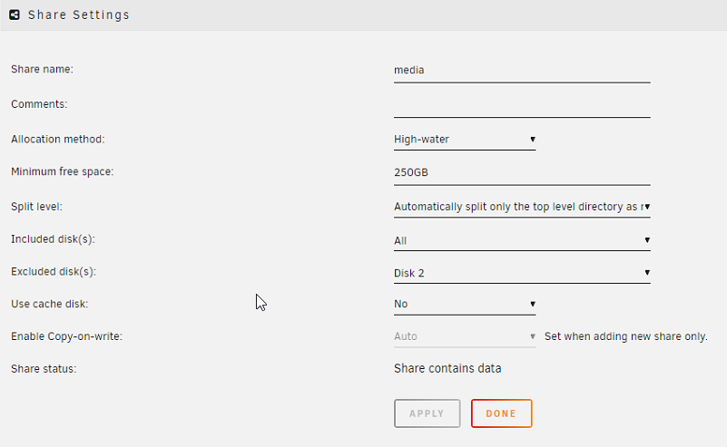

So started transferring my movies before I went to bed. Woke up to no enough free space. Everything is trying to go on that single disk I've told to exclude. Why is it not transferring files to the next disk if its full?
The is will be because Split Level over-rides allocation method when selecting a disk in the event of conflict.     You will either need to relax the split level, or move files off the full disk if you want to keep the split level you have set.
I must admit I have no idea quite what happens when/if the Split level tries to force files to a disk that has been excluded!   I can well see this being an edge case that has not been catered for.
If I had to guess, it probably checks where split level says the file should go before it bothers with checking any of the other settings. So it doesn't need to decide what disk to use in this case, and include/exclude is ignored just like allocation method and minimum free are when split level has already made the decision.
If it were cache-yes then that would just postpone the decision until mover is invoked, but with the same result unless split level were changed before mover happened.
Awesome, thanks guys. Think I have it figured out. I'm running unBALANCE and it will take 70 something hrs lol
