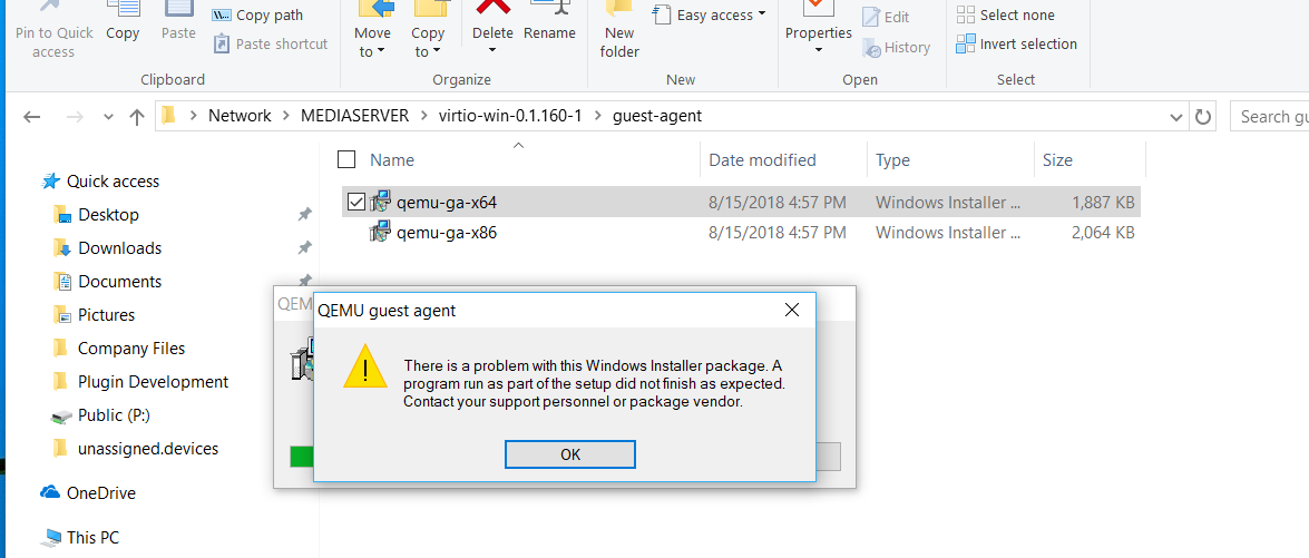

I am running two Windows 10 VMs.  On one of the VMs I am able to install the 64 bit version of qemu guest agent.  On the other VM I can only install an older version of the 32 bit qemu guest agent.  This is the error I get:
Any suggestions on how to solve this?  A search of  the Internet did not turn up anything useful.

So, back to the original reason for posting.  How do I get past the qemu 64 bit install problem?  The newer drivers insist on a 64 bit install, but it doesn't work so I have to go back to older drivers and install the 32 bit version.

Thanks.  I'll take a look at the new drivers.  I fixed the scsi error.  I hadn't changed my xml with the editor in a long time and apparently messed things up with some manual editing.  Changing things with the editor straightened things out.

Manually added the balloon device to the xml and got the driver working, but still the same issue with the 64 bit qemu driver.  I always thought it was the serial driver that was needed for the guest agent.

I just may have to stick with an older 32 bit guest agent and not worry about it.

Yes.  The latest qemu guest agent for 32 bit complains that it won't install on a 64 bit machine.

I'm getting the same error when attempting to install qemu-ga-x64.msi on either of my Win10 VMs with GPU passthrough(rx560/rx570). Installs fine on a clean install headless VM. Any more suggestions?

  • 7 months later...
