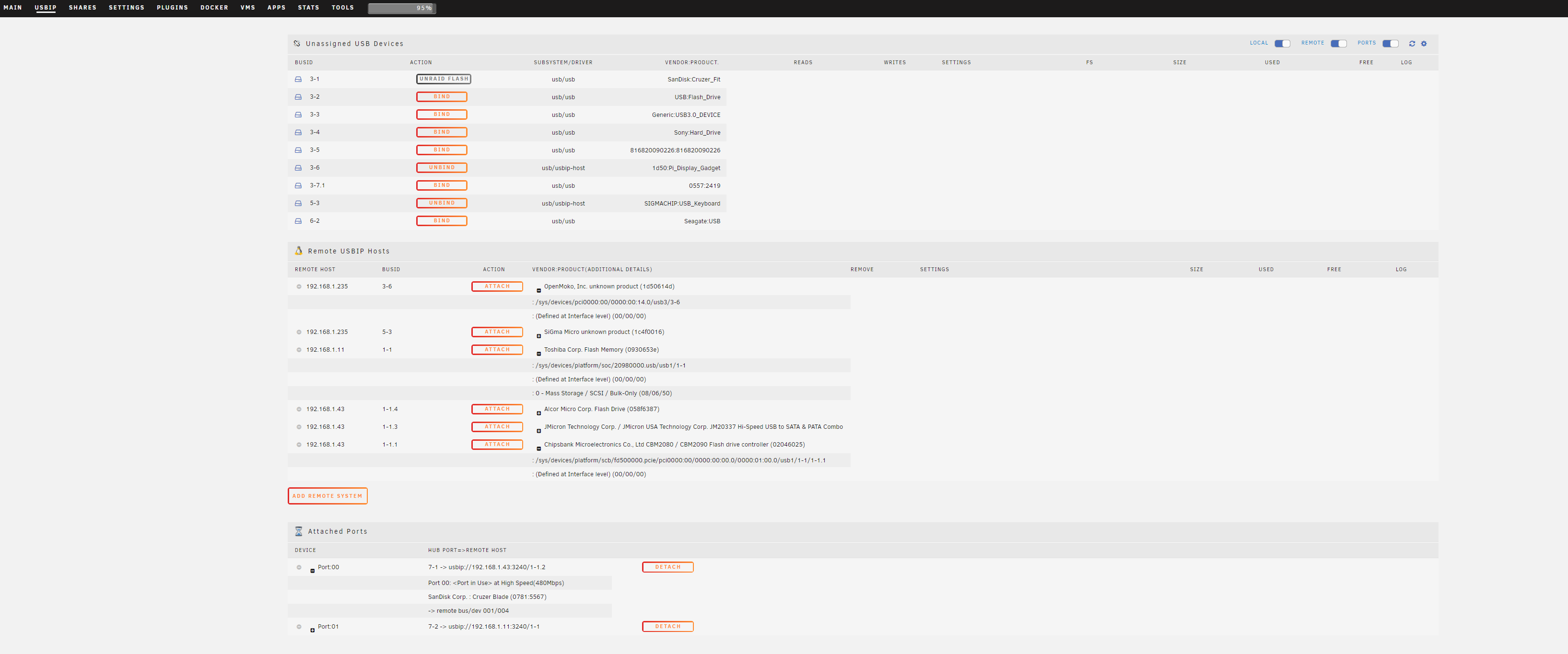

Is anyone using USBIP as I am starting to create a plugin to provide an interface. Based on unassigned devices. Are there any specific requirements people are looking for?
Already I have disabled the unraid flash from having an option to mount from the gui, and plan to disable USB devices if already in use i.e. in UD etc.
This is how it is looking so far.
I have created two plugings for USBIP.
1) First one will install just usbip and usbipd.
2) Provides a GUI for USBIP.
Both are in CA just search for USBIP. The GUI needs to have both installed as the commands are not included with the GUI..
You will find that some of the buttons will be disabled if the necessary modules are not loaded or commands are not found. At present it is still classed as Beta.
Please feel free to try it out and leave feedback, additional feature requests on this support link.
The usbip-host kernel module is not included within 6.9.0-rc2 but I can supply a version if required but it is Kernel specific, and will only work on 6.9.0-rc2. PM me about the module if you want to try it out.
USBIPD can be started whilst the array is not working, but I have made the events shutdown usbipd when the system is stopped.

Will be updating soon to include all modules and commands as part of the gui plugin. And will remove the old just commands one.
Thanks to @ich777 for the revised package including commands and modules.
Version 31.01.21 is now available on CA.
If you have the existing commands plugin you dont neeed it anymore, but will co-exist.
usbip-host module is now included through package provided by ich777.
