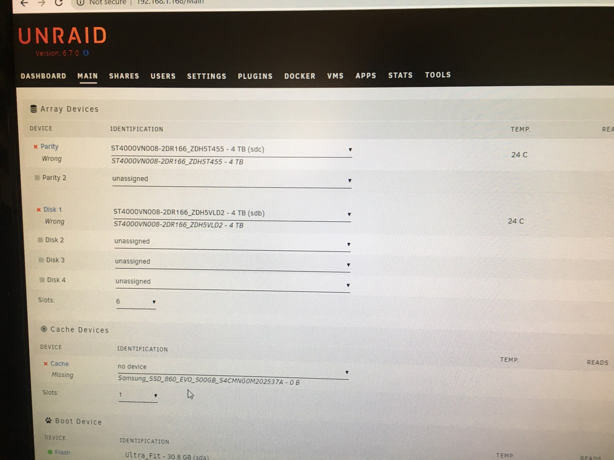

Howdy, folks!  As promised, wanted to check with a follow-up.  I had a chance to tinker a bit at my buddy's house.  First, it's humming along great. And noise is not bad at all under the desk. Looks nice, too.
The only issue is that initialization of drives... wasn't sure if it was writing to drives or just tweaking the RAID card.  We pulled them out after getting the array online and tried plugging directly into SATA on mobo.  No go.  Unraid saw the drives - even correct serial numbers, etc., but array wouldn't start. Friend doesn't want his data tied to a particular card, so for now, just running direct to mobo SATA with no RAID card.  Will get a $30 LSI card at some point and start using that way.
But yes, great easy entry system.
Would need the diags to confirm but they are likely being detect with a different size, one of the possible issues when using a RAID controller.

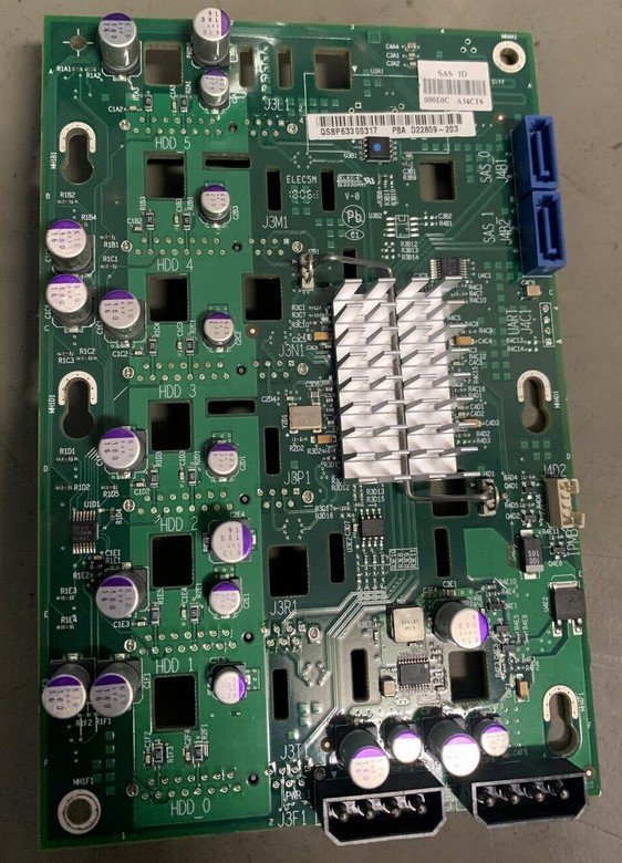

Hello again, I bought another backplane this one has two sata ports instead of the six connecting ports, that the one before had, I connect the ports to my LSI 9210 IT mode controller but there is now way to make the drives, on the backplane, go above 300.000Mb/s
when I connect the drives onto the LSI controller, directly, I get speeds of 600.000Mb/s.
Any ideas as of what to do? I can not find any documentation on the backplane...
dos anyone know if the backplanes have speed limitations?
Thank you for your time.
Angelo E
That suggests it's a SAS1/SATA2 backplane.
Thank you for making things clearer...
so I have to source a sata3 backplane, I do not even know ithere is one... that would fit the cage...
any ideas?
would you suppose that the expander is responsible for the speed?, there is a similar backplane but without expander, would you say that it most likely is a passthrough backplane, meaning it would go as fast as the controller that connects to?
Edited by dearangelo
Here is a link to the spare parts manual (pdf) for the server I think you have.  It looks like there are four backplane options (2x 4 drive and 2x 6 drive).  The two options are 1 for an expander and the other for no expander.  So, if you want SATA3, you'll want the opposite of the one you have now (sounds like the one you used to have that was broken).  Good luck.  I ended up scrapping my build because my problem was the LSI 9207-8i Controller (the only new thing besides the drives).  I kept assuming the old hardware from ebay was the problem but it turned out to be the new stuff 😞

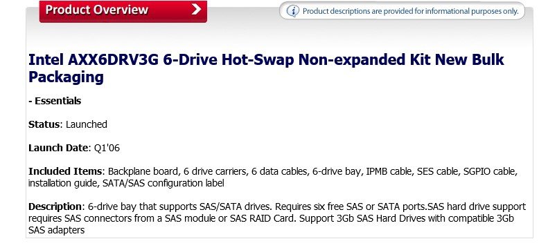

well, what you say, makes a lot of sense... but here, in ebay, this guy, describes the one with the six prts, meaning the one w/out the expander, is capable of 3Gb/s speeds... of course all this could be hot air... as it very often happens in ebay ads..
I will read the manual you suggest... and as a worst case scenario, I revert back to the simple gage that te server had, with six sata cablew connecting directly onto the drives, no fansy drawers etc...
Thank you for sharing!!!
Angelo E from Athens
My reading of the ebay ad you showed is that it should have worked.  It should have had 6 SATA ports on it which you would have hooked to a card or motherboard (i.e. "Requires six free SAS or SATA ports").  You received the one you sent a picture of yesterday?  It only has two SAS/SATA ports on it.

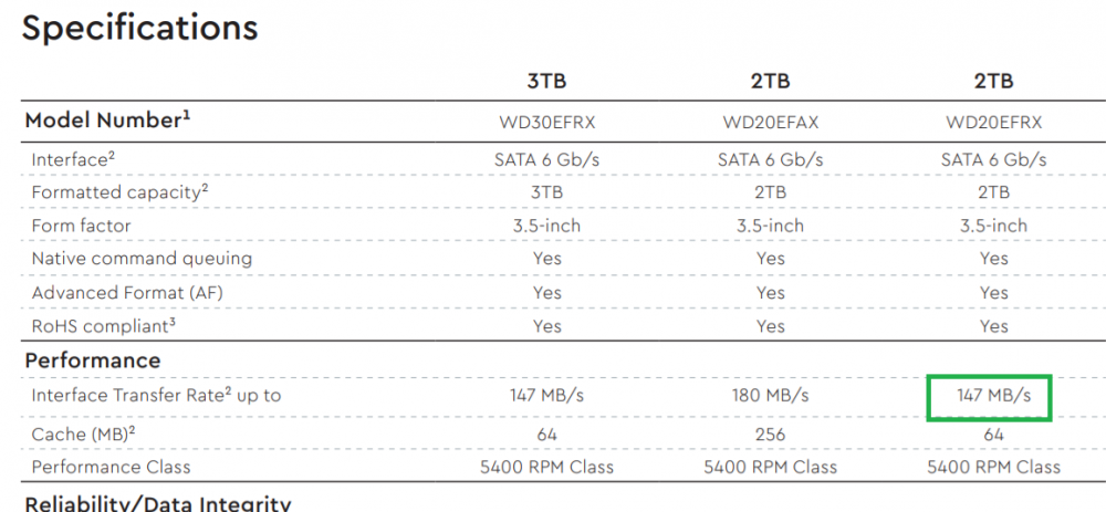

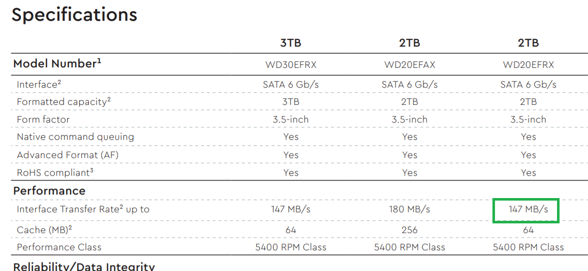

What are you using for hard drives?  SSD or spinning rust?  my understanding is that non-ssd drives only go up to about 150 MB/s (SATA1 is 150 MB/s, SATA2 is 300 MB/s), so you shouldn't see any actual difference.  I needed to buy the non-expanded one because the expanded one did not recognize my 4TB drives.  You may be ok with what you have now.
5 of those 4TB HDD
Yeah, those drives (pdf) only use 147MB/s, the interface on the drive is a SATA3 (6Gb/s or 600MB/s) and it's hooked to something that is telling the system it can only handle SATA2 (300MB/s).  But that's just saying "oh yeah, you can talk at 300 MB/s, roger" which doesn't mean that much can ever come out.  it's kind of like saying that you have a 6cm pipe connecting your house to the water but as soon as the pipe comes into the house it turns into 2cm pipe; making the 6cm pipe 12cm isn't going to make the water in the house run faster.
