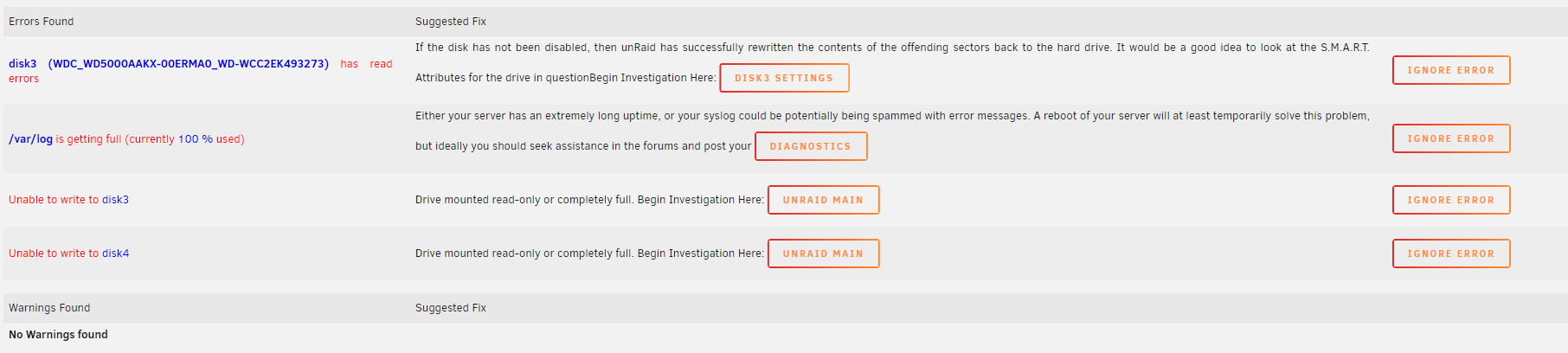

3. Now I'm getting another error message saying a different disk has Unable to write to disk and read errors.
4. Also, /var/log is getting full (currently 100 % used)

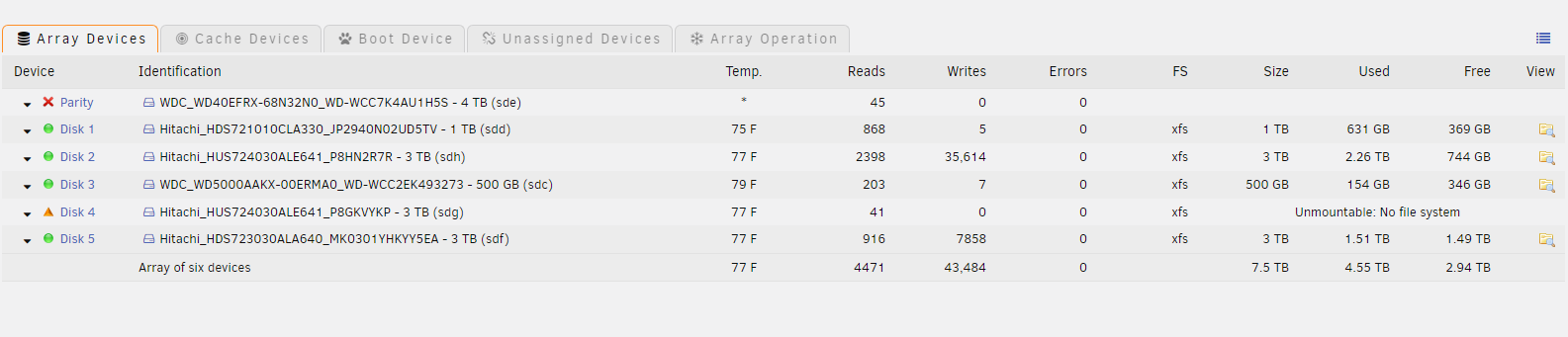

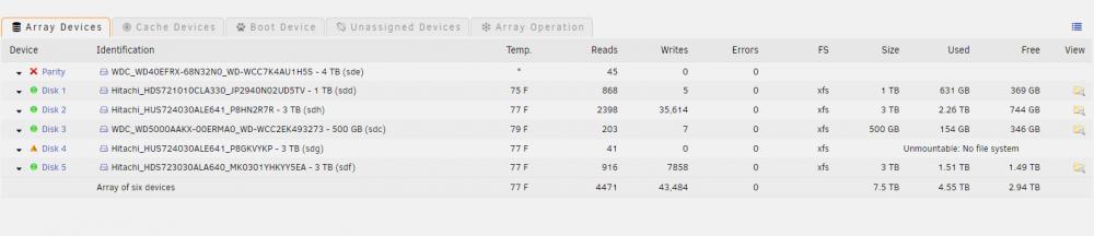

I found one new sata cable and replaced it with the one on the parity drive, and it's still showing a red X. I'm pretty sure it's dead as I know I heard a clicking sound the last time I booted up.
Disk 4 is now showing up as "Unmountable: No file system".
I ordered a set of new sata cables but they won't be here for few days. I'm almost certain this is not due to the cables though.
How should I handle replacing the parity drive with Disk 4 in the state it's in? Am I just looking at losing the data on disk 4?

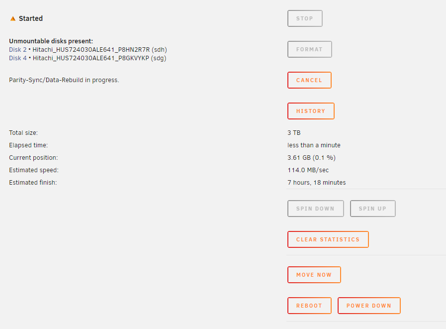

Ok I followed the directions and started the array after applying the new config and running the command. It's now showing that disk 2 and 4 are unmountable. Parity-Sync/Data rebuild is in progress. Should I let it complete?
tower-diagnostics-20190211-1003.zip
Cancel now, you didn't use the right command, and are also rebuilding, i.e. overwriting disk 2:
Feb 11 10:00:09 TOWER kernel: md: recovery thread: recon D2 D4 ...
Looks like you typed:
mdcmd set invalidslot 4 2
instead of:
mdcmd set invalidslot 4 29
Not that, looks like a copy/paste issue, I see on the log:
Feb 11 09:59:33 TOWER kernel: mdcmd (32): set invalidslot 4 29
but if I copy/paste from the syslog I get:
Feb 11 09:59:33 TOWER kernel: mdcmd (32): set invalidslot 4 2 9
this resulted in disks 4 and 2 being set invalid, instead of disk4 and parity2 as it should be.

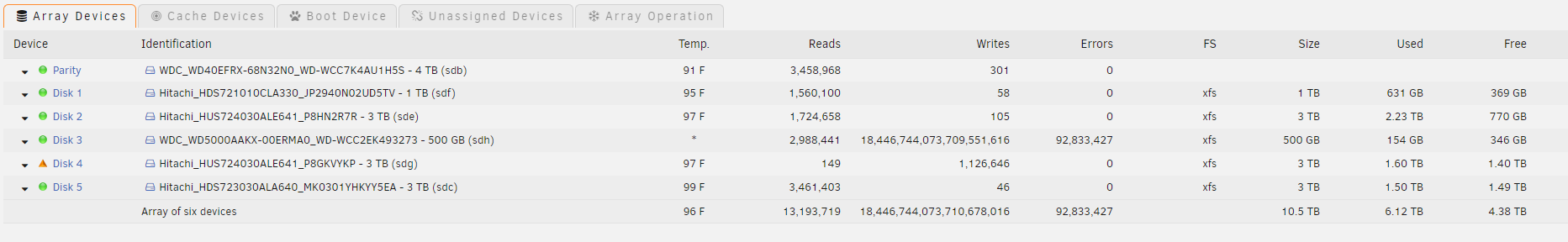

Ok question is which disk do I rebuild then? 2 or 4. I guess it doesn't really matter at this point.
17 minutes ago, trurl said:
Could be johnnie has gone to test what happens when you force it to rebuild 2 data disks with only one parity.
I tried to replicate this and Unraid crashed, it didn't started the rebuild, but looking at the screenshot it did start for the OP, so depending for how log it ran I fear it overwrote part of disk2.
I would try disk4, because after the overwritten part disk2 will be OK, disk4 we don't now how it is.
