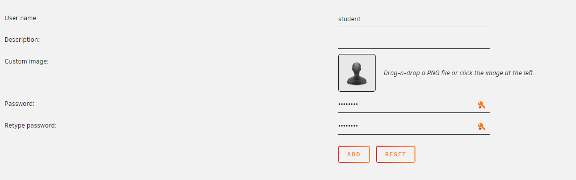

I've currently got 8 users (already) and I need a few more. However I can click on add but it doesn't do anything. image.thumb.png.8c5121481638033e9efe0fd4e6a68288.png
I've also tried using incognito mode but it doesn't change anything. Since I want to change share security I need a webgui user.
Thanks in advance

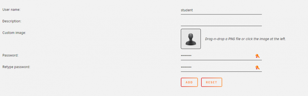

Hmmm?
A reboot fixed that, downloading the update now.
I can add users again, thanks.

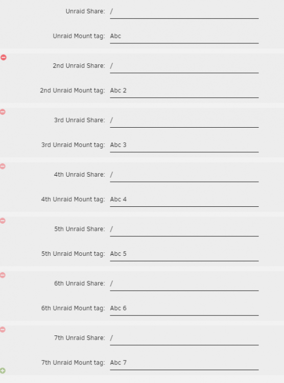

I'm encountering another problem, I'm trying to remove the unraid share mounting tags.
The 3rd one has been renamed. It keeps on adding the 4th one to ones I delete.
If I try to remove them all at once I get this error:

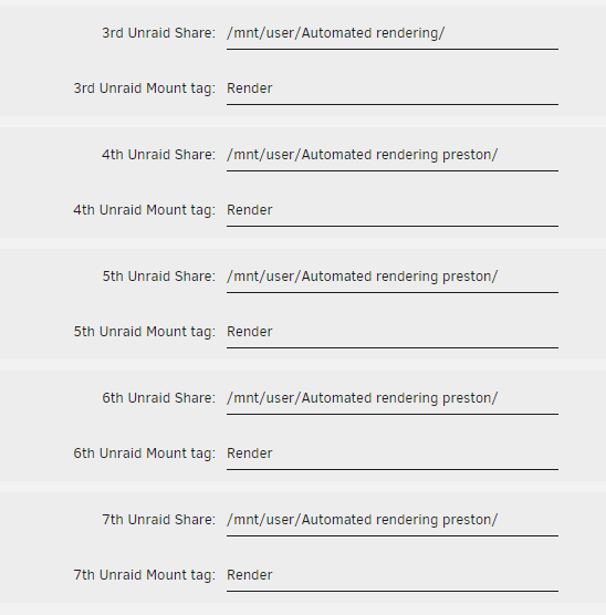

Now I've changed it to this since I don't want to use these anymore. (need more than 7 mounting points and am going to use smb now)
