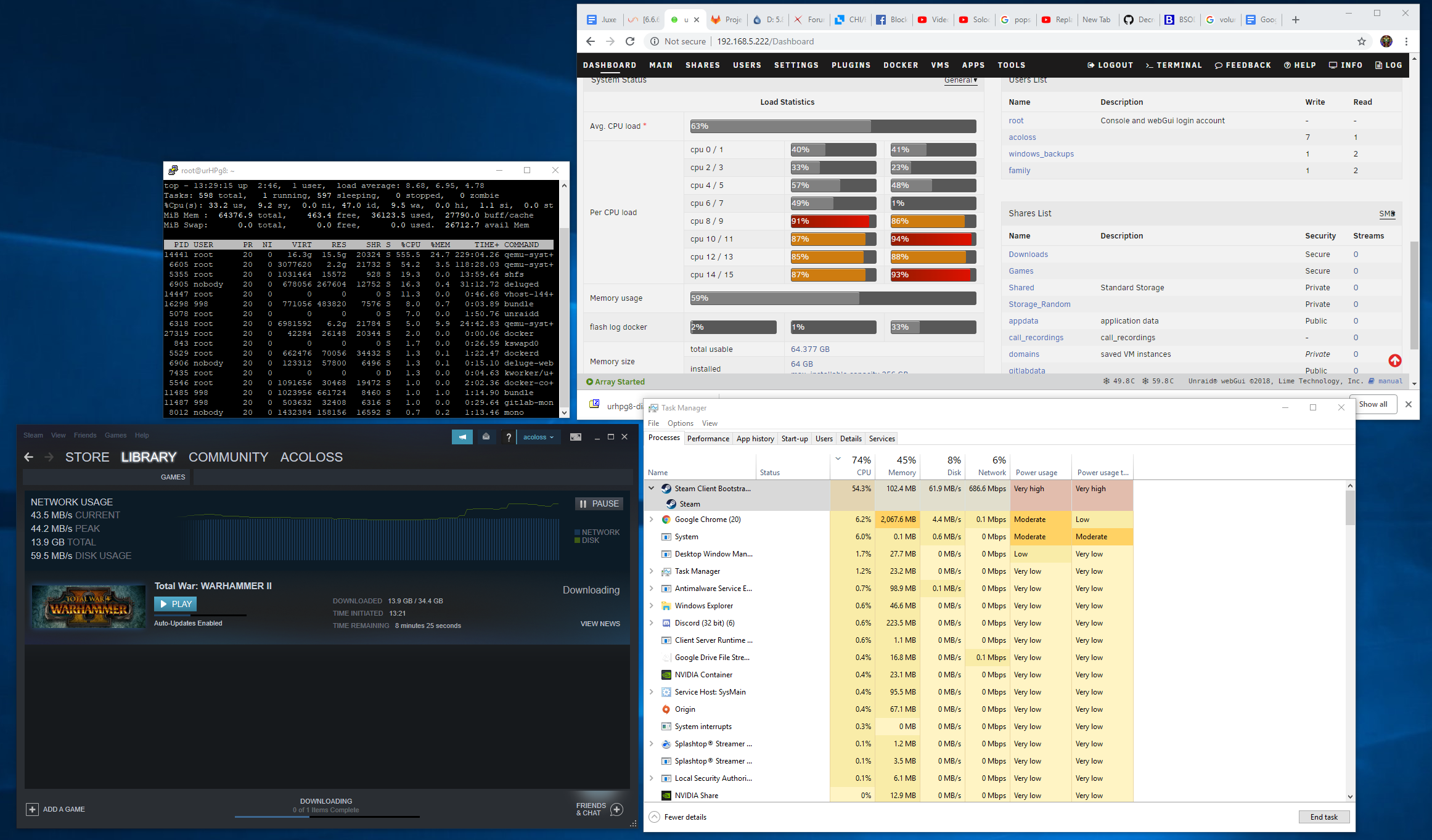

I think could be related to networking (virtual).
Downloading a game on steam (at 40MB/second), - Steam is using 50% of the 4 cores (+threads)
in unraid the VM is using 60-70% in total.
Edited by snailbrain

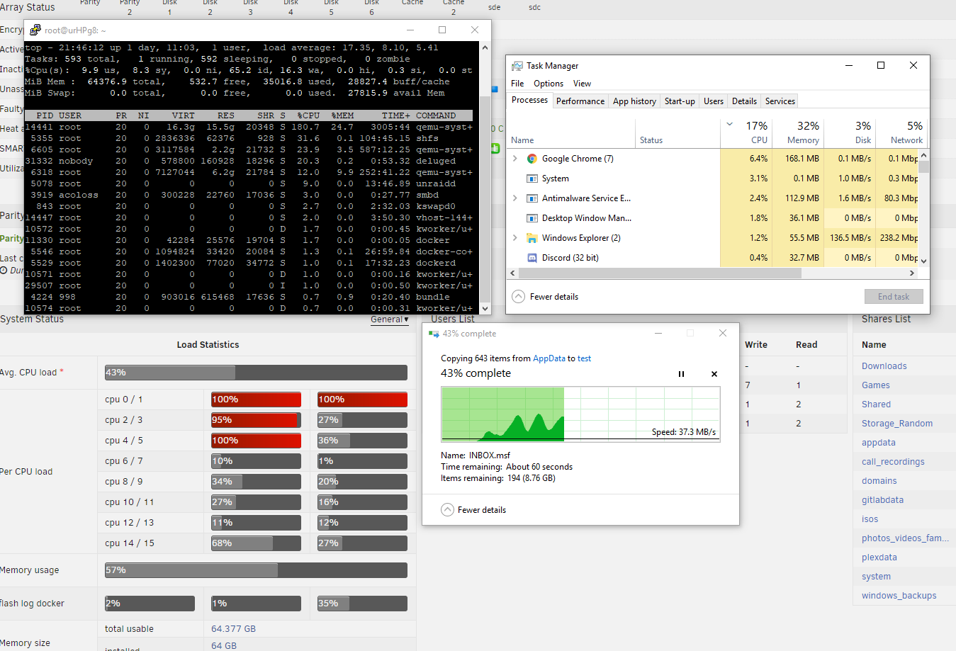

Here is an example with more info:
I'm copying from my nvme to a share which IS using the cache. Apart from it grinding to a halt, it's also using masses of CPU.
The first 3 cores are used by unraid and are 100% during the attempted copy. Strangly in "top" it does not show what is using the CPU (is that normal or does it help diagnose)
the terminal window there was inactive :D but same result (doesn;t show anything in top using 300%.. etc

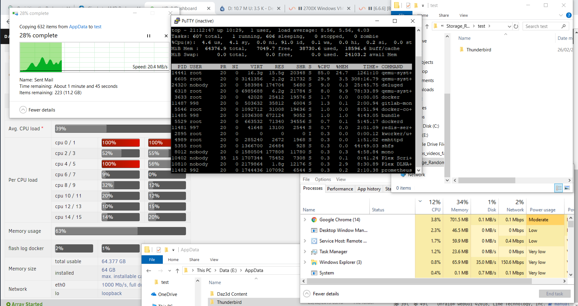

here is copying from nvme to cached share (6-15 are isolated. and windows is using 8-15. emu on 6.
