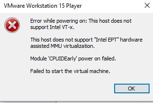

I am trying a similar thing with VMware Workstation
Windows 10 VM > Kali Linux VM and I get
I already did these steps after stopping VM's and disabling VM Manager:
First, from command line, type the following:
modprobe -r kvm_intel
Then type this:
modprobe kvm_intel nested=1
