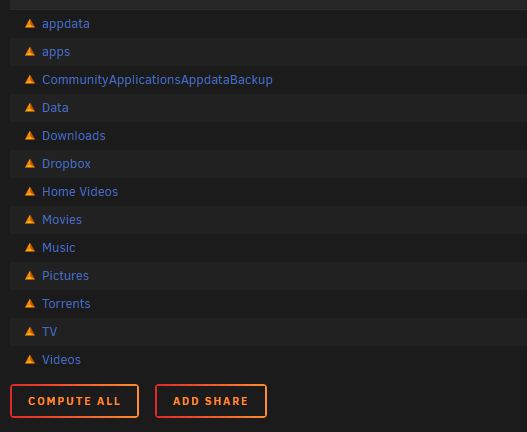

Hey folks,
I noticed yesterday all of my shares have the orange triangle indicating all or some shares are unprotected. I invoked the mover manually as well as waited overnight for it to automatically do it. I also checked the parity drive and got no errors:
Last check completed on Sun 31 Mar 2019 06:46:12 AM PDT (today), finding 0 errors.
Duration: 9 hours, 10 minutes, 50 seconds. Average speed: 90.8 MB/sec
I'm sure it's got to be a setting, I just don't know where. I recently installed the Unassigned Devices plugin for a flashdrive that I wanted to format as EXT4 (for the dropbox app), but I really didn't mess with any settings when I did that.
Any help would be great. I've attached my diagnostics. Thank you!
tower-diagnostics-20190331-0845.zip
Edited by LakersFan
Only shares that should have the all or some warning are
apps and D-----x,
That's my understanding, but they all are showing it. There are no issues when I do a Fix Common Problems scan. And of course a good ol' fashioned reboot didn't help either. 😛

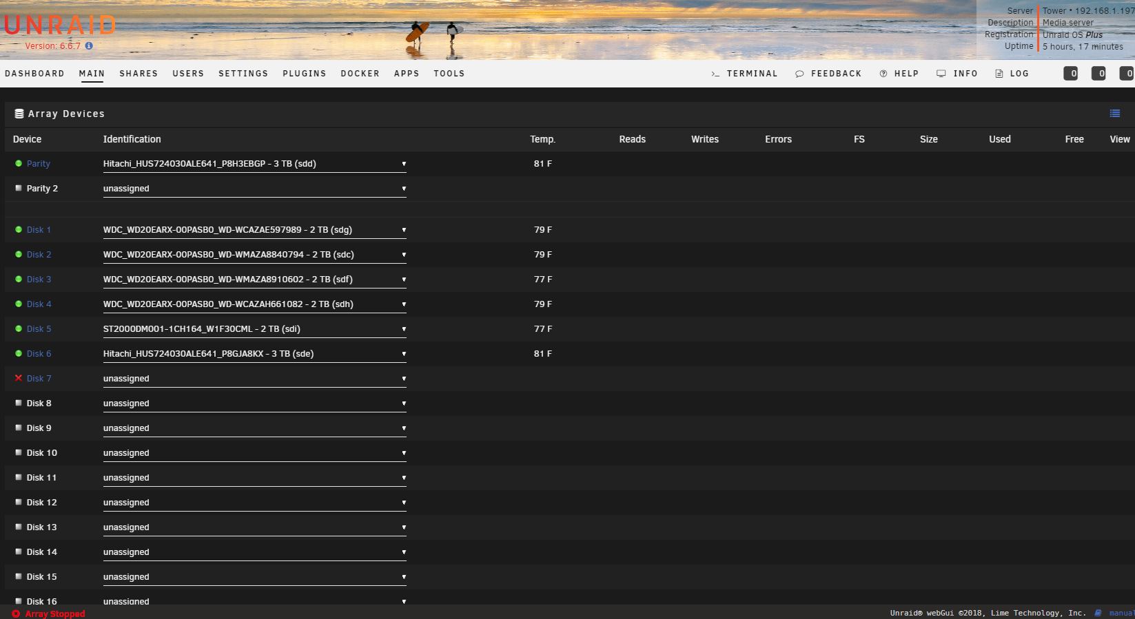

Stop the array and post a screenshot of your Main Page
This is because Disk 7 isn't valid (in which case the warnings are valid because parity expects disk 7 to be there and it's not)
Can I have it ignore Disk 7 for parity? I really don't care if the stuff it gets corrupted.
No.  The only way to remove a drive from the array (as you've previously had it installed) is to issue a New Config via Tools
Because of that missing disk, all of your data is at risk should a drive die on you.
Ah, man... Well thank you for the help. Guess I will get rid of that Disk.

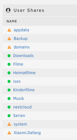

Can I refresh this task?
I have the same warning on some of my shares.
At least 5 of 13 - Screenshot attached.
Is this okay so or do I have to change something in my settings?
Regards Tobi

Is it possible that those shares are configured to be on the cache drive?
Do you have a single cache drive or a cache pool ?
Yes. Single Cache Drive
Appdata - Cache Prefer
Backup - Cache Prefer
domains - Cache Prefer
system - Cache Prefer
Xiaomi.Dafang - Cache Yes
With those settings I would expect all of those shares except the last to show orange as they are on the cache drive which being a single drive has no redundancy.    It is quite normal to have those shares on the cache drive for performance reasons and then periodically back up any important files to somewhere on the array.
the last one would be because you have written files to it since mover last ran.    When mover runs any files for that share on the cache (assuming they are not open in an app) will be moved to the array and the icon change to green.
Got it - thank you!
