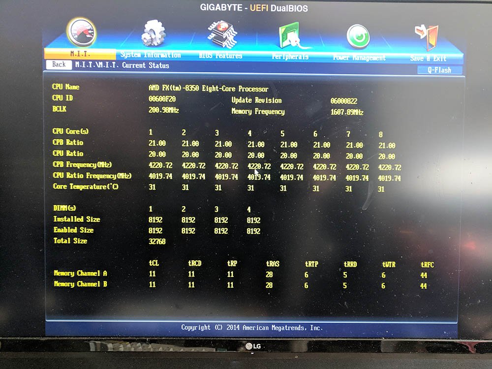

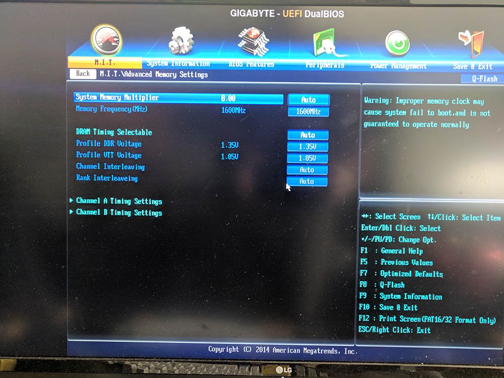

FoxxMD Posted April 3, 2019 Author Share Posted April 3, 2019 (edited) @Benson I have no such options in BIOS. I have attached pics of the memory-related features in my BIOS. Everything is set on auto or factory default. All memory is recognized. The only other piece of information I can think of is that my motherboard is a consumer board (GA-990FXA-UD3) and not advertised to work with ECC memory. However it's been confirmed by multiple forums posts I've found (and my own experience) that ECC does indeed work with it -- due to the board and cpu having a workstation heritages IE they were workstation base products that were "downgraded" to be consumer products. But I don't see how this would have any effect on my current issue since everything reports normally on BIOS and in unraid *except* that unraid won't use all 4 sticks for some reason... Edited April 3, 2019 by FoxxMD Quote Link to comment
Vr2Io Posted April 3, 2019 Share Posted April 3, 2019 If you can't found those setting in BIOS, pls forget it. If goggling you will got similar problem much and no matter old / new system, there also many different answer / solution. https://www.overclock.net/forum/24676509-post4.html DRAM Training (A stress test that occurs during POST that disables certain RAM channels if that channel is detected to be problematic) will cause less memory to be 'detected' (the RAM sticks will still show in utilities like cpu-z) The cause of the channels being problematic could be bad RAM settings or bad RAM itself. My MSI X99A XPOWER AC motherboard was very keen on disabling RAM channels, depending on the RAM settings (too aggressive overclock/timings) or memory controller (VCCSA or system agent). It's possible my RAMPAGE V was more lax in disabling RAM channels, but I could get it to happen still by being too aggressive. Try disabling your overclock, disabling XMP, using standard speeds, and see if the RAM comes back. Increase VCCSA if you deem necessary too. I don't know what CPU you have, but haswell-E system agent defaults to 0.85v, and the default 0.85v is enough for me to run 3000MHz DDR4 quad channel. So, if you confirm all stick and RAM slot work, then I would suggest you try underclock the memory from 1600Mhz to 1333Mhz and try. 1 Quote Link to comment
