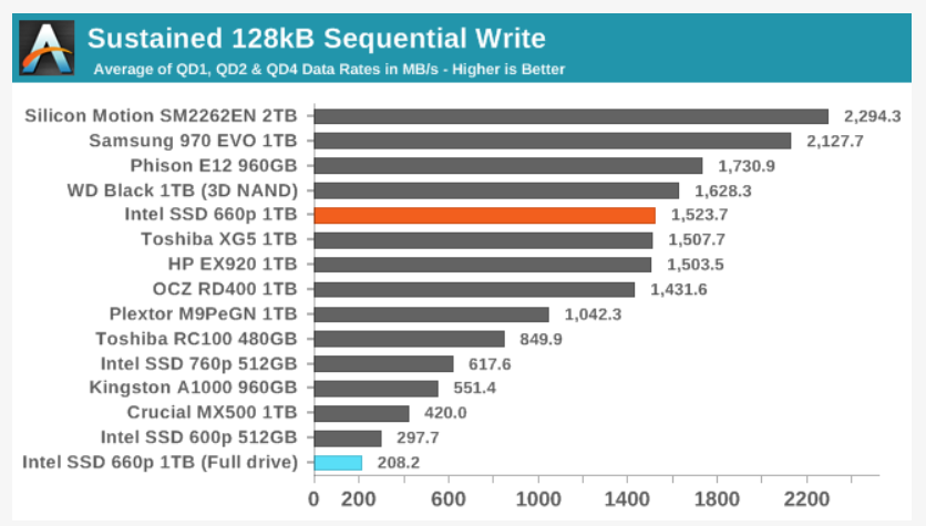

April 4, 20197 yr Community Expert Intel 660p are QLC, IIRC sustained write speed after the pseudo SLC cache is full goes down to 100MB/s.
April 4, 20197 yr Author Ok, so I need to find a NVME drive that does not use QLC like the Kingston which uses a 3D NAND Technology, NVM Express (NVMe), Phison E8 controller Can you confirm that if I use two in mirror mode I can expect roughly half of the performance? Looking at 2 X 1TB capable of 1800mb/s would it be unreasonable to expect 700-800mb/s in Raid 1 Mirror mode? Thanks

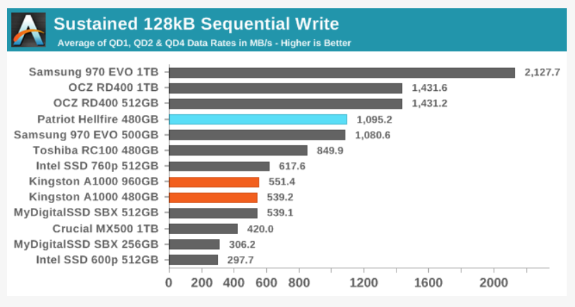

April 4, 20197 yr Community Expert 27 minutes ago, mbc0 said: the Kingston which uses a 3D NAND Technology, NVM Express (NVMe), Phison E8 controller I'm guessing you mean the A1000, no personal experience with these, but quick search shows they might not be that fast: Also look at the 660p performance when full (with no or little SLC cache left): IMO if you want performance you should go with the Samsung EVO, they are a little more expensive, but you seldom can get cheap and fast, I have two 1TB 970 EVOs on my desktop and am very happy with then, now would be the 970 EVO Plus.
