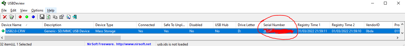

I downloaded USBDevew and checked the drive. It's calling it a serial number. Will this work as a unique identifier for UnRaid?
Thank you all again for your quick and helpful replies!
Unraid looks for a unique GUID. Whether that is what is referred to in that screenshot as a serial number is unknown to me.
The Unraid USB Creator utility should tell you.
