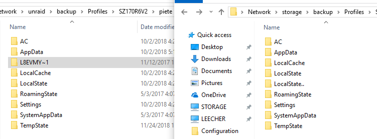

See the attached image, the directory on Unraid is there, but there are also directories that are not syncing, the "LocalState.." directory, note the double dots on the end of the folder name.

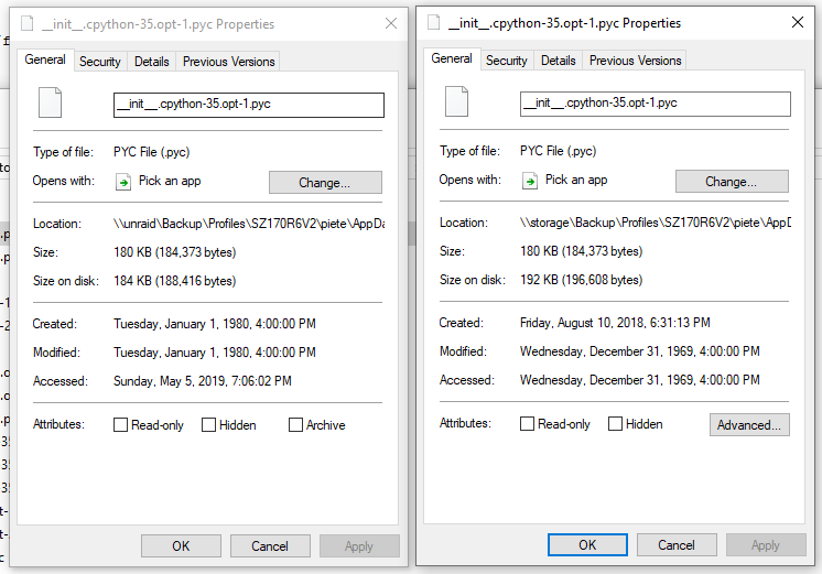

When I rerun robocopy, I will get the hundreds of files being reported as older on unraid, when those files have never been changed.
I am using the fat file time /FFT option to work around the lack of nanosecond granularity on EXT4/XFS vs. NTFS.
Same as the directory that does not delete, I can run robocopy clean, run it again, and it will copy a bunch of files again.
It is as if the file timestamps are even less granular then /FFT, or the file timestamps get changed by unraid after copy, invalidating the previous operation.
When I looked at two files where the timestamps were wrong, I can see that the unraid timestamps is not the same as that of the W2K16 server.

I don't think this is a permission problem, this is a file timestamp problem.
The files that will always be "older", are files that have a created date, but not a modified or accessed, interpreted as "1/1/1970 12:00:00 AM" UTC.

Unraid SMB fails to set correct timestamps if the NTFS are not linux friendly, i.e. not between 1970 and 2038.
I had several files with NTFS timestamps that were either the min value 1601 or the max value 30828.
Explorer does not display a timestamp if older than 1970.
I discovered some folders that ended in a ., and Unraid SMB discards the .
I had a folder called "LocalState" and another folder "LocalState..", when copying the "LocalState.." folder is copied it into the "LocalState" folder.
