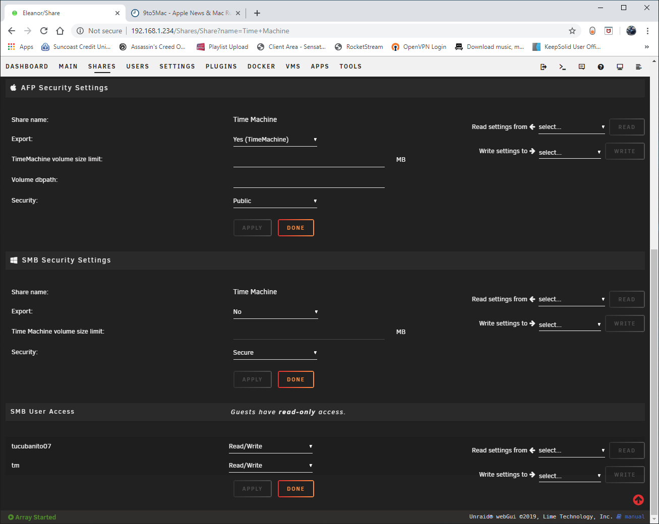

I used the following however, I am unable to provide the Time Machine screenshot as I did not configure my VPN to allow discovery.
-MW
580663598_ScreenShot2019-05-13at3_17_12PM.thumb.png.f7c8d6e25c8b262694a752dea7d91857.png1375823686_ScreenShot2019-05-13at3_17_50PM.thumb.png.e6eb2d0f045c4f149b39d4e522149d80.png896177209_ScreenShot2019-05-13at3_18_52PM.thumb.png.aefcb37d467b83ddc02bc5c3a5a2e281.png

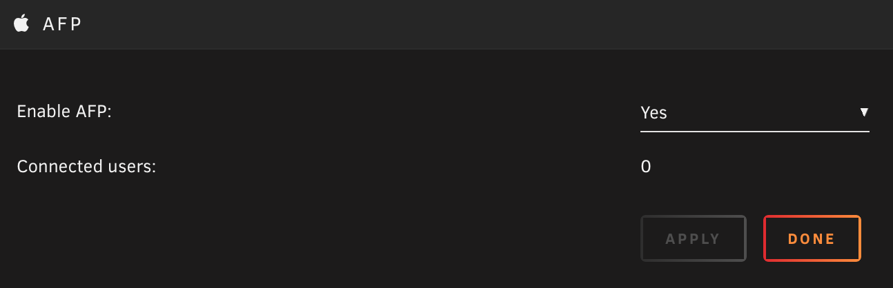

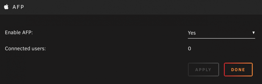

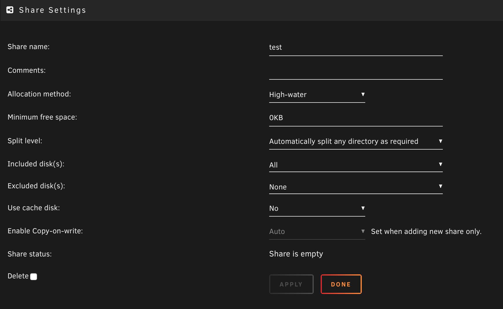

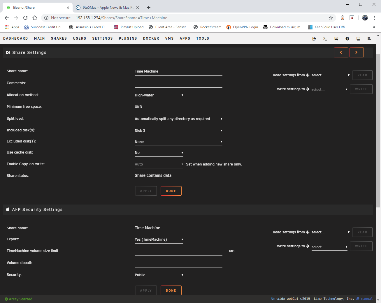

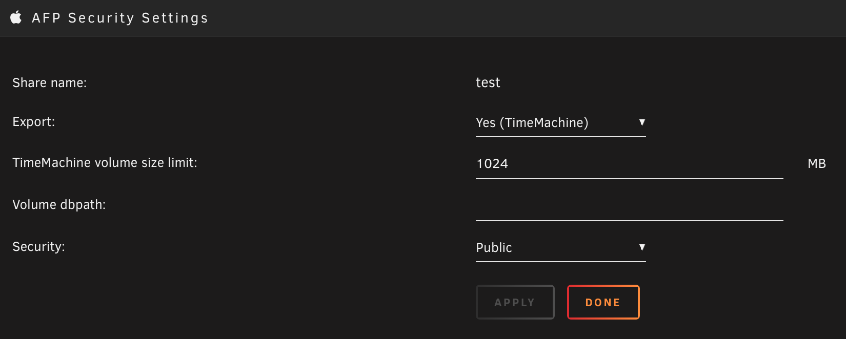

I'll post a picture of mine when I get home. Thanks guys for all the help.
image.thumb.png.5fdf680dd80a54ed663698cb36c71836.pngimage.thumb.png.90d328fd3d455b396f6d076d14a99823.png
I change the settings to match yours. Lets see if that works. I did not had AFP on. I only had SMB on with Yes/Time Machine.
It works just like the SMB version however, it will back up for a little bit and then just stops working. I am using the 5GHZ band right next to the router and it keeps stopping for no reason. It seems like is on a timer or set to a maximum of data and then it stops. So weird.
