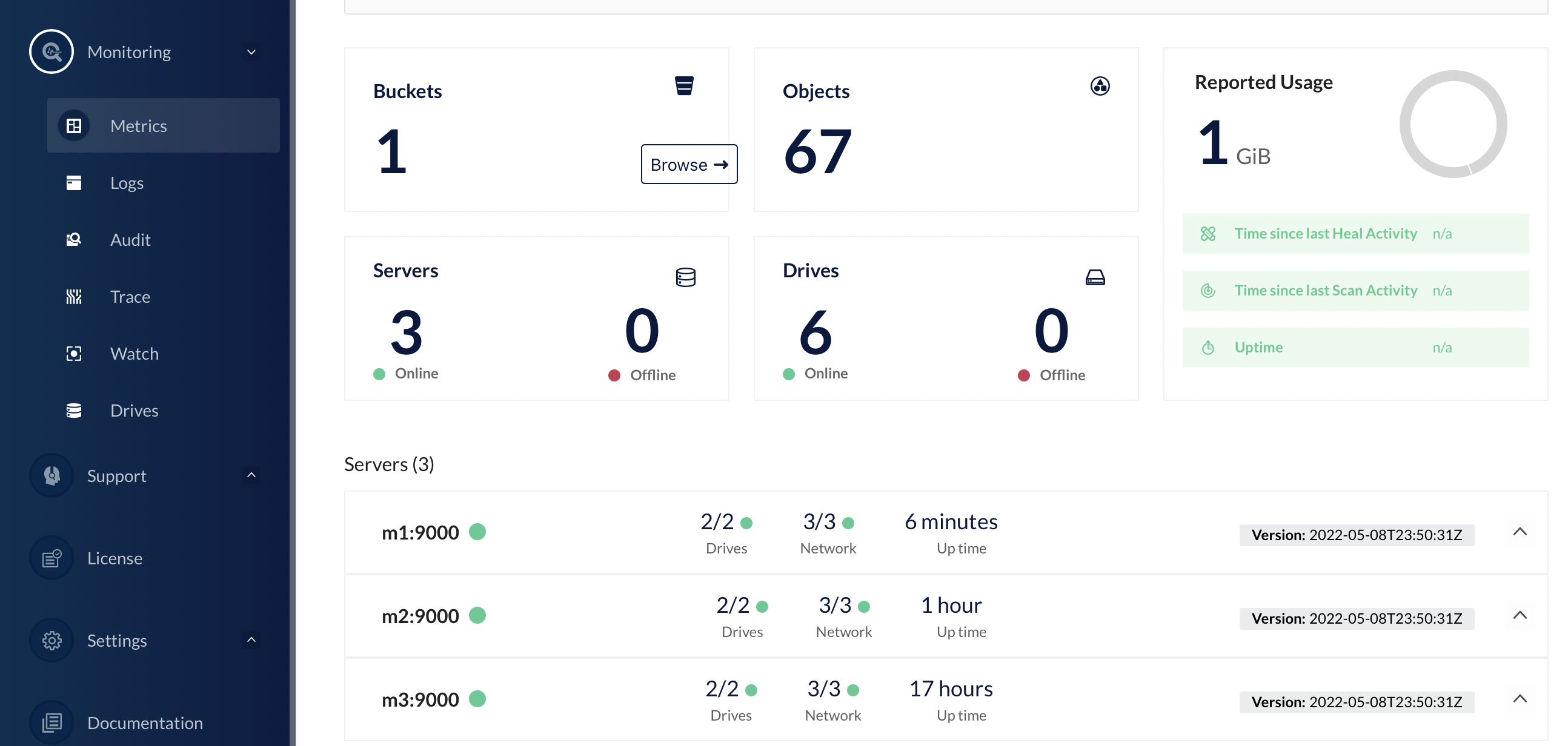

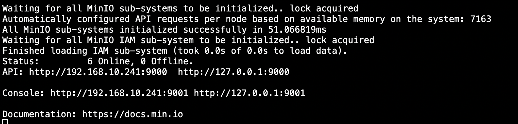

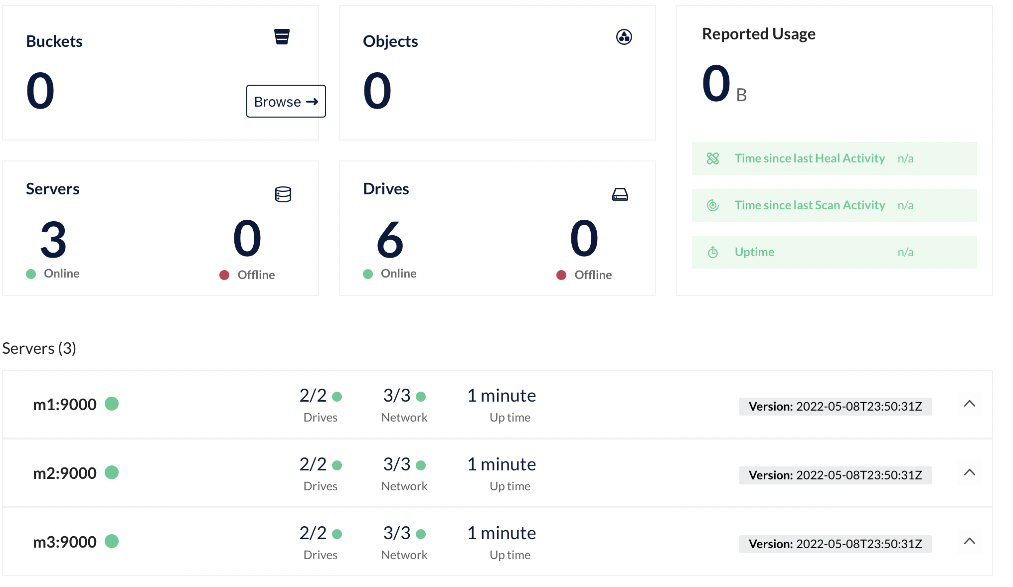

  6. This setup was used for nothing more than testing / lab use. It is not meant for production use. This not a tutorial on how to set up Unraid, VLAN's, routing, etc. It is expected that the individual setting this up has a basic understanding of how 'things' work. For this exercise I set up a 3 node distributed Minio cluster with 2 drives in each node. Your IP / DNS / Share / Drive / AppData / etc. locations may vary, set accordingly. You will need 3 IP's for this cluster: 192.168.10.241 192.168.10.242 192.168.10.243 You will need to set up DNS for this to work correctly: m1 - 192.168.10.241 m2 - 192.168.10.242 m3 - 192.168.10.243 Verify DNS is responding correctly: ping m1 ping m2 ping m3 They should all respond with the correct IP information Create drive / shares I creaded the drives / shares as follows: -minio-test -d1 -d2 -d3 -d4 -d5 -d6 Install the 1st instance of Minio: *Switch to Advanced View* Name: m1 WebUI: http://[IP]:[PORT:9001]/ Post Arguments: server --console-address ":9001" http://m{1...3}/data{1...2} Network Type: Custom: br0.10 -- vlan 10 (your network may vary) Fixed IP address: 192.168.10.241 Web UI: 9767 (leave as is - not needed in this configuration) Console UI: 9867 (leave as is - not needed in this configuration) Config: /mnt/user/appdata/m1 (locate on an SSD / cache drive) MINIO_ROOT_USER: (username must be the same on ALL instances) MINIO_ROOT_PASSWORD: (password must be the same on ALL instances) Remove original /data path variable Add 2 new additional path variables /data1: /mnt/user/minio-test/d1/ /data2: /mnt/user/minio-test/d2/ Create - do not start at this time Run Command: --name='m1' --net='br0.10' --ip='192.168.10.241' -e TZ="America/New_York" -e HOST_OS="Unraid" -e HOST_HOSTNAME="Hulk" -e HOST_CONTAINERNAME="m1" -e 'TCP_PORT_9000'='9767' -e 'TCP_PORT_9001'='9867' -e 'MINIO_ROOT_USER'='username' -e 'MINIO_ROOT_PASSWORD'='password' -l net.unraid.docker.managed=dockerman -l net.unraid.docker.webui='http://[IP]:[PORT:9001]/' -l net.unraid.docker.icon='https://raw.githubusercontent.com/cheesemarathon/docker-templates/master/images/minio.png' -v '/mnt/user/appdata/m1':'/root/.minio':'rw' -v '/mnt/user/minio-test/d1/':'/data1':'rw' -v '/mnt/user/minio-test/d2/':'/data2':'rw' 'minio/minio' server --console-address ":9001" http://m{1...3}/data{1...2} Install the 2nd instance of Minio: *Switch to Advanced View* Name: m2 WebUI: http://[IP]:[PORT:9001]/ Post Arguments: server --console-address ":9001" http://m{1...3}/data{1...2} Network Type: Custom: br0.10 -- vlan 10 (your network may vary) Fixed IP address: 192.168.10.242 Web UI: 9767 (leave as is - not needed in this configuration) Console UI: 9867 (leave as is - not needed in this configuration) Config: /mnt/user/appdata/m2 (locate on an SSD / cache drive) MINIO_ROOT_USER: (username must be the same on ALL instances) MINIO_ROOT_PASSWORD: (password must be the same on ALL instances) Remove original /data path variable Add 2 new additional path variables /data1: /mnt/user/minio-test/d3/ /data2: /mnt/user/minio-test/d4/ Create - do not start at this time Run Command: --name='m2' --net='br0.10' --ip='192.168.10.242' -e TZ="America/New_York" -e HOST_OS="Unraid" -e HOST_HOSTNAME="Hulk" -e HOST_CONTAINERNAME="m2" -e 'TCP_PORT_9000'='9767' -e 'TCP_PORT_9001'='9867' -e 'MINIO_ROOT_USER'='username' -e 'MINIO_ROOT_PASSWORD'='password' -l net.unraid.docker.managed=dockerman -l net.unraid.docker.webui='http://[IP]:[PORT:9001]/' -l net.unraid.docker.icon='https://raw.githubusercontent.com/cheesemarathon/docker-templates/master/images/minio.png' -v '/mnt/user/appdata/m1':'/root/.minio':'rw' -v '/mnt/user/minio-test/d3/':'/data1':'rw' -v '/mnt/user/minio-test/d4/':'/data2':'rw' 'minio/minio' server --console-address ":9001" http://m{1...3}/data{1...2} Install the 3rd instance of Minio: *Switch to Advanced View* Name: m3 WebUI: http://[IP]:[PORT:9001]/ Post Arguments: server --console-address ":9001" http://m{1...3}/data{1...2} Network Type: Custom: br0.10 -- vlan 10 (your network may vary) Fixed IP address: 192.168.10.243 Web UI: 9767 (leave as is - not needed in this configuration) Console UI: 9867 (leave as is - not needed in this configuration) Config: /mnt/user/appdata/m3 (locate on an SSD / cache drive) MINIO_ROOT_USER: (username must be the same on ALL instances) MINIO_ROOT_PASSWORD: (password must be the same on ALL instances) Remove original /data path variable Add 2 new additional path variables /data1: /mnt/user/minio-test/d5/ /data2: /mnt/user/minio-test/d6/ Create - do not start at this time Run Command: --name='m3' --net='br0.10' --ip='192.168.10.243' -e TZ="America/New_York" -e HOST_OS="Unraid" -e HOST_HOSTNAME="Hulk" -e HOST_CONTAINERNAME="m3" -e 'TCP_PORT_9000'='9767' -e 'TCP_PORT_9001'='9867' -e 'MINIO_ROOT_USER'='username' -e 'MINIO_ROOT_PASSWORD'='password' -l net.unraid.docker.managed=dockerman -l net.unraid.docker.webui='http://[IP]:[PORT:9001]/' -l net.unraid.docker.icon='https://raw.githubusercontent.com/cheesemarathon/docker-templates/master/images/minio.png' -v '/mnt/user/appdata/m1':'/root/.minio':'rw' -v '/mnt/user/minio-test/d5/':'/data1':'rw' -v '/mnt/user/minio-test/d6/':'/data2':'rw' 'minio/minio' server --console-address ":9001" http://m{1...3}/data{1...2} Launch all 3 Minio instances. The logs will be littered with communications errors until all 3 devices are online and communicating with each other. Log example: When all 3 instances have been started and you see a screen similar to above (log output), log in to any of the Minio instances and click on Monitoring and then Metrics. You should see '3' Servers online and '6' Drives online. What's left: **Set up NPM - NGINX Proxy Manager so that when hitting the API or Console ports the requests are answered by any one of the 3 nodes. Right now I can configure to send to one of the 3 nodes. There is a custom area, just need to figure out how to fill that in. If anyone has experience with this, please chime in with examples / screenshots **Set up Prometheus for additional metrics and alerts. Anyone else what to take a crack at it? **Start messing with the S3 raw access policies - if anyone has experience with this, here is what I am trying to do. I need some help with tailoring the following: Allowing a specific user to log in, create/modify/delete/read/write to a bucket and then view all buckets under their username. As of right now I can have a user log in AFTER I create a username/password and bucket for them however, I have to specifically assign them permission to view the bucket I just created. I would rather just create the user account and then allow the user the ability to create their own. Original policy below that works when I log in as 'mfwade' and have created the bucket called 'mfwade' I can do nothing else... Formatting may be messed up due to copy and paste - context is correct.... Policy: { "Version": "2012-10-17", "Statement": [ { "Sid": "BucketAccessForUser", "Effect": "Allow", "Action": [ "s3:DeleteObject", "s3:GetObject", "s3:ListBucket", "s3:PutObject" ], "Resource": [ "arn:aws:s3:::mfwade/*", "arn:aws:s3:::mfwade" ] } ] } I hope this information helps others to set up something similar. If I can help in any way, please let me know.

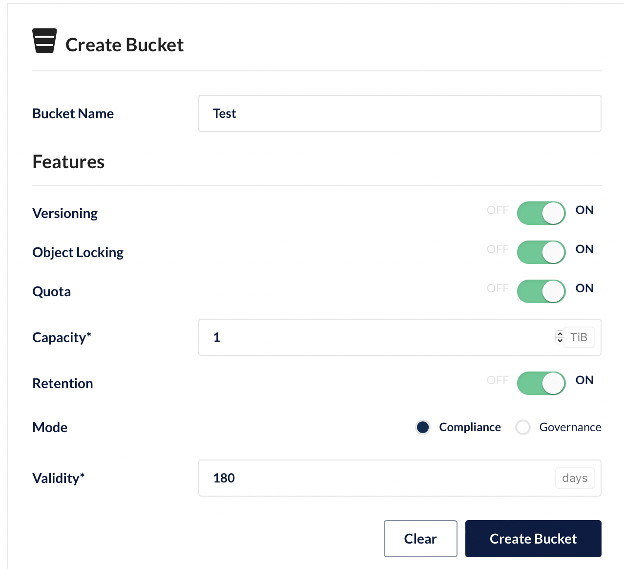

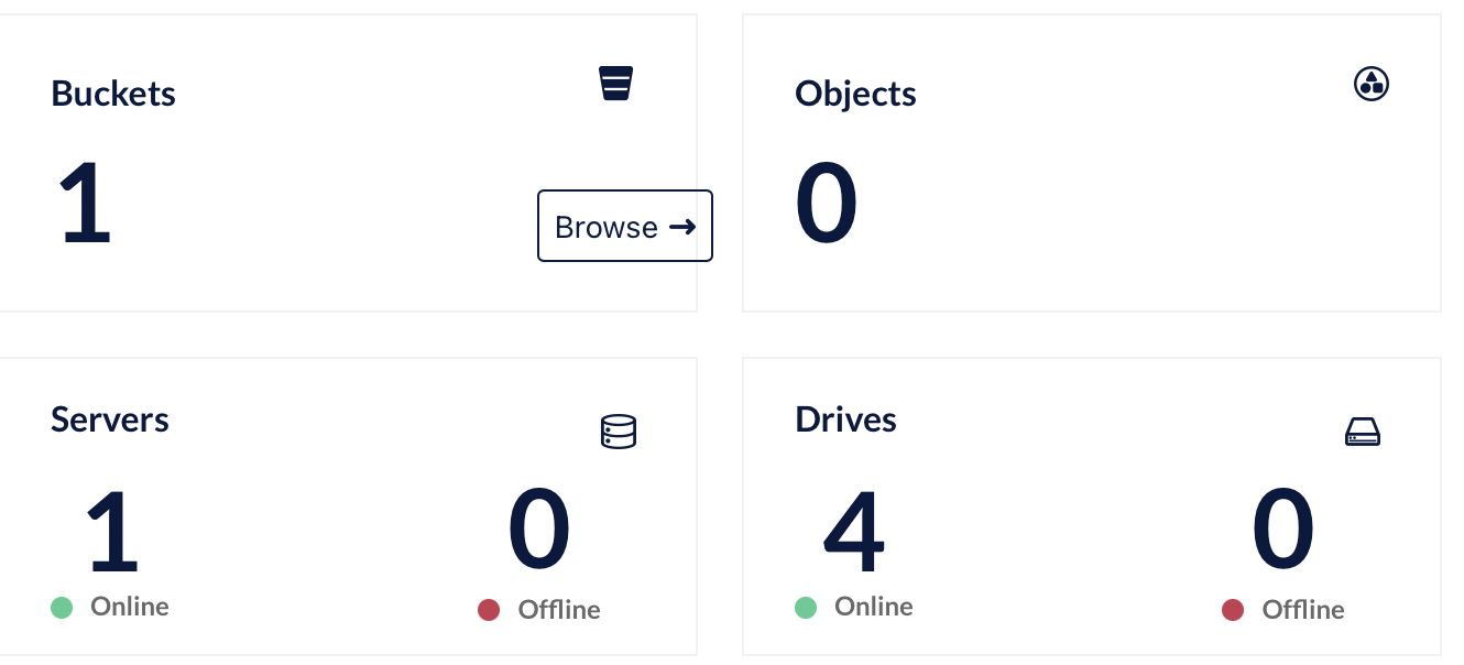

  8. I was able to get it (single instance with multiple drives) working with 4 drives - in my case I just created 4 shares... This allows me the ability to create the bucket and tick off versioning, retention, etc. Post Arguments: server /data{1...4} --console-address ":9001" I deleted the original /data variable and created 4 new variables labeled data1 through data4, mounted to /data1 through /data4 respectively. So /data1 mounts to /mnt/user/test1/, rinse, lather, repeat. Now, just need to figure out how to add an additional server.
