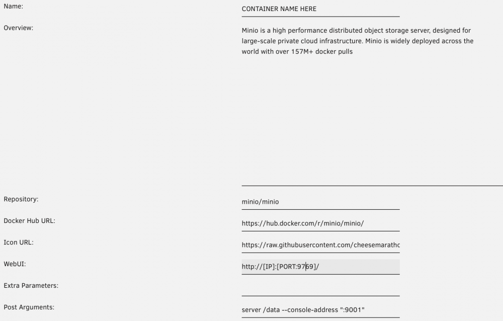

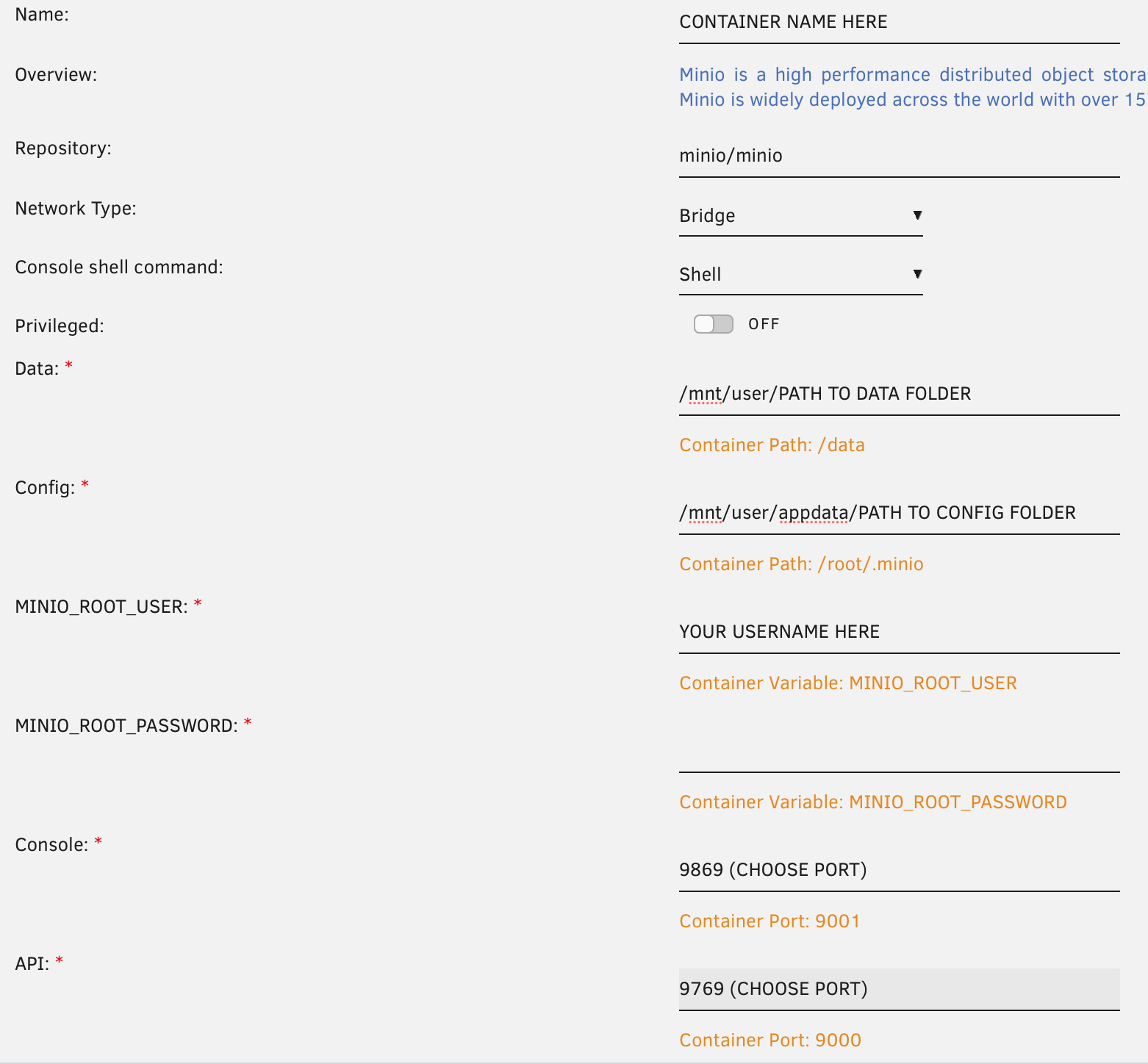

  16. Danuel, Post your Unraid setting for the Minio container. Here is how I have mine set. The CONSOLE port is now used for Web UI - management. The API port is what is used for client connectivity. Settings I used in Unraid (Advanced view): Reminder, when connecting software to perform backups, etc, (Arq, GoodSync, Cloudberry, etc.) you will connect to the API port. So, if using NGINX Proxy Manager, you would map the connection to 9769 (in the example above).

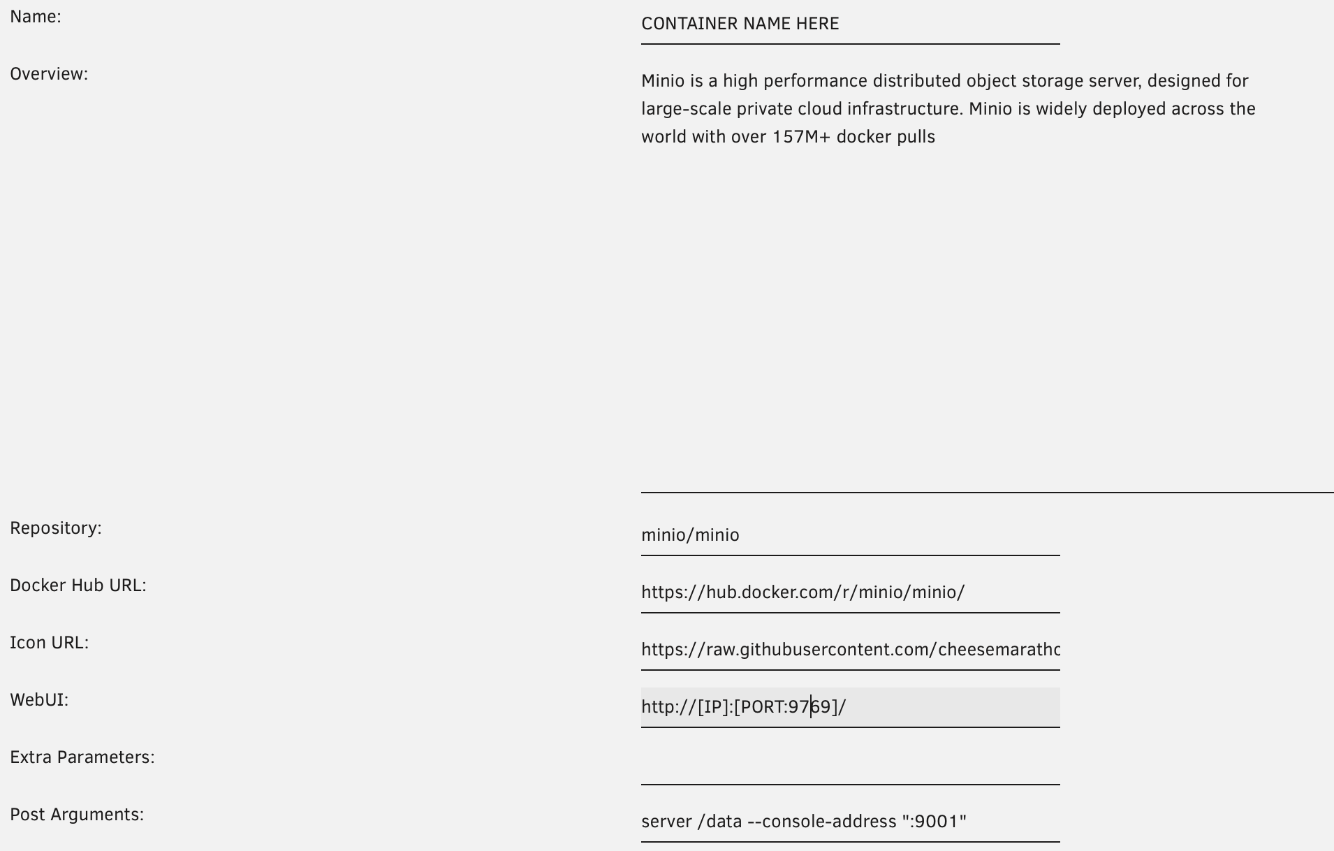

  17. Thanks to everyone for your help. All my Minio instances are now back up and all users are able to attach to the servers to perform backups, etc. Settings I used in Unraid (Advanced view): Reminder, when connecting software to perform backups, etc, (Arq, GoodSync, Cloudberry, etc.) you will connect to the API port. So, if using NGINX Proxy Manager, you would map the connection to 9769 (in the example above).
