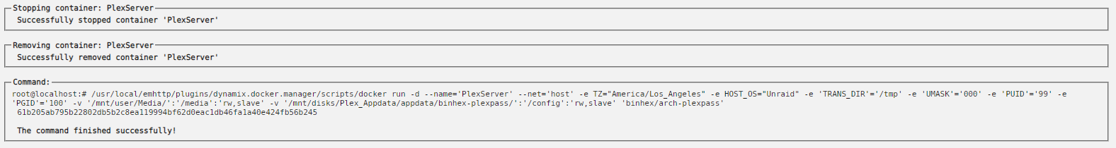

Also, docker run command for your plex docker as explained in this very first link in the Docker FAQ:

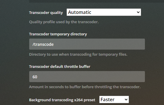

Also, the transcode directory setting within the plex application.

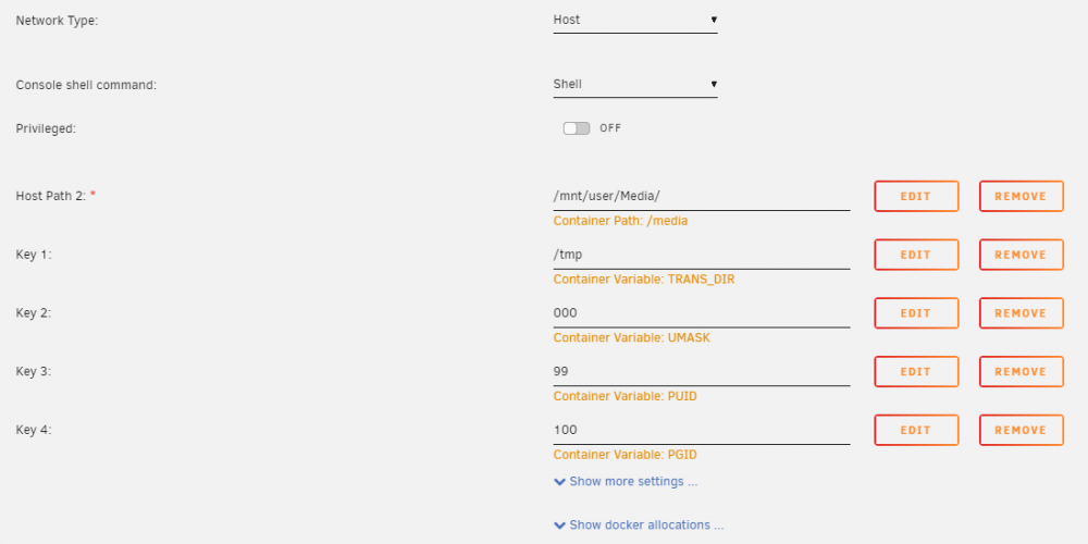

The transcode will definitely be going into the docker image as you have no path mapping for the transcode directory to an location external to the container.
I'm definitely not understanding it then... I Though that was the "/tmp"  can you be a little more specific as to what and where i need to change to have the transcode go to RAM?
When I try and map a path to /tmp in the docker i get an error as is mounted but not a share.  Im away from my home network at the moment but ill upload a screen shot later.
If i change the plex transcode directory to "/TRAN_DIR" that is set to key1 variable "/tmp" would that make it transcode to ram?

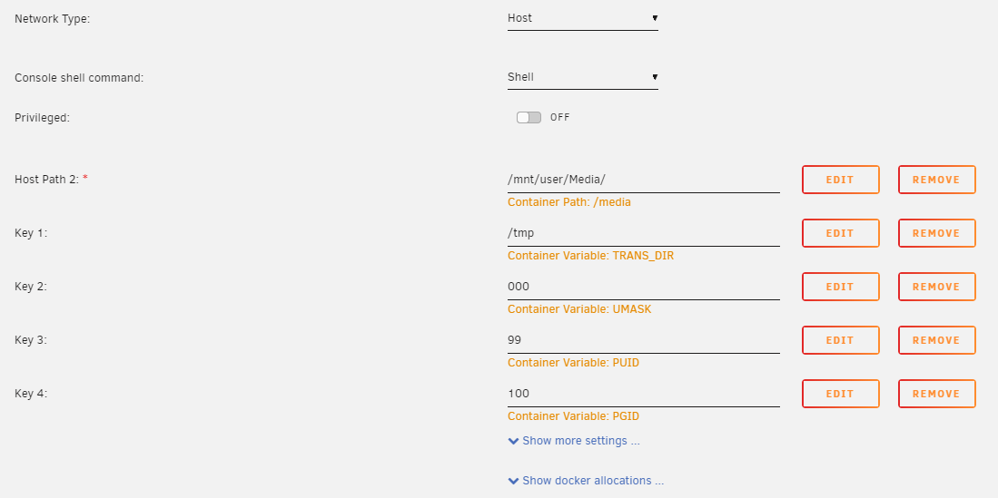

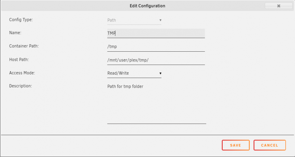

I too have been having issues as of late. Plex sits arounf 423mb used then spikes to 7.4G then 14G, etc. I found that the /tmp dir was the culprit.

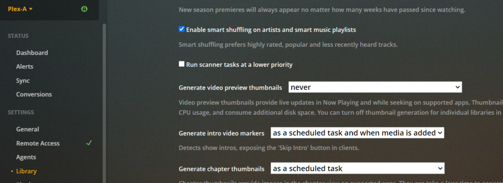

I found an article that states the developers are aware of it and is related to the recent  "Skip Intro” feature. That being said, it mentioned setting the following setting to never: (Settings - Server - Library - ‘Generate intro video markers’ set to “never” until this issue is fixed. I didn't set mine to never, rather i added an additional Path (below).

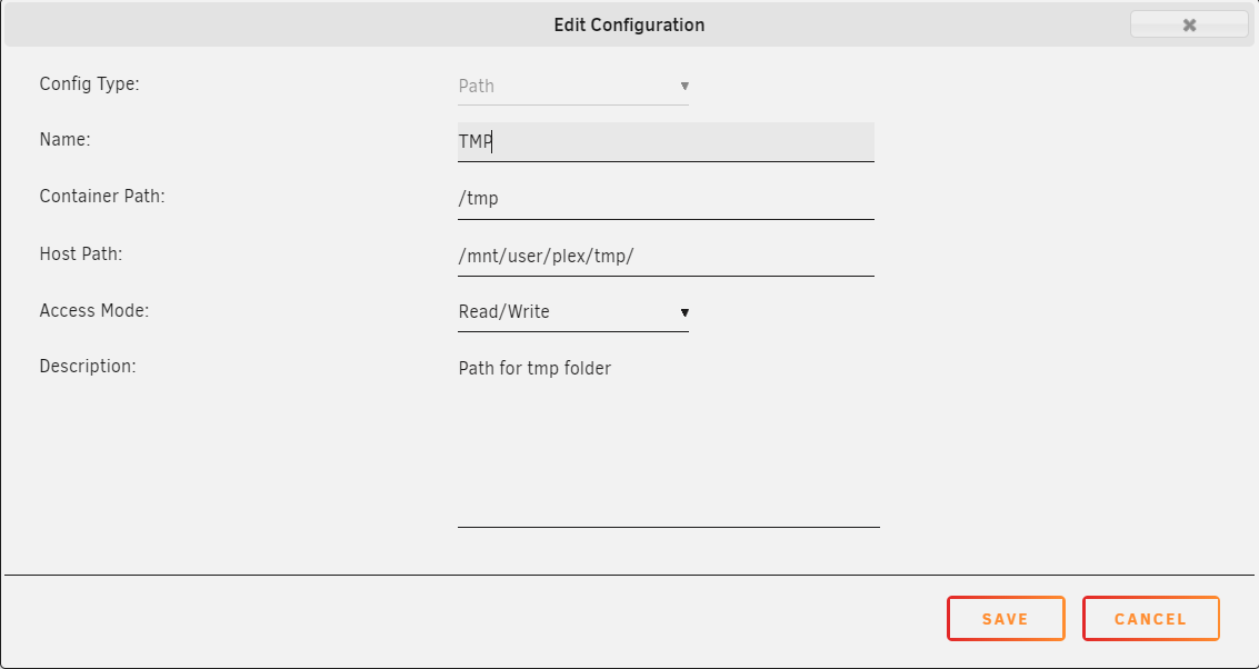

I also created an additional Path to /tmp that resides outside of the docker image, see below for my settings. I believe this will only need to be done temporarily until the real issue is resolved.

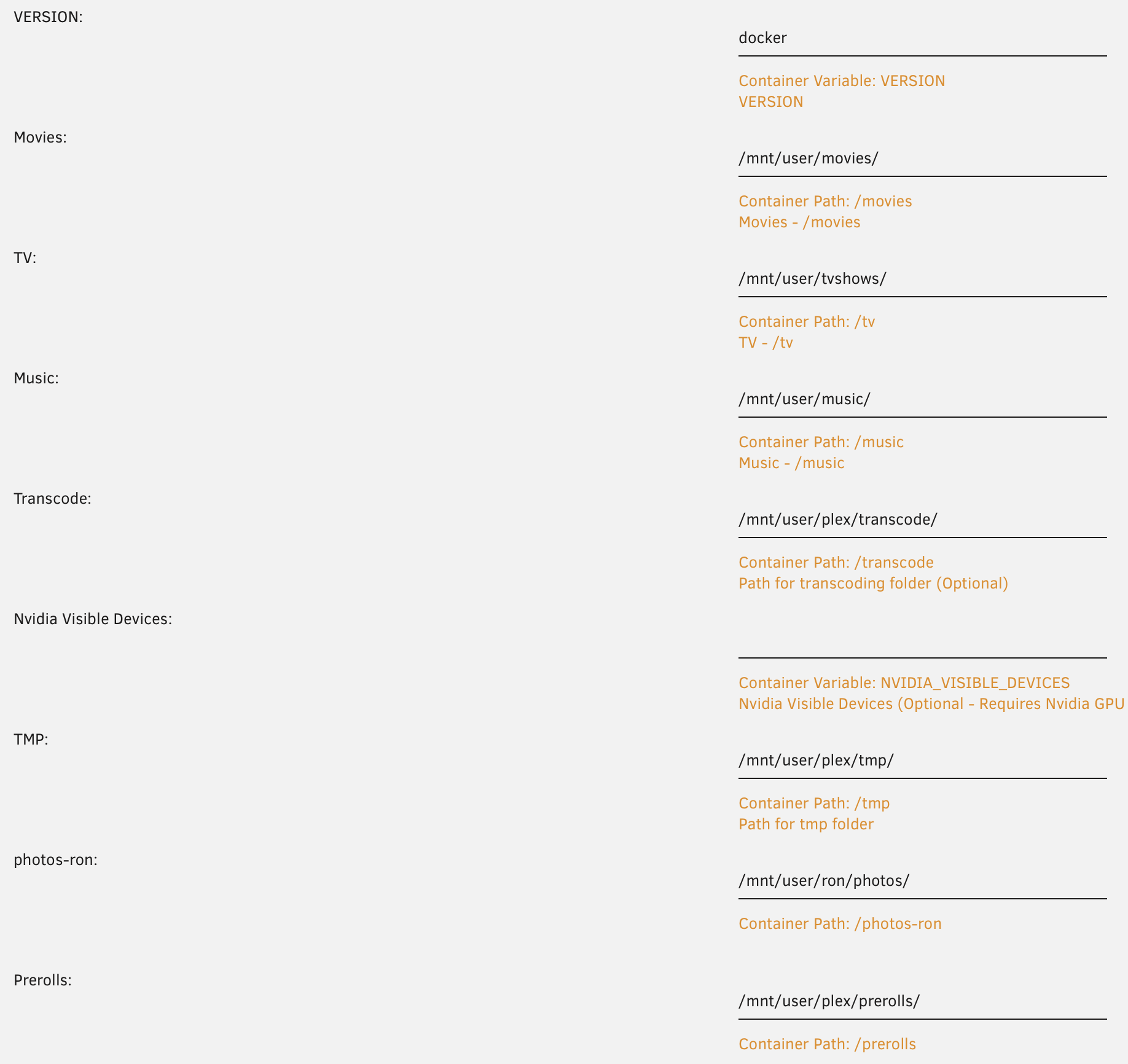

Post a pic of your Plex docker config file that shows all of your mount points. Lets start there and see if we can figure it our from there.
Notice the TMP and Transcode mount points are housed on devices outside of the docker image file and reside on the main array (or wherever you want them so long as not in the docker image file location). This keeps the docker image file from growing such as yours is now.
Here is mine for reference:
1570145502_Screenshot2023-01-31at3_29_02PM.thumb.png.23ae7f785e9a7b628087fc25d4d88a1f.png

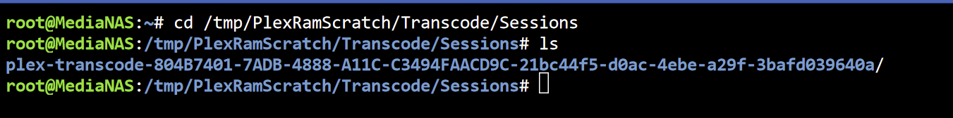

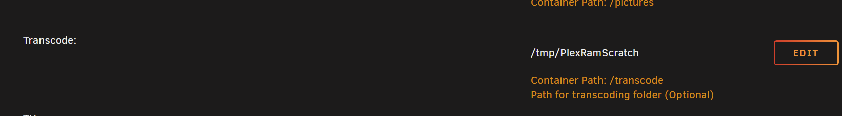

In my system, I transcode to /tmp/PlexRamScratch which has a size limit of 16GB.
While a movie is hw transcoding
I see this activity in the designated transcode location of /tmp/PlexRamScratch/Transcode/Sessions
Additional plex-transcode files are created as needed.

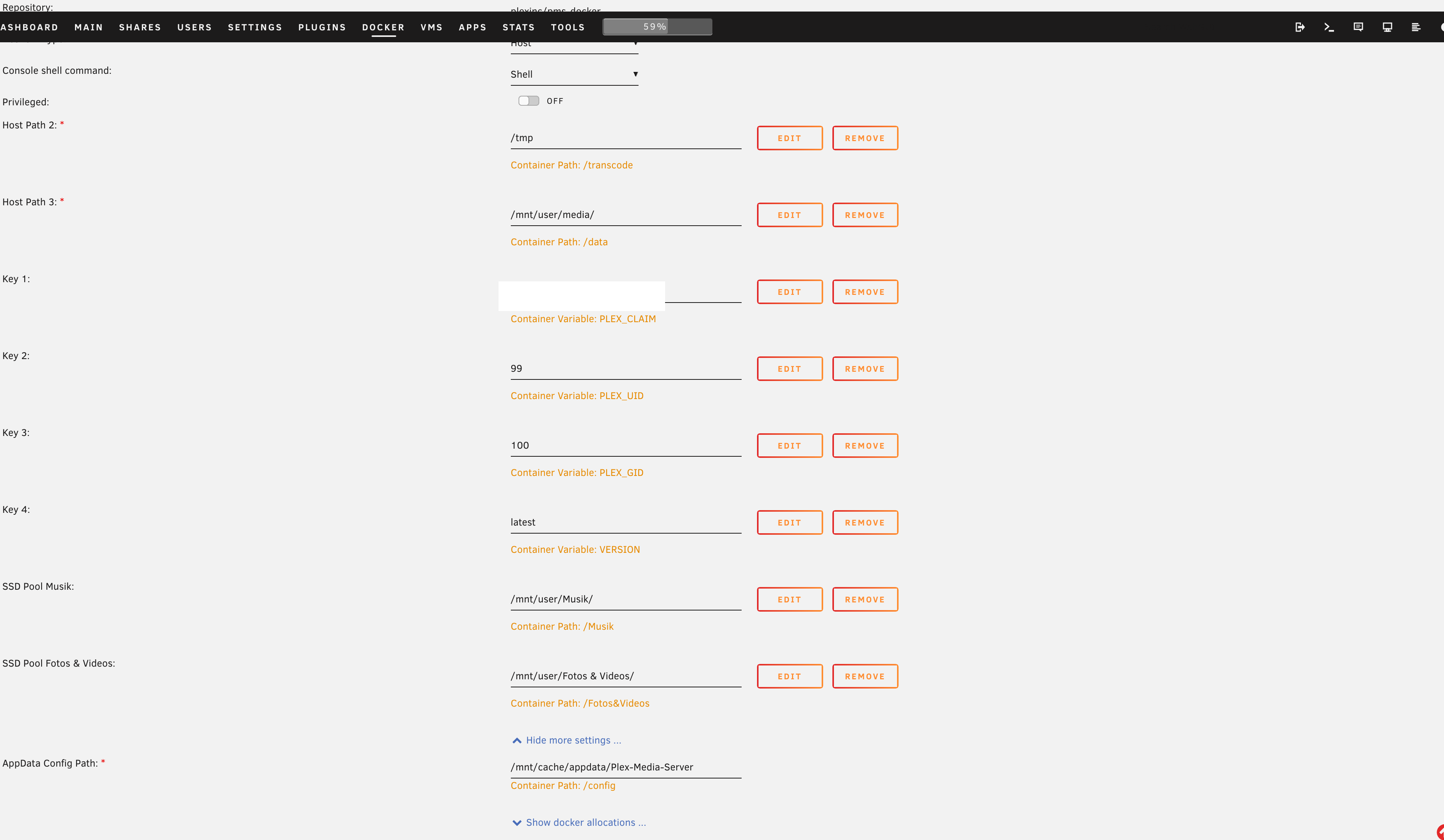

Thanks for the reply, I was busy during the day.
I have the feeling I'm using a different Plex Docker build 'cause mine doesn't look remotely like yours.
These are all the mounts I've been running
But just as a note, that I remembered now: Whenever I do transcoding, in this case it runs purely on the cpu side of things, I do not get the Issue with the filling up of the image. Funny enough
2063133495_Screenshot2023-02-01at16-52-30Server_UpdateContainer.thumb.png.965d0c762be5952d35394cc916cb9738.png
