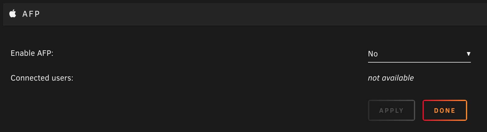

I tried once again this morning to get the Time Machine (via SMB) to work with 2 Mac computers. 1 running Mojave and the other running High Sierra, both with the same results. I create a share called 'Time Machine' or 'test-1', etc,. Assigned the following SMB attributes (export: yes/time machine, volume size: 60000 for 6TB, and security: private). When looking in either Mac's Time Machine properties, and attempting to add a new disk, the new share is not visible. However, if I mount the SMB share via Finder, Go, Connect to Server, then I am able to see and use the disk in Time Machine.
I have also tested using AFP. When creating the same type share via AFP, the following settings were used (export: yes/time machine, volume size: 60000 for 6TB, volume dbpath: empty, and security: private). When I go to browse for the share in Time Machine, I am able to see it. The issue comes when I try to mount it in the Time Machine settings. It takes in upwards of almost 20 or so seconds to 'connect' to the drive. When it does finally connect, I am prompted for my credentials, and then it errors out. Unfortunately, I did not capture any screen shots of the errors this morning. I will take care of that when ai get home this evening and post them.
So in summary, If I am not following the proper procedures when using an SMB share with Time Machine, please let me know. I am under the assumption that it will simply appear much like an AFP share. If others have been able to get this to work, please share your settings for not only creating the share but also how it is exported.

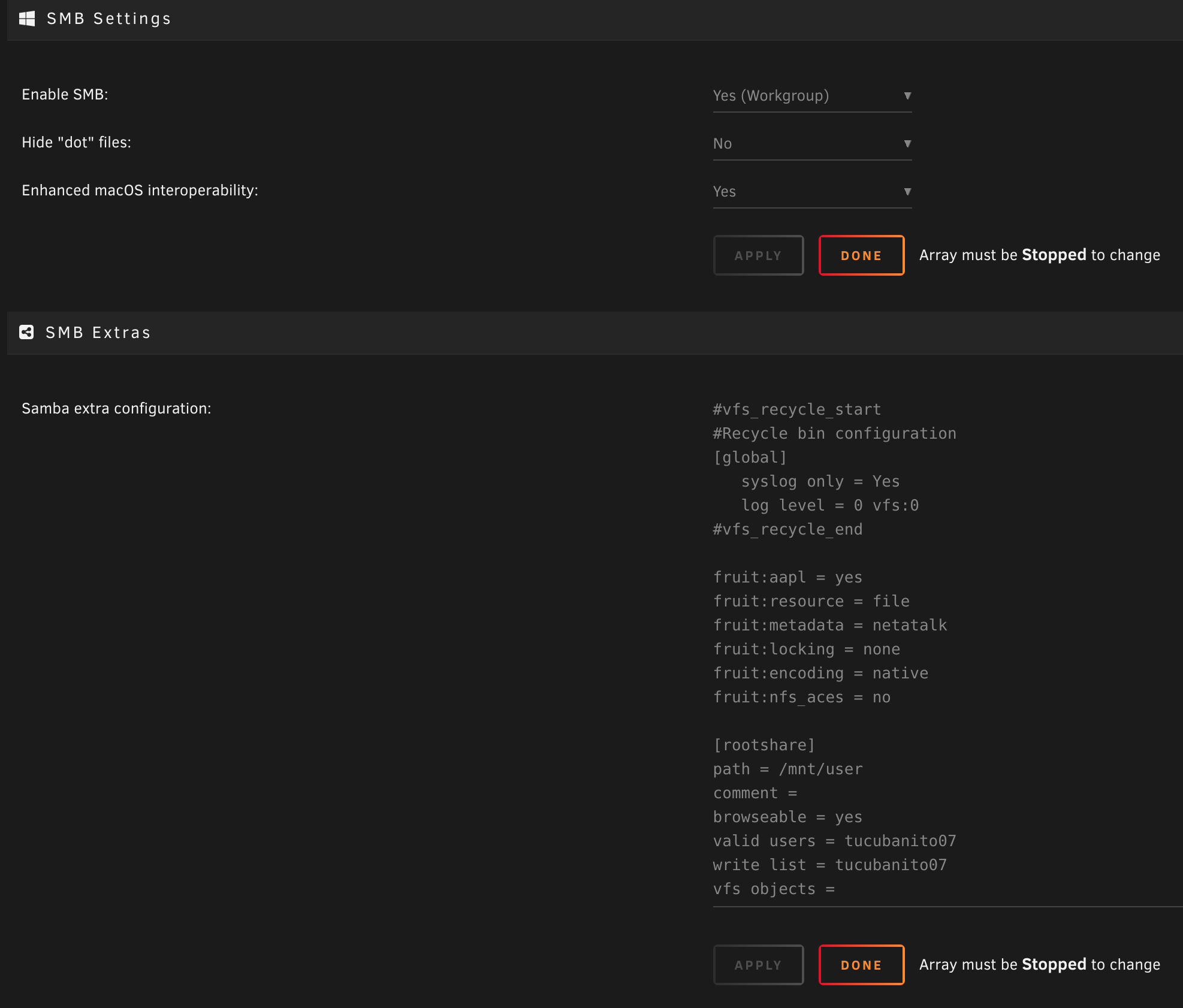

Is still not working for me. I did however just tired what you said with connecting to the server via finder and then it came up for me to use as a time machine backup. However, it just keeps timing out. It seems like it's on a timer for me and it stops backing up. @limetech What else can we try to get this to work? I tried all the settings you provided up top. I even moved the variables. See down below. I got the security set to public and Share name is time machine and export to yes/ time machine.
#vfs_recycle_start
#Recycle bin configuration
[global]
   syslog only = Yes
   log level = 0 vfs:0
#vfs_recycle_end
fruit:aapl = yes
fruit:resource = file
fruit:metadata = netatalk
fruit:locking = none
fruit:encoding = native
fruit:nfs_aces = no
[rootshare]
path = /mnt/user
comment =
browseable = yes
valid users = tucubanito07
write list = tucubanito07
vfs objects =
5 hours ago, mfwade said:

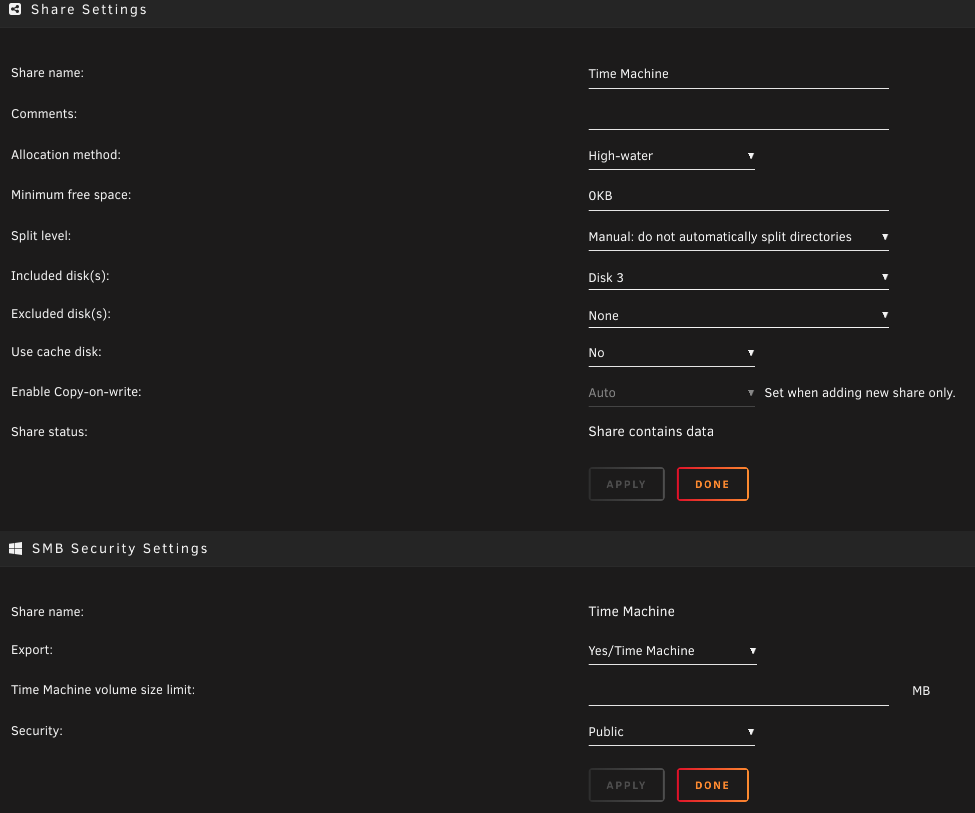

Maybe a permission issue.  As a test, set the Time Machine share security to 'Public'.

These are my current settings and last night the back up did not finish. @limetech
1287522540_ScreenShot2019-05-14at1_16_05PM.thumb.png.b9353c7c01ecfd6cb904ab9f3e8d5818.png1490485263_ScreenShot2019-05-14at1_15_45PM.thumb.png.0eca444b77c827de8946adc94651aabe.png1264807393_ScreenShot2019-05-14at1_15_32PM.thumb.png.e442a7bea0bfae015eee2e45641130dc.png
Edited by Tucubanito07
I thought you said you had "Enable SMB" set to Active Directory?  Maybe was someone else... in this case you don't need the extra fruit lines in the Samba extra configuration settings, but does no harm having them there.
You say it doesn't finish - so it does connect and run for awhile and transfer data?  Then what happens?  At this point, where backup has stopped but before you do anything else, capture diagnostics.zip.  Are you sure it's not something obvious, like running out of space?

Nothing jumps out but your 'rootshare' definition is troubling because it's missing something.  In the line that reads:
vfs objects =
change to:
vfs objects = catia fruit streams_xattr
And then reboot your server.
Maybe you are victim of this warning from the samba vfs_fruit doc:
Be careful when mixing shares with and without vfs_fruit. OS X clients negotiate SMB2 AAPL protocol extensions on the first tcon, so mixing shares with and without fruit will globally disable AAPL if the first tcon is without fruit.
If this doen't work then please get rid of everything past "#vfs_recycle_end" line - that is, remove the fruit lines and your rootshare definition.  Then if that still doesn't work, try a 'safe mode' boot to rule out a rogue plugin interfering.
vfs objects =
change to:
So based on the variables, what should i only leave in there? @limetech
#vfs_recycle_start
[global]
   syslog only = Yes
   log level = 0 vfs:0
#vfs_recycle_end
fruit:aapl = yes
fruit:nfs_aces = no
[rootshare]
path = /mnt/user
comment =
browseable = yes
#vfs_recycle_start
[global]
   syslog only = Yes
   log level = 0 vfs:0
#vfs_recycle_end
fruit:aapl = yes
fruit:nfs_aces = no
[rootshare]
path = /mnt/user
comment =
browseable = yes
Above looks correct for this test.

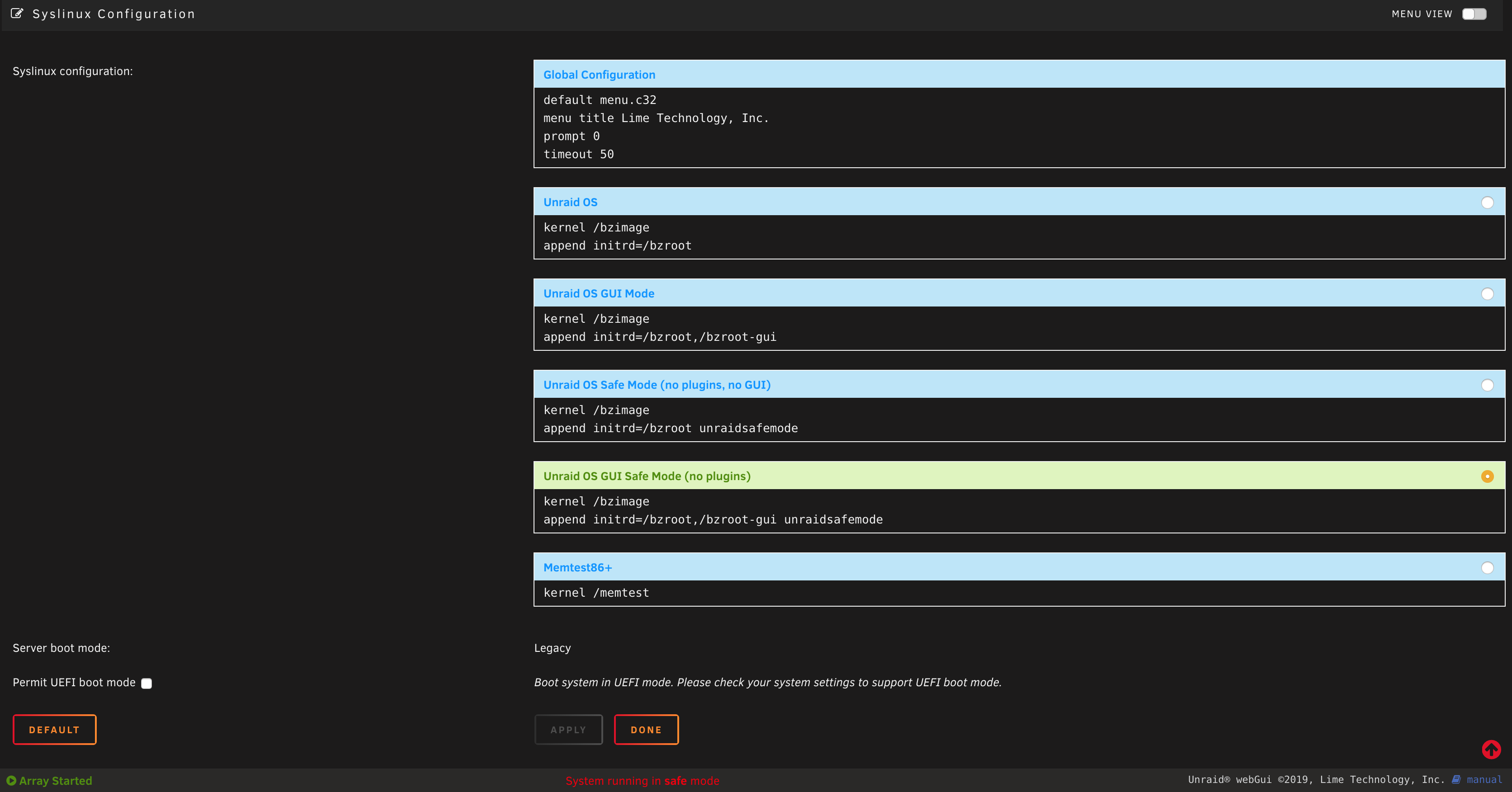

I did that and the same issue is happening. It starts to back up and then it stops. So now the only thing i have on there is this. @limetech
#vfs_recycle_start
[global]
   syslog only = Yes
   log level = 0 vfs:0
#vfs_recycle_end
I also just rebooted the server in Safe mode without the apps on GUI and still keeps happening. @limetech See screenshot below. I also took all the variables in the SMB under settings. The only one is the recycle bin. I switched it back to Unraid OS. I guess Unraid does not support Time Machine. Thanks for all the help.

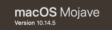

Your video link says "unavailable".  Also what version macOS is  your laptop running?

The video is public now sorry about that. I am running
That's one exciting video!

And you also need this the following in addition at the affected share section (not at [global]):
fruit:time machine = yes
Otherwise you won't see the affected share at Apple's Time Machine. But this can't be done at "Settings/SMB/Samba extra configuration" I assume !?
