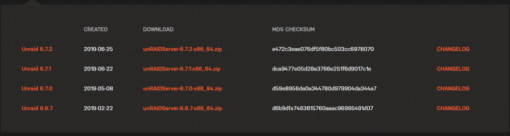

July 27, 20197 yr 36 minutes ago, superloopy1 said: I intend to rgress but how do i get back to 6.6.7 as my web gui only offers me 6.7 6.6.7 is still available for download on unraid.net
July 27, 20197 yr Thanks, i've now got it .... but i'm a complete novice at all of this and reluctant to start wiping the existing usb stick. Could try a new stick but isnt the key tied to the guid of the stick, how do i get around that one? Edited July 27, 20197 yr by superloopy1
July 27, 20197 yr 23 minutes ago, superloopy1 said: Thanks, i've now got it .... but i'm a complete novice at all of this and reluctant to start wiping the existing usb stick. Could try a new stick but isnt the key tied to the guid of the stick, how do i get around that one? You don't have to wipe the USB flash drive or lose your configuration. Just download and extract the 6.6.7 files to a folder and then copy all the bz* files over to the root of the unRAID USB flash drive. That downgrades all the important files. If you want to use a new USB stick, you can transfer the license to the GUID of the new flash drive. Limetech lets you do this once a year. Edited July 27, 20197 yr by Hoopster
