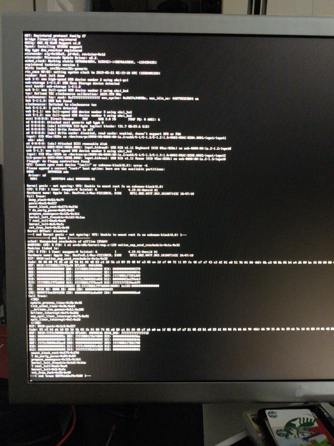

I'm glad I did a little bit of hunting. I have a Mac Pro from that same era. Officially a Mac Pro 2009, 4,1 flashed to work as a 2010/5,1. I have an identical kernel panic. By the looks of it, it has something to do with how the EFI passes off XHCI, which, mind, isn't something we can control. I'm going to try some tricks with Plop Boot Manager later, though.
The only thread I can find, mind you, talks about changing usb drives, and that fixed it for him. Sucks for us.

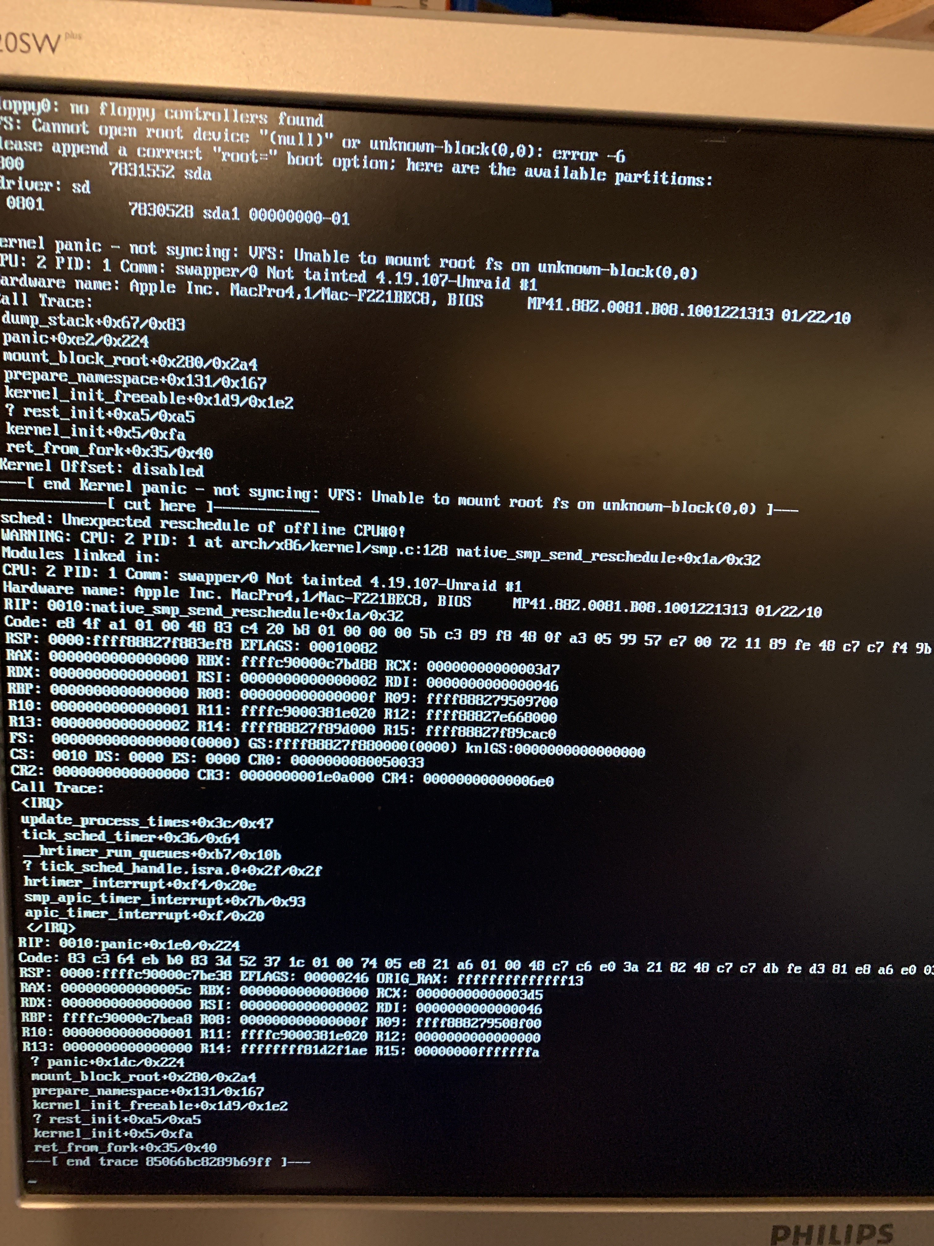

Update: I tried using rEFInd to boot in legacy mode, and it didn't help much. I even tried specifying things like root=sda1 or 0B01 based on the following and previous screenshots
I'm getting a device listed now, but I'm concerned I might just be seeing the macOS disk installed already, although it should have 3 partitions, not one.
I've tried multiple drives and multiple ports.

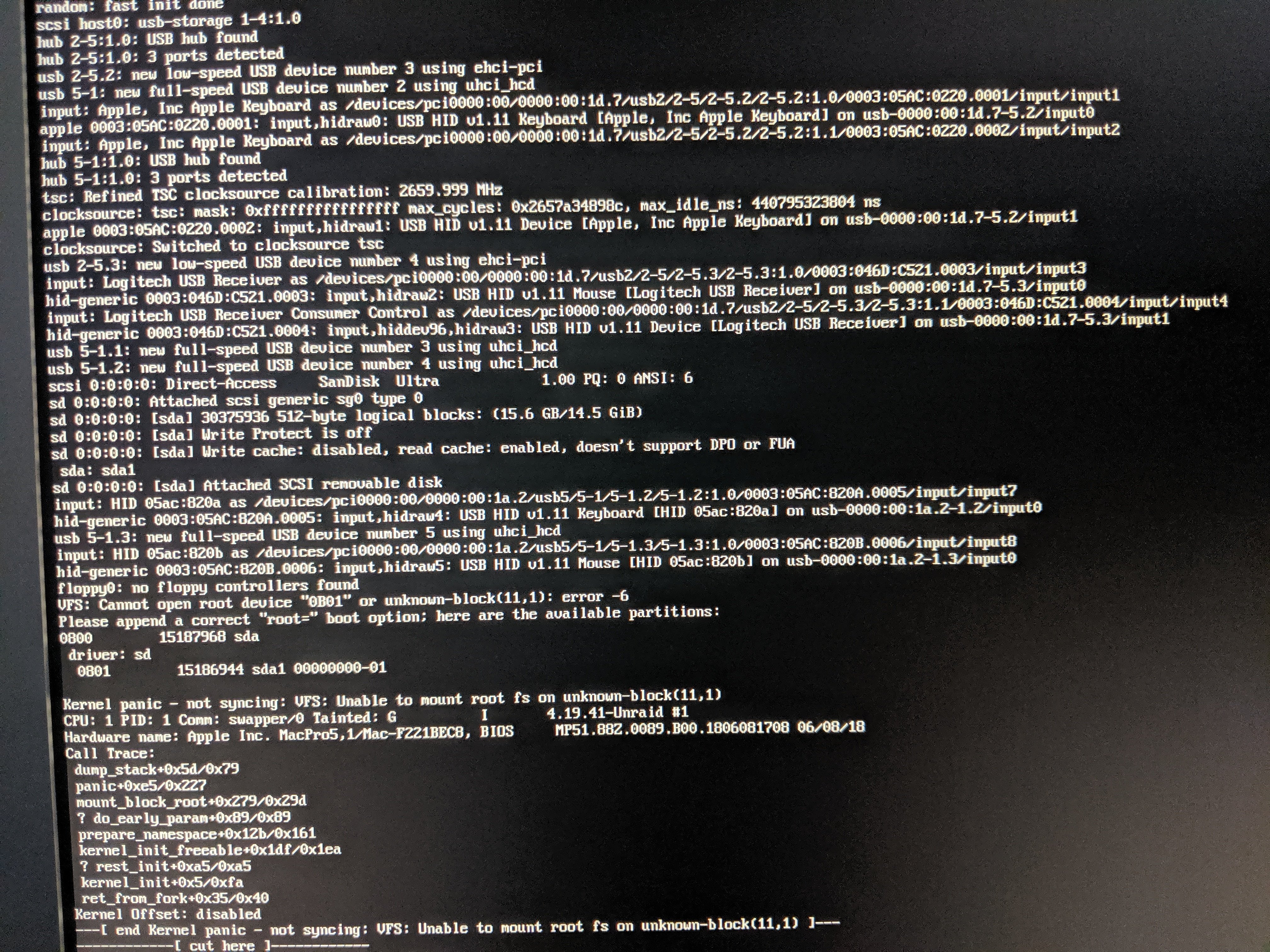

I went through the same like you did with my Mac Pro 4.1. It is now flashed with the latest firmware 144, but it still shows the same error.
I've tried to boot Fedora Live CD and another Linux distro, they all worked without issue. I do think this is unraid specific. I'm stuck and thinking of converting the Mac Pro into a PC.

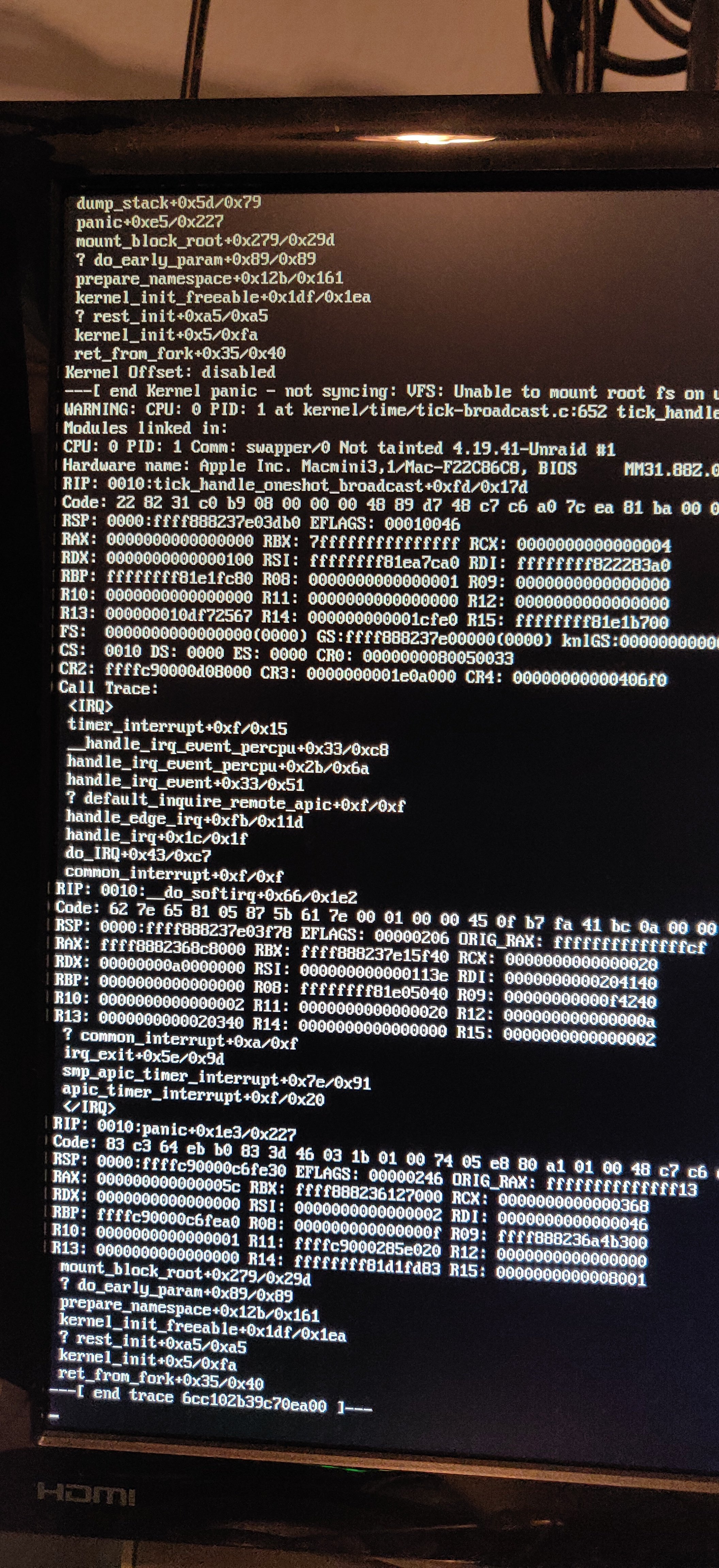

For what it's worth, I'm getting that exact same kernel panic on my 2014 MBP 13", 2009 MBP 15", and 2009 iMac. I know Unraid can be booted on a Mac (https://youtu.be/kdnL5_y0Jak), but I've yet to see anyone else reproduce it.
