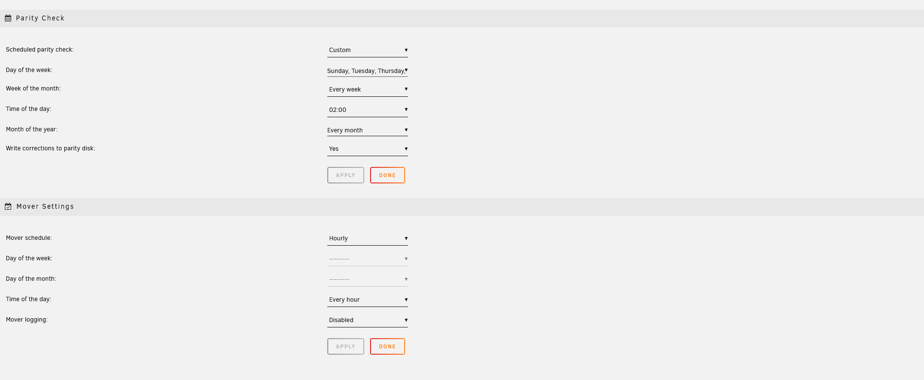

Those parity check settings are excessive. Most people only do a monthly parity check.  Unraid parity is maintained real-time so there is no need to "check" it frequently. It is only a check and not needed to keep parity in sync. And you should set it to not write corrections on the automatic parity checks. Only write corrections after you get parity errors and determine there isn't some other cause for the parity errors.

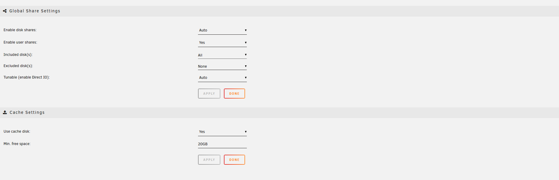

Those mover settings are also excessive. Your appdata, domains, and system shares should be set to cache-prefer, not cache-yes as you have them. You have a couple of other shares that are set to cache-prefer. This is almost certainly the wrong setting for those shares and they should be cache-yes instead, or cache-no in your case since your cache is so small. You probably do not understand the use cache setting. See here:
https://forums.unraid.net/topic/46802-faq-for-unraid-v6/page/2/#comment-537383
Probably you are filling cache and/or running mover all the time and/or running parity checks all the time and these are the cause of your problems.
Start the array and get new diagnostics.
OK. Now I can see which disks your shares are on, and they will require some work to get them where they should be.
Go to Settings - Docker and disable the docker service. Also, go to Settings - VM Manager and disable VMs.
Set appdata, domains, and system shares to cache-no temporarily. This is so we can get your other shares moved off cache and make room for them.
Set all your other shares to cache-yes and run mover. Wait for it to complete then post a new diagnostic.

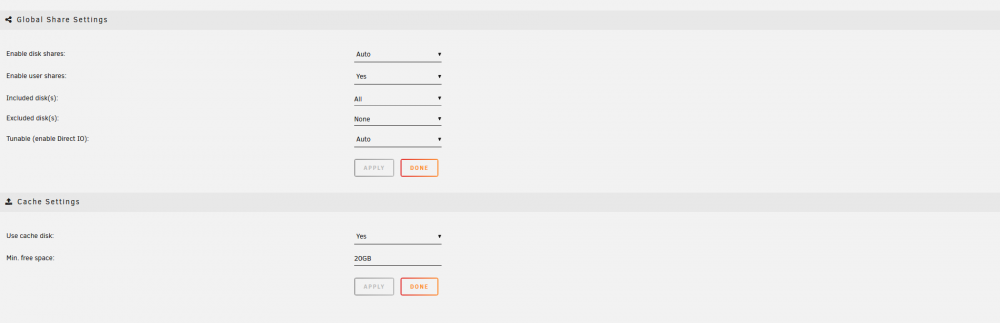

Another point is that my cache disk shows me a writing speed from 23 Mb\s but my windows 10 pro shows me 5 Mb\s? Where is the Problem?

So now I have set the moving/parity scheduler to weekly and monthly.
Most people leave the mover schedule set to run at the default of daily in the early hours of the morning when the system is likely to be idle.      Weekly does not feel frequently enough.   As you have a small cache disk if you want more control over when mover runs you could install the Mover Tuning plugin.
Monthly (or longer) for the parity check is a frequently chosen setting by many.

Your appdata, domains, system shares are all on cache where they belong now. Set these shares to cache-only.
Your isos share has files on cache. Set it to cache-yes, run mover, then set it to cache-no.
Set all other shares to cache-no.
Enable docker and VM services.
With these settings it shouldn't ever have anything to move. I don't recommend using your small cache for caching user share writes and just keep it for dockers and VMs to use with the appdata, domains, system shares.
After you get an idea how much space things are going to use on cache, and an idea how much downloading you are going to do, you can reconsider this. Trying to cache a lot with frequent moving is really self-defeating since mover and other writes are just going to compete for the disks, so you are better off just writing directly to the array.

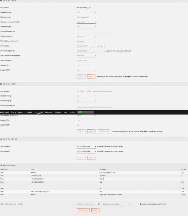

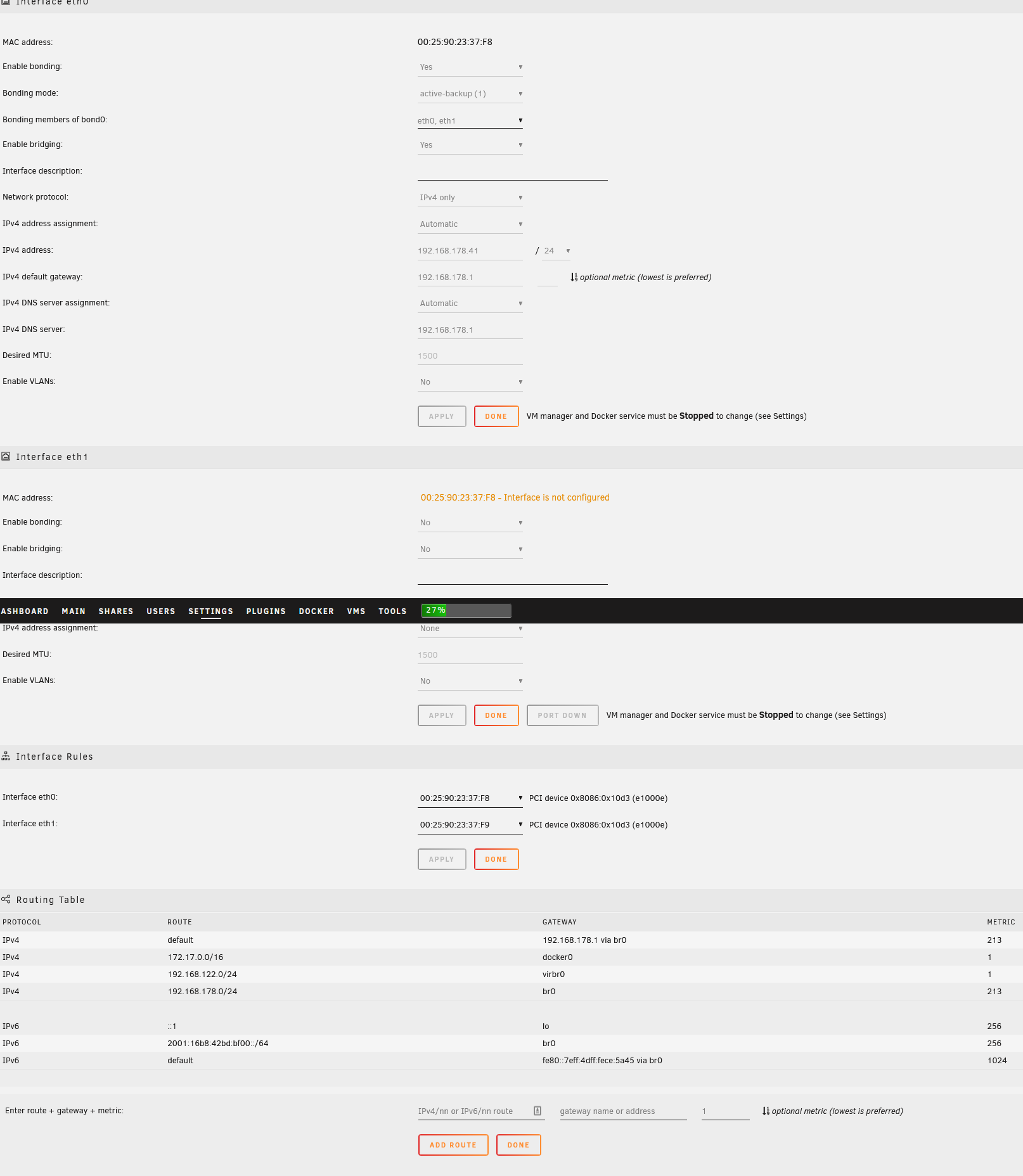

Try default network settings by deleting config/network.cfg on flash then see how things are working.
I set the network already on default and it happened nothing. But what does that means?

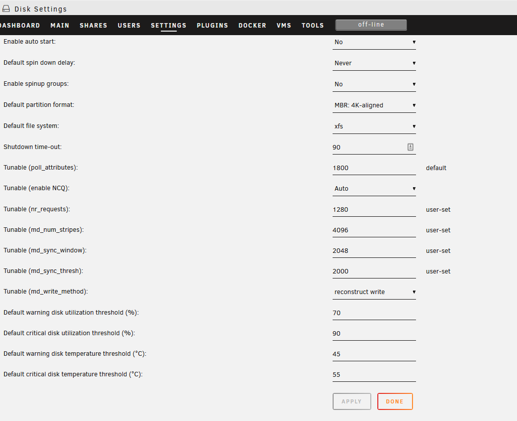

ethtool is showing 100 instead of 1000. If you are sure you have gigabit ethernet then check all cables and ports both ends.
oh yes you are right thanks ...
