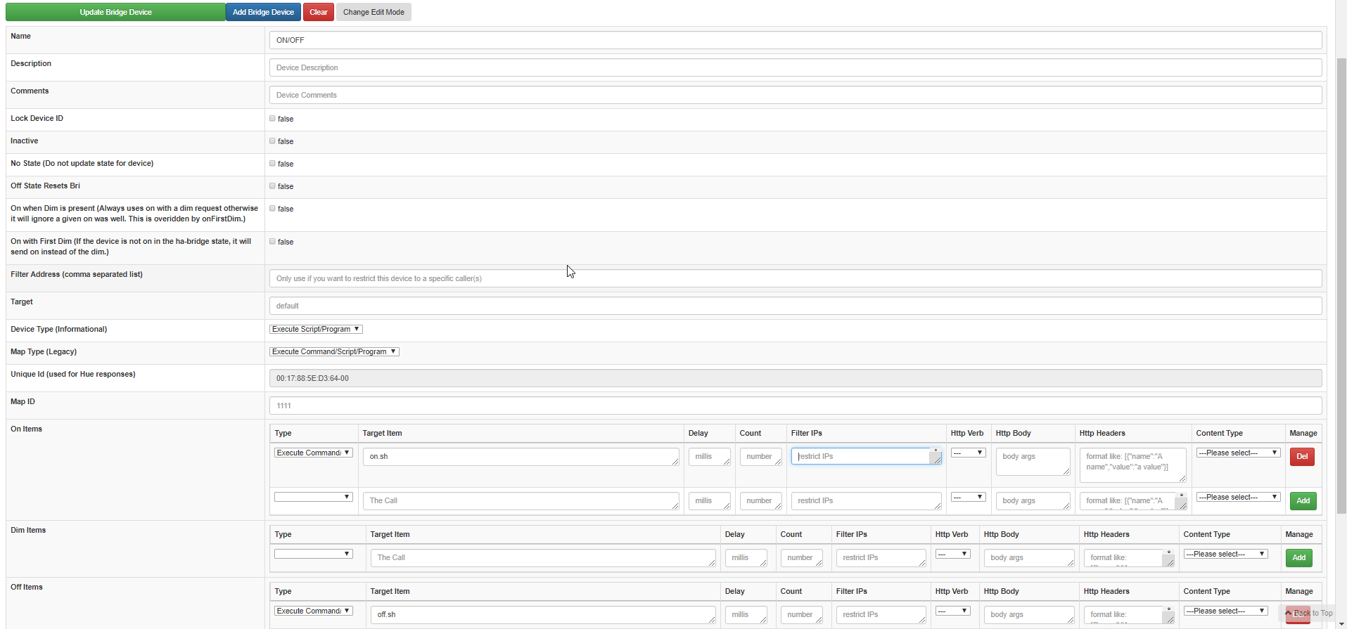

November 9, 20196 yr Hello, still trying to make things work. I'm simply trying to call a script in the folder /configs/scripts/ But I get the following error: The script contains the following content and does work when I execute it from the container's console: Thanks in advance!
November 11, 20196 yr Has no one an idea? This kind of script ran without a problem on the aptalca/docker...
November 11, 20196 yr 9 hours ago, pappaq said: Has no one an idea? This kind of script ran without a problem on the aptalca/docker... Post your script and people might see what the issue is. You have of course made the script executable?
November 14, 20196 yr On 11/11/2019 at 9:31 PM, saarg said: Post your script and people might see what the issue is. You have of course made the script executable? I posted the script as a picture in the initial post...and yes, it is executable.
November 14, 20196 yr 2 hours ago, pappaq said: I posted the script as a picture in the initial post...and yes, it is executable. You mean the picture of the ssh command? That is not a valid script. You haven't used the shebang. The script should start with #!/bin/bash

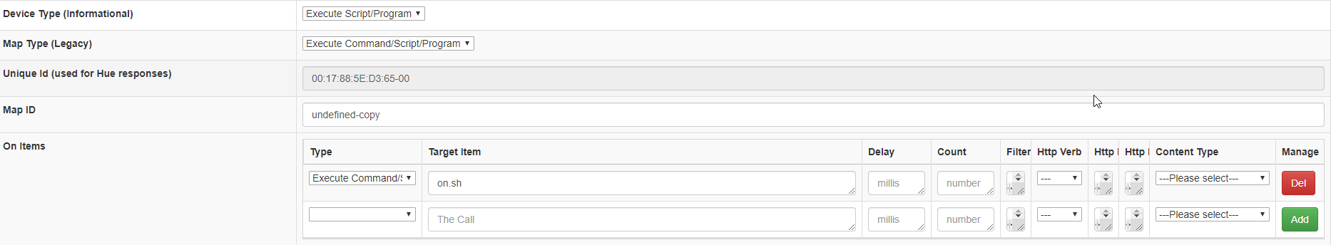

November 18, 20196 yr On 11/14/2019 at 10:35 PM, saarg said: You mean the picture of the ssh command? That is not a valid script. You haven't used the shebang. The script should start with #!/bin/bash Ok, that was one dumb failure of me...in my other scripts I have #!/bin/bash at the beginning... Now some more content to explain my last problem to get this working again: I've got the following scripts to enable and disable my ambilight based on hyperion on my TV: on.sh #!/bin/bash ssh [email protected] "sudo systemctl start hyperion" which enables the ambilight. off.sh #!/bin/bash ssh [email protected] "sudo systemctl stop hyperion" which disables the ambilight. These work from the commandline of the habridge docker. I've copied the SSL keys to the ambilight raspi and all works well. But with the below config the scripts are not executed properly. Does someone have a clue what I'm missing here? Thanks in advance!
November 19, 20196 yr 12 hours ago, pappaq said: Ok, that was one dumb failure of me...in my other scripts I have #!/bin/bash at the beginning... Now some more content to explain my last problem to get this working again: I've got the following scripts to enable and disable my ambilight based on hyperion on my TV: on.sh #!/bin/bash ssh [email protected] "sudo systemctl start hyperion" which enables the ambilight. off.sh #!/bin/bash ssh [email protected] "sudo systemctl stop hyperion" which disables the ambilight. These work from the commandline of the habridge docker. I've copied the SSL keys to the ambilight raspi and all works well. But with the below config the scripts are not executed properly. Does someone have a clue what I'm missing here? Thanks in advance! My guess is that you add it as root when you do a docker exec -it habridge bash? You need to add the keys for the abc user. The home folder for abc is /config.
November 19, 20196 yr 2 hours ago, saarg said: My guess is that you add it as root when you do a docker exec -it habridge bash? You need to add the keys for the abc user. The home folder for abc is /config. Ah that sound logical. In the deprecated habridge docker that was not the case. I've changed it and will try it out this evening. Thank you!
November 19, 20196 yr Thanks so much saarg. Pretty standard rookie mistakes but I'm learning so much from guys like you. Thanks for the support! It runs as expected!
