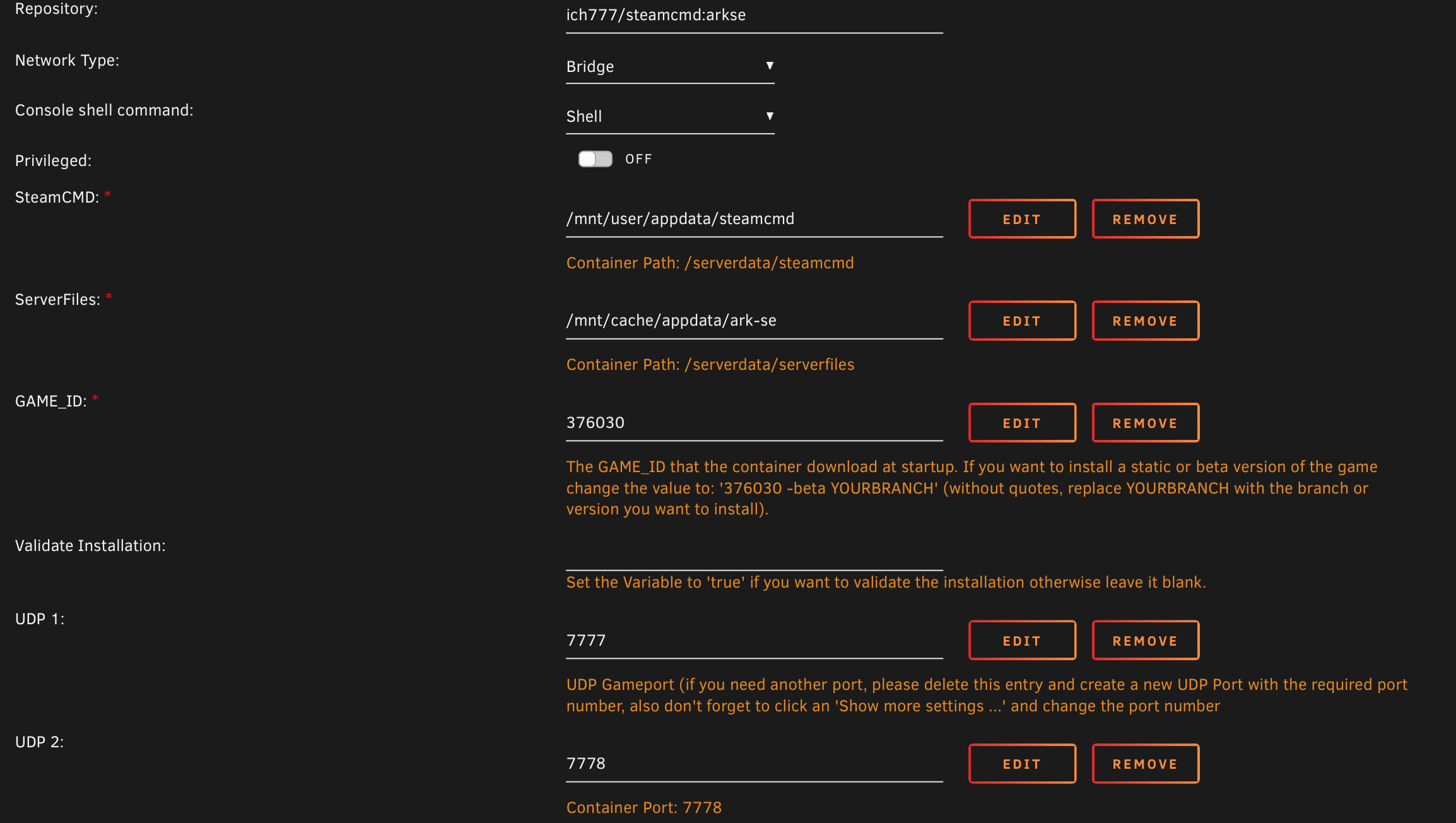

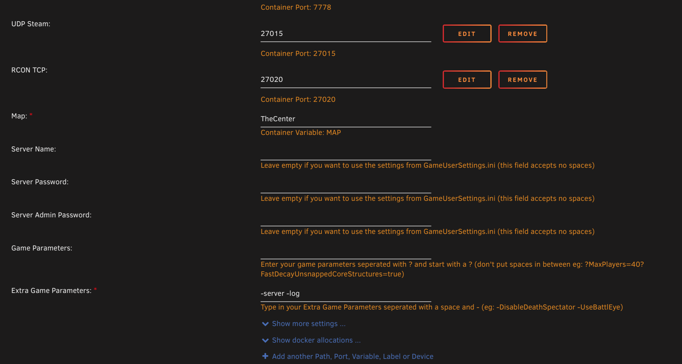

  2. Hi all, Trying to set up an ARK server but run into issues configuring it. Starting up with the default GameUserSettings.ini works fine, server can be joined remotely so ports are all good and everything. However, changing minor things like a value in the GameUserSettings.ini makes the server reset it to default when the server is started. As an example, just leaving name and password blank in the docker container and adding them in the GameUserSettings.ini does not stick - it will start as ARK #12345 or similar default name. When changing numeric values in GUS.ini, it seems like some stick, some get reset to default. Anyone encountered this before? Im out of ideas. Name and PW can obviously be set in docker config, thats fine - but other game related settings are important in the GUS.ini Docker settings are pretty much default, attached. Thank you for all the server dockers, I appreciate any help on this

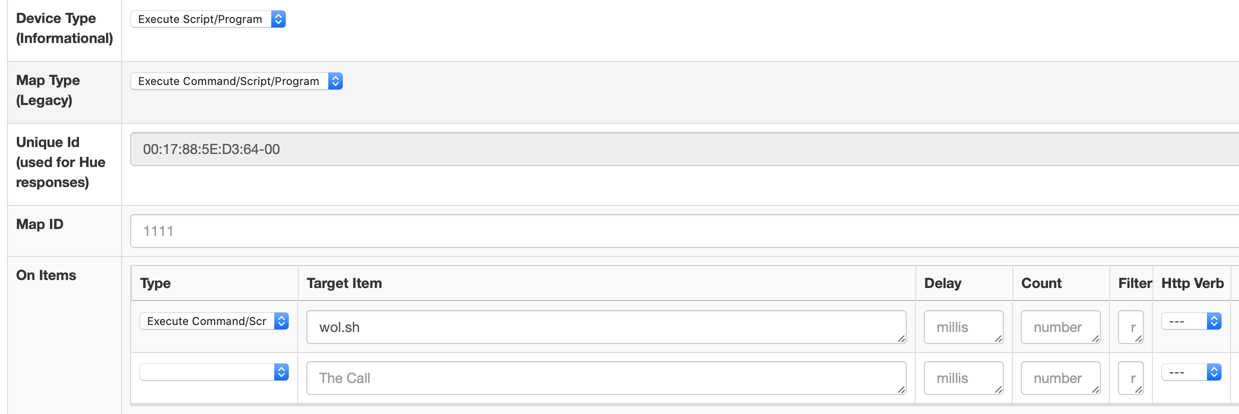

  9. To make sure it's not a permission issue, I've set it to 777. It is located in /config/scripts, which should also be correct - if I remove it from there and run "on" as a test in habridge, I get a red error message instead of the green success one, with the log telling me that the file doesnt exist. Edit: Meh. I just ended up using Domotcz, creating a button in there that does what I need and call that via habridge instead of straight through habridge. Works for me.
  10. Hi all, I seem to be having a similar issue - im trying to run a simple script to wake a VM via lan. This docker has ether-wake and running the command (and the scrpt) from the docker terminal wakes it up as intended. Running the script via habride on command does not work though - I am getting a green message of success when testing it, however the script doesnt seem to run. To see if it runs at all, I added a touch command to check the scrips dir after testing: #!/bin/bash ether-wake 52:54:00:af:3a:8f touch test I know it's probably a stupid mistake on my end, can anybody let me know what it is :) Script runs fine from the docker terminal, wake the machine and creates file test. Via habridge, it does neither.
