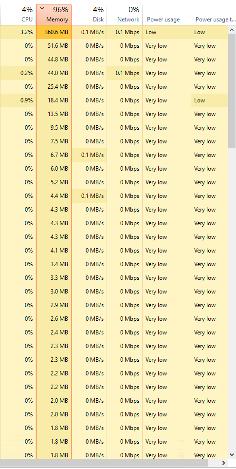

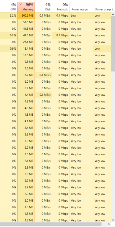

I am scratching my head on this one. I stood up a Windows 10 VM with 8 gigs of RAM and it was always at around 7.5 gigs used out of 8. So I increased it to 10, and it's now always at 9.6 out of 10. I really am not doing much on here. So I started digging around and the numbers do not add up for my RAM usage.

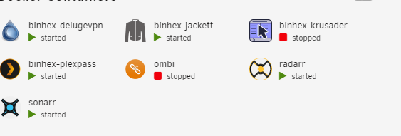

I saw a post somewhere that the docker containers would be occupying all of that space, but why is it being taken away from my Windows 10 VM? Nor do I have that many containers running:

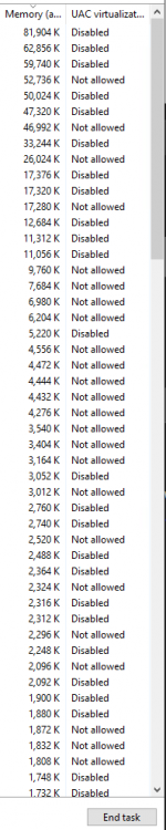

When I look in the task manager of the virtual machine,  I can see not allot of memory is been used. But it says 69% is already in use:
When I open a few more things the VM just freezes and becomes unresponsive. While I think it still has allot of memory in spare. What can I do to solve this?
