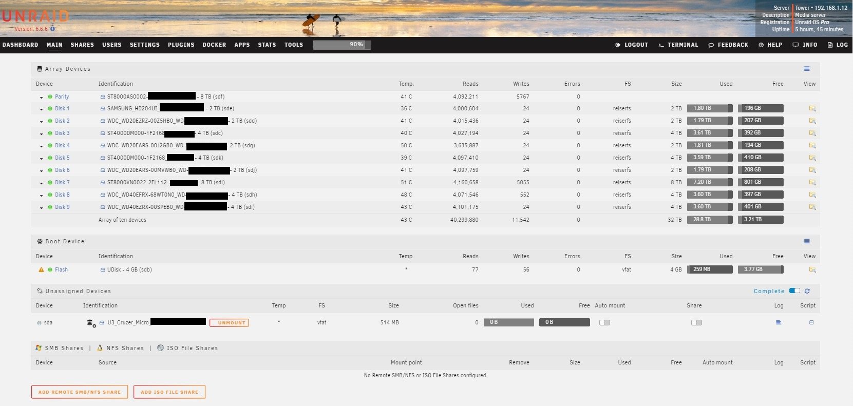

Also, parity check is now under way,, but it shows to have detected the 4 GB key

Those diagnostics and your screenshot seem to indicate it is mounting the correct flash partition /sdb1 at /boot, and that is where it is getting the license key. But it is still unclear (to me at least) which flash it is actually booting from. I assume it is booting from the old flash. Those diagnostics don't show /sda1 mounted unlike your screenshot. Presumably you mounted it manually in UD earlier.
I would agree with you that is booting with the old flash. When I upgraded the new key, it stopped booting half way with a number of error messages. I really want to fix this setup so I only have a key, or I would even be happy with booting from one of the disks?
