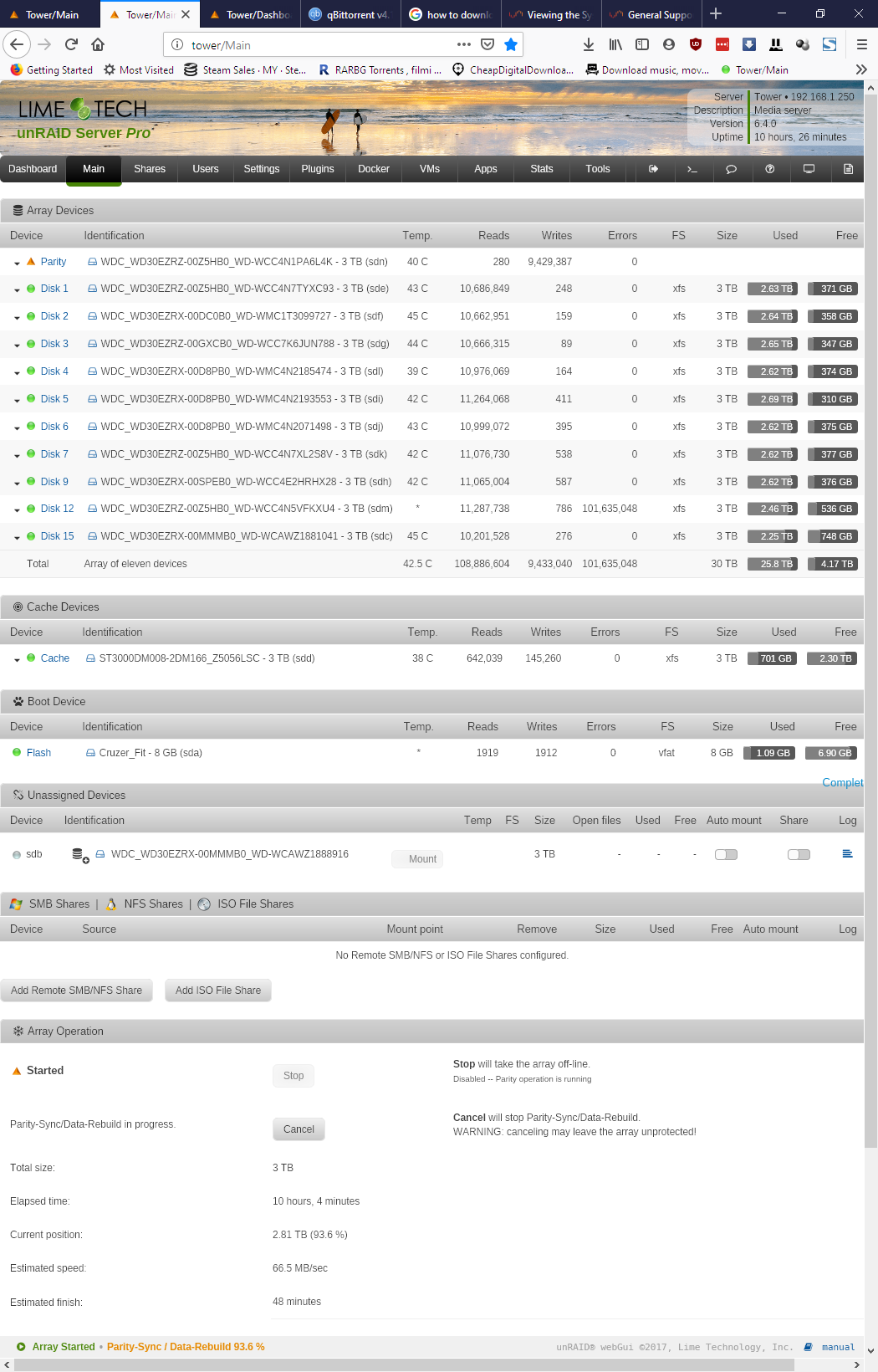

Drive 12 have error. so i replace drive 12. after few hours, i successfully build drive 12. then parity drive error. so i replace parity drive. this happens when i rebuilding parity drive. attached logs.

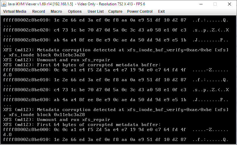

its much worst now. i see this messages non stop.
That's filesystem corruption on disk12, if you can't get the diags get the SMART report for disk12, also is disk12 still enable (green icon)?

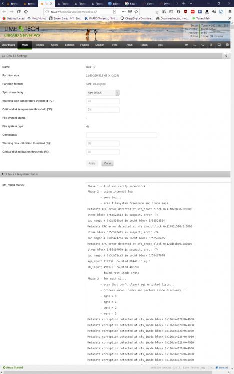

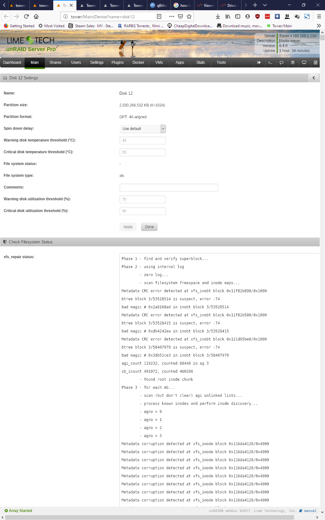

This time, i run the check filesystem with -nv
No point in running xfs_repair on the emulated disk, there will be a lot of data corruption because parity isn't valid.
