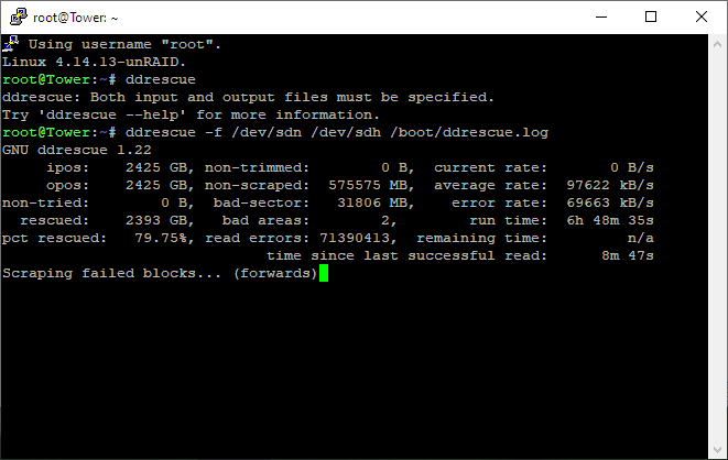

This is current progress.
The number for bad sectors are increasing. Rapidly.
This is the progress seconds later.
Is it normal. Is ddrescue still doing its thing? Should I stop it? Let it continue?

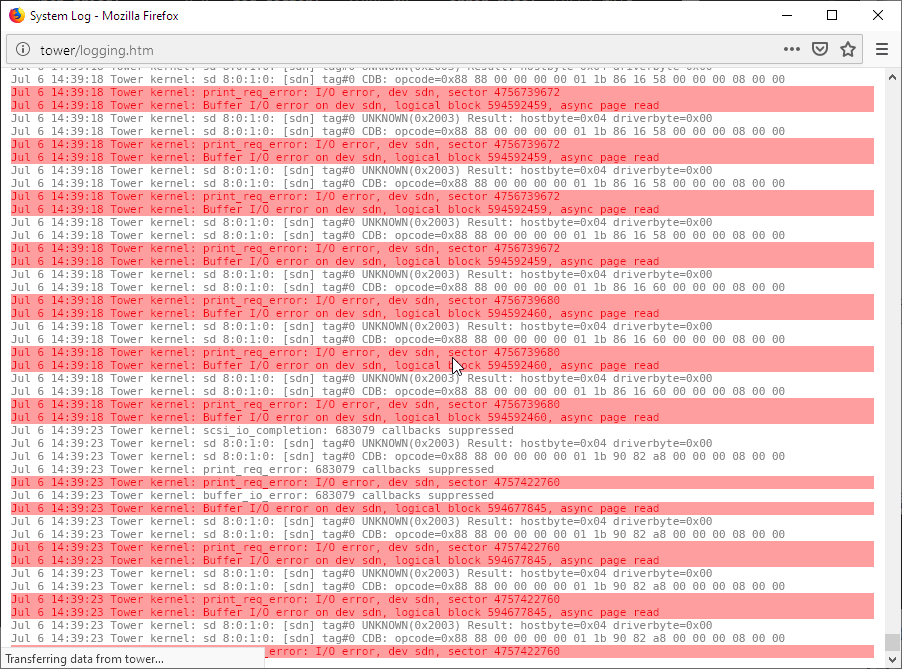

The system log doesnt look promising either.
Disk is in worst shape than it looked, but let it finish, still best option to get as much data as possible, it can take some time because of all the errors.

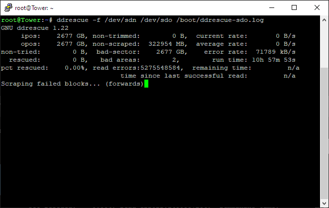

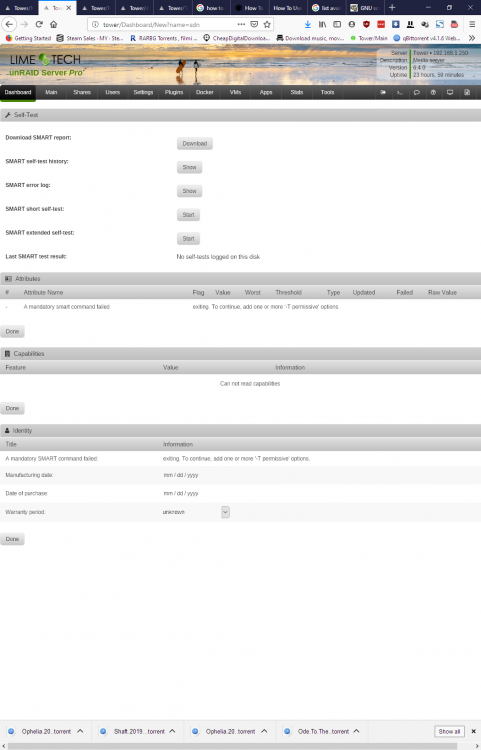

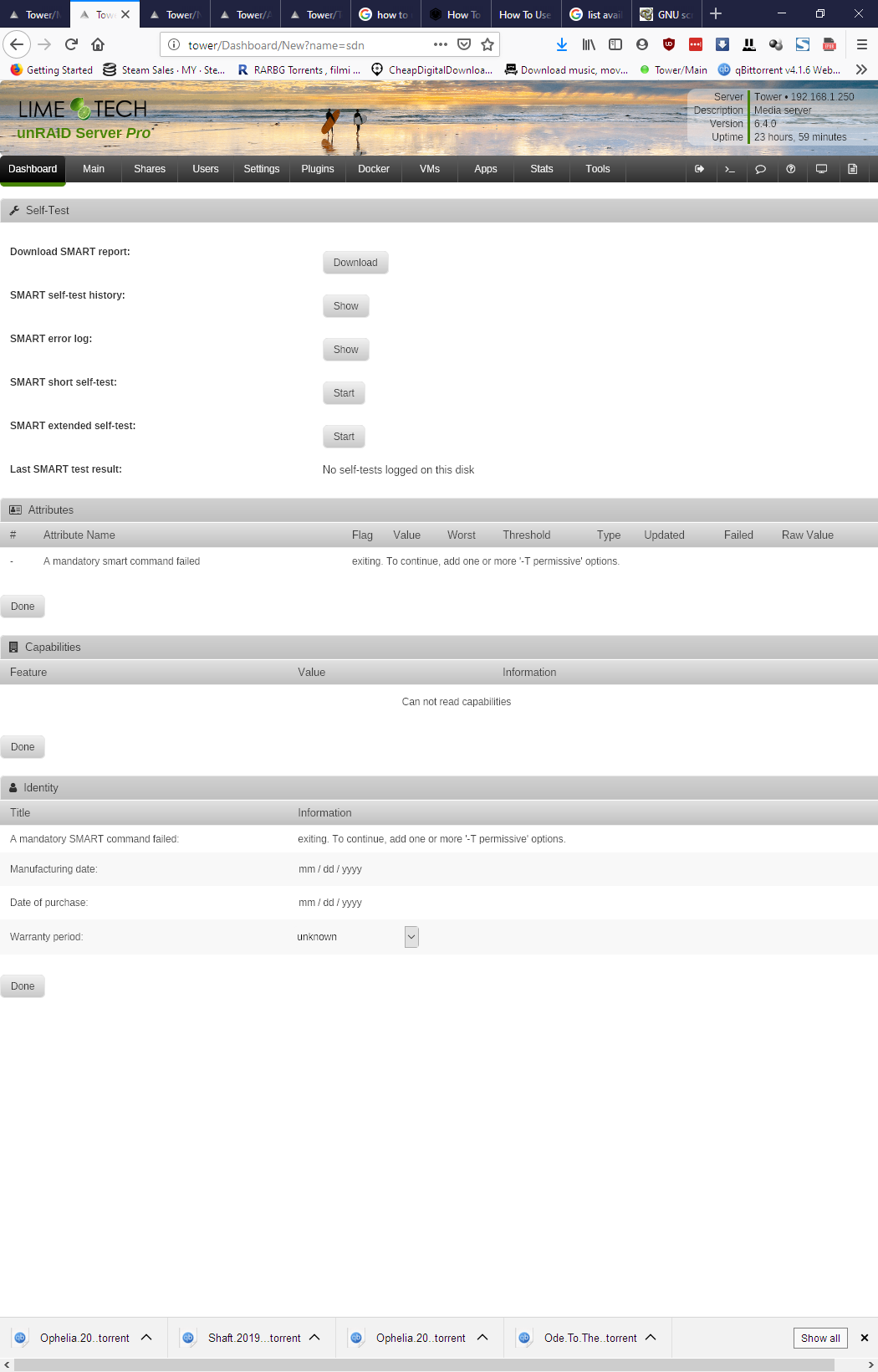

Did ddrescue complete it tasks? should i run it again? the drive doesnt look good either. i cant even see the status of the  drive in unraid webgui. what would you do if you were me?

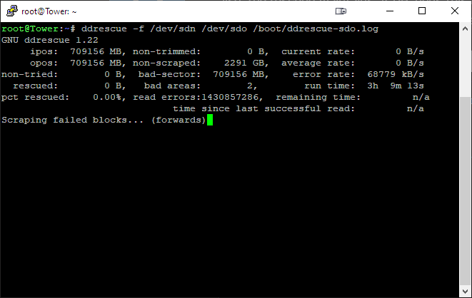

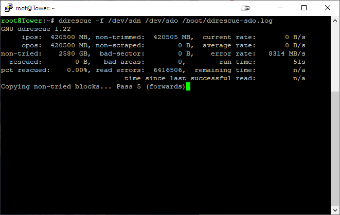

i tried ddrescue again but with different destination drive. it starts with Pass 5. does this mean that the previous run stopped at pass 4 or pass 5 and ddrescue resume the tasks?
also, the rescued maintains at 0B. does this means that my drive is totally dead and i should just give up and just use the data recovered in the first drive? should i rerun ddrescue on the first destination drive and not change the destination drive?
after few hours.
my latest state.
should i let it continue or stop?

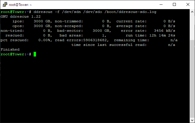

ddrescue has completed.
seems to me the second time i run ddrescue the drive is totally dead.
whats next?
You cant use a different destination and the same log, since it will resume the recovery but the there's noting on the new disk to resume, since now you can't resume to the initial disk you'd need to start over with a new log file.
