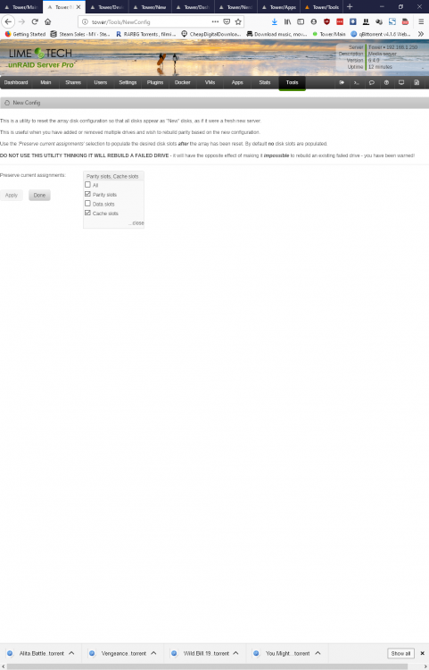

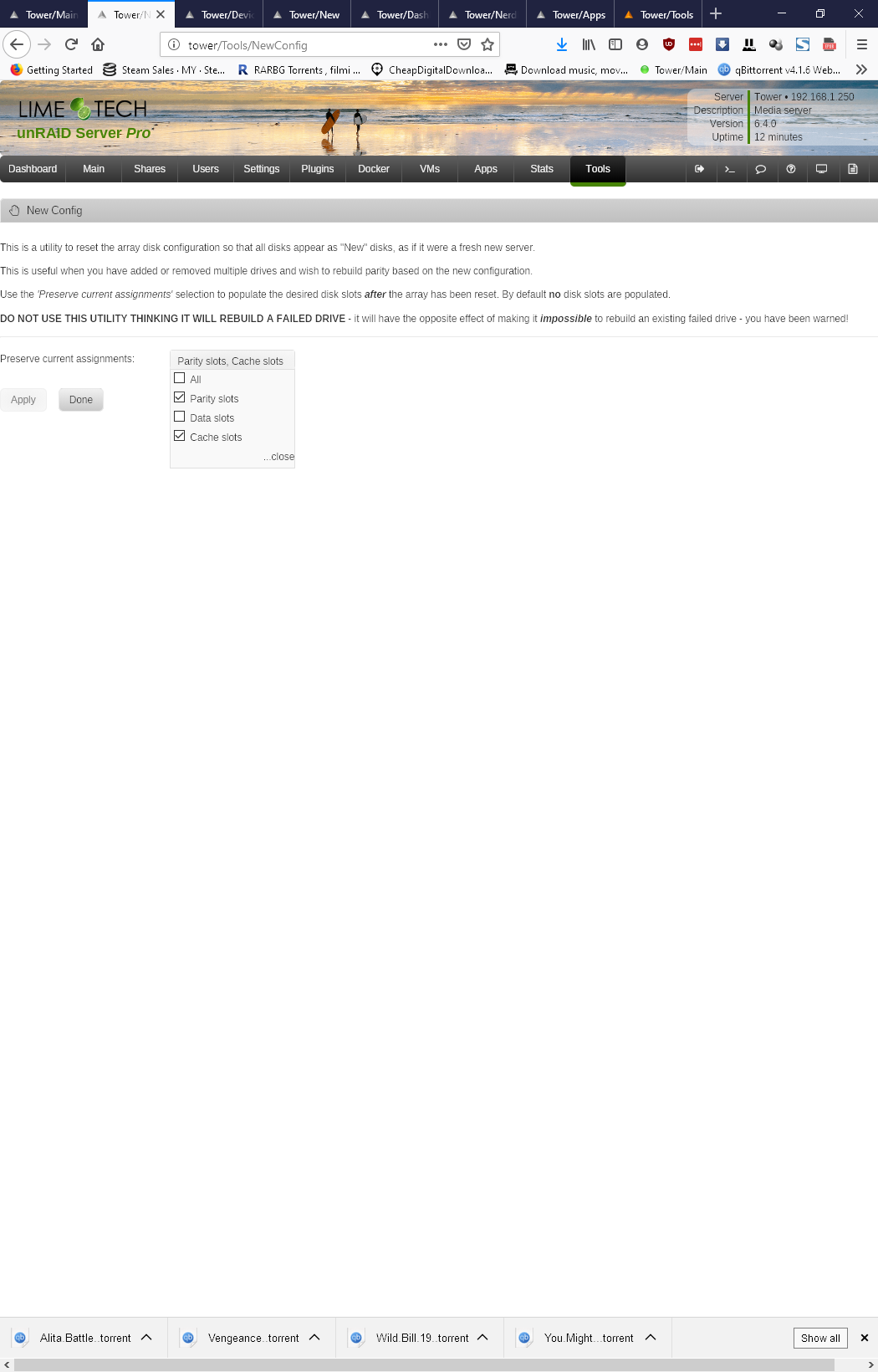

1 minute ago, trurl said:
New Config
Preserve current assignements. What should I choose? none?
  • Replies 79
  • Views 7.9k
If i choose none, i should know to put which drive in which slot right? at least cache drive on cache slot. data drive can be on any data slot. parity drive should be on parity slot.
is my assumption correct?
Edited by publicENEMY
All.
It will let you change any assignments before starting. You just need to change the disk12 assignment. Then it will rebuild parity (if you don't check the box) based on the new assignments.

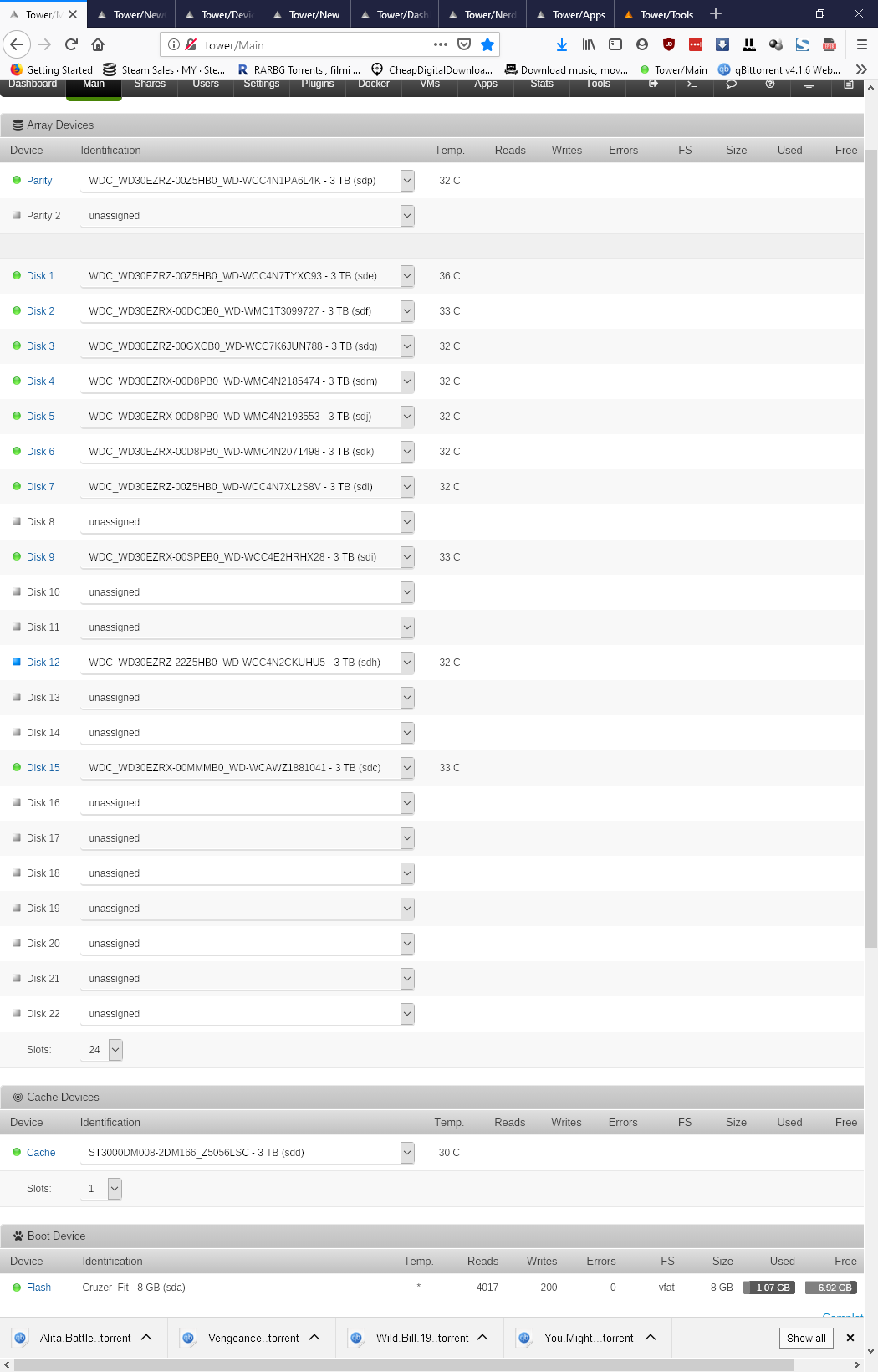

something is wrong.
i change some of the data drive slots and now i think the drive is out of array.
should i
1. new config
2. preserve current assignmet
 check - parity
 check - cache
 uncheck - data
What should I do?

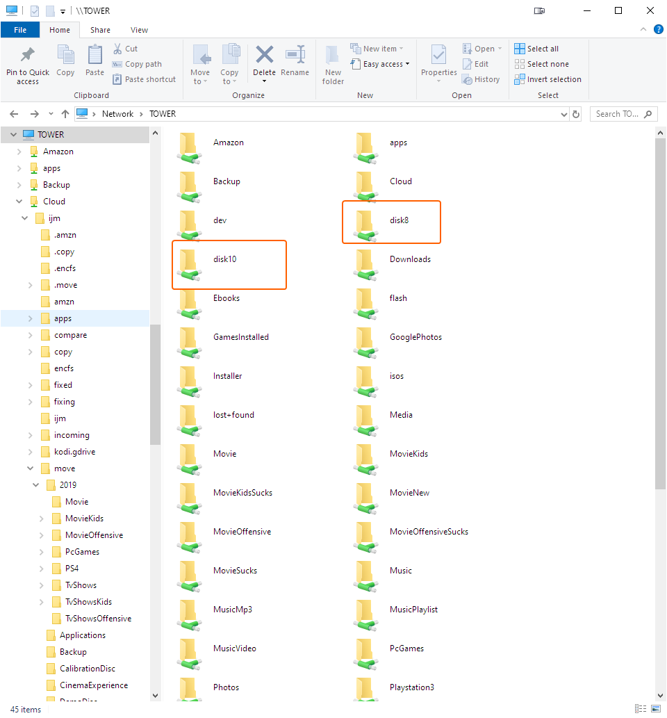

Those are either disk shares, they can appear if set to auto and those disks don't have any user shares (Settings -> Global Share Settings) , if it's not that it means top level folders called disk8 and disk10 exist on some disk(s).
it doesnt look like that before. disk 8 and disk 10 should be in the array.
what should i do?
They are in the array.
i took a snapshot of current settings
should i set new config like this?
after set the new config, i put the drive in the slot as the first image. would that fix the out of array problem?

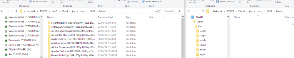

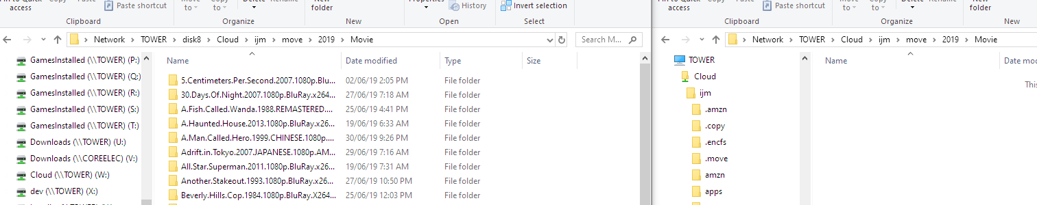

this is what it looks like in the array vs the disk
as you can see, the contents of a folder in the array is empty, \\TOWER\Cloud\ijm\move\2019\Movie
but there is contents in the same folder in the disk 8, \\TOWER\disk8\Cloud\ijm\move\2019\Movie
Eons ago i change the settings in the global share settings. i have add those drive to the included disks.
unfortunately, the folder still empty.
what gives?

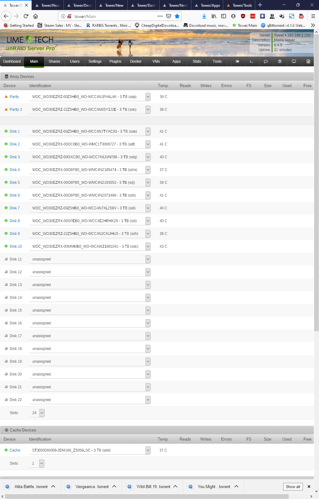

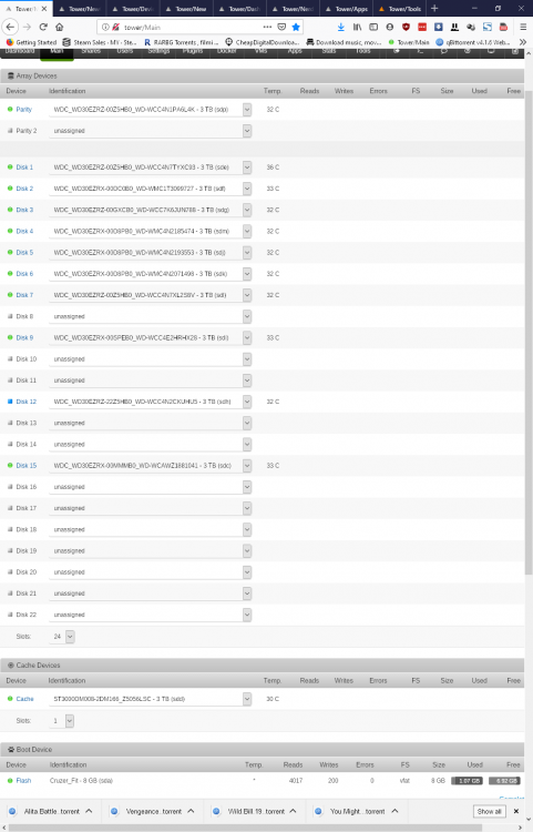

this is what my configuration looks like before.
this is what it looks like now
certain folder are missing now.

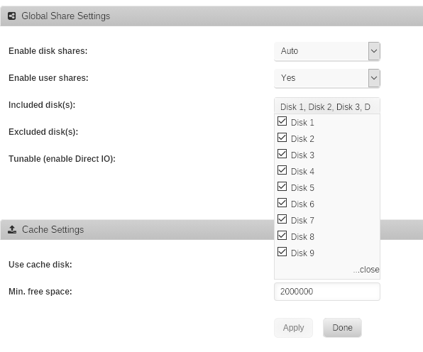

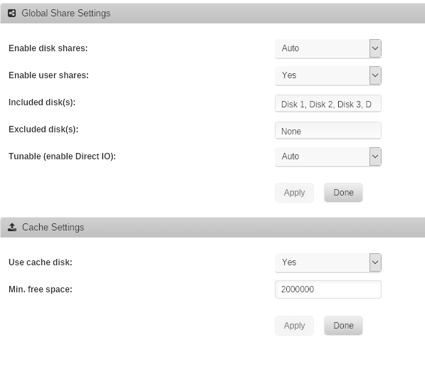

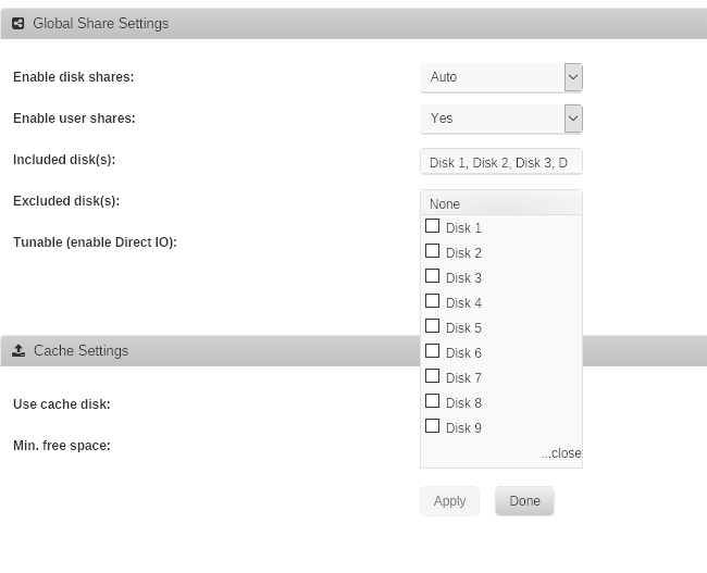

Like mentioned, it's related to the disk/share settings, make sure user shares includes all disks and none are excluded.
this is my global shared settings
all disks are included
excluded disks are none
i have remove the ddrescue recoverd disk from the array(new config), by the way.
ok. after mounting the drive, i can see the missing folder.
i guess i cant mount drive recovered from ddrescue. i need to copy the content recovered by ddrescue to array.
Not sure what you mean but as long as it's working...
On share setting included disks should be set to "all"
Edited by johnnie.black

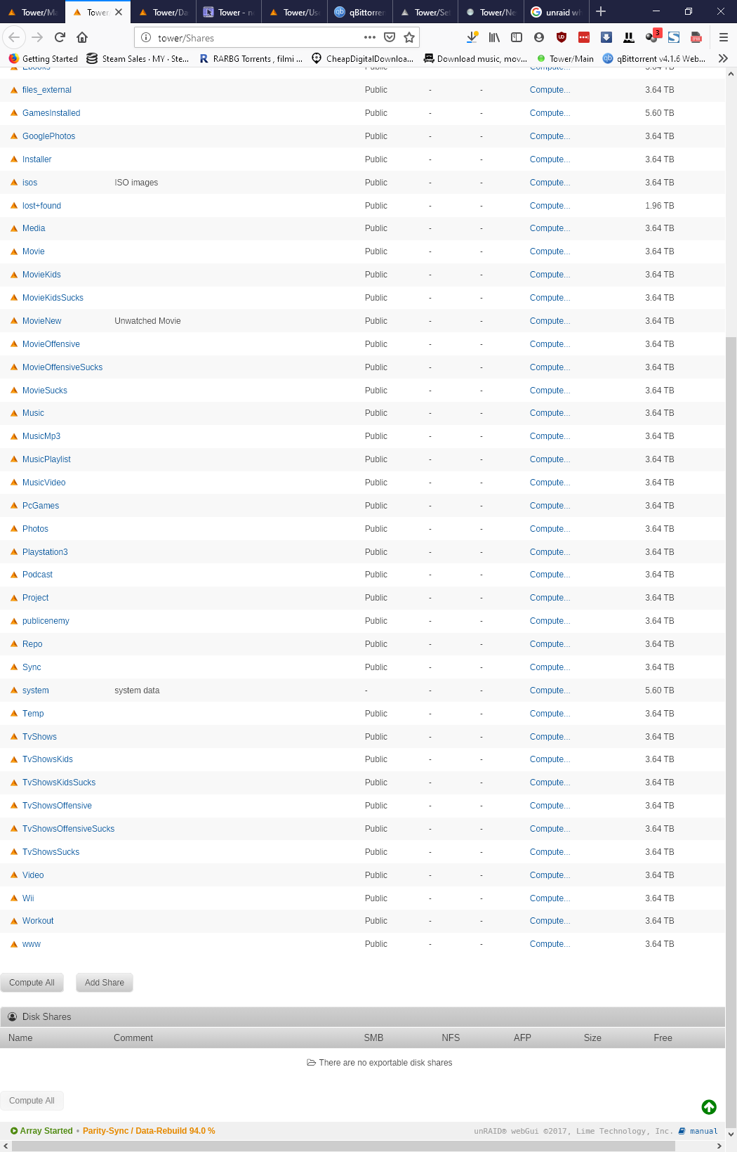

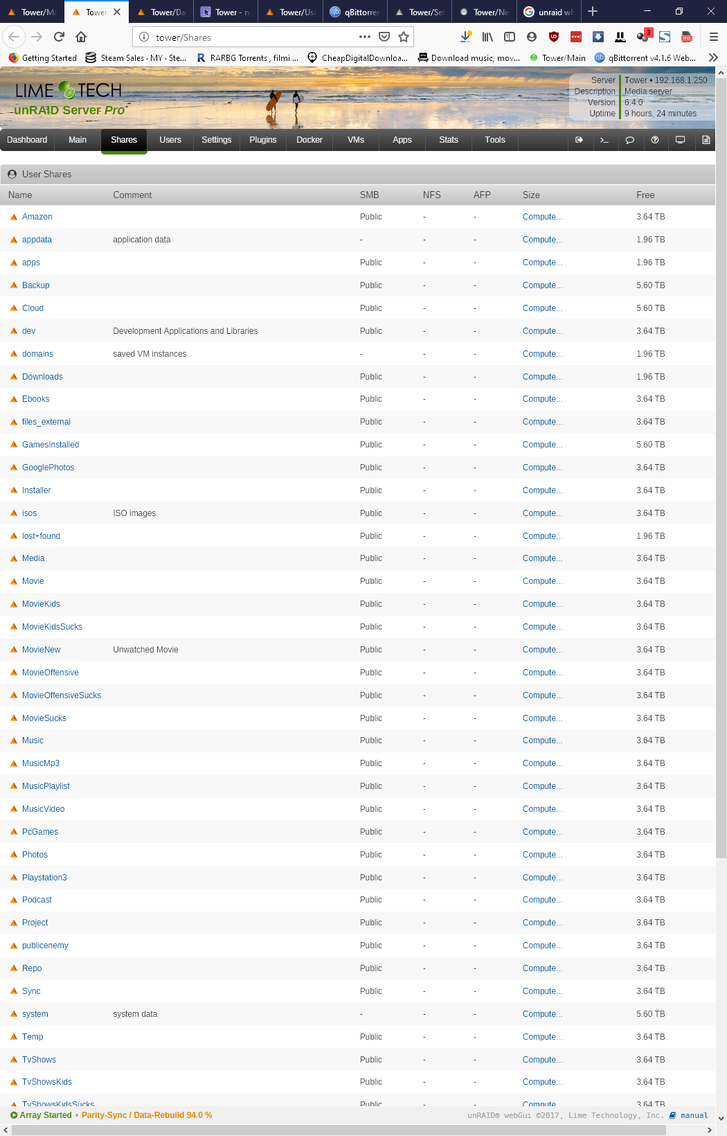

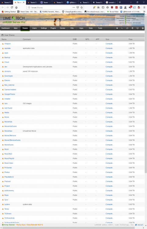

Post a screenshot of Shares - User Shares from the Unraid webUI. Possibly you have accidentally created some user shares with disk names.
I don't recommend even working with individual disks on the network. Best if you don't share any disks and just work with user shares. It can cause confusion and even data loss if you try to work with disks and user shares both.
here are my user settings.
