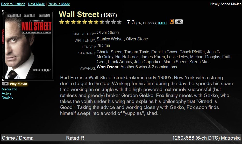

I used to have Syabas Popcorn Hours, and for those I used a GUI called YAMJ. IIRC, you'd run the thing and it would generate the media files for the "enhanced" interface to the PCH; including .xml files. You point PCH at it, it reads the files, bingo. I assumed this was going to work in the same sort of way.
Now, I have this Roku (not my only streamer, I'm just saying for this project), and they have a private channel called Roksbox...where if you install a web server, it can push local files to it. They recommend Mongoose, if you're a noob, and Apache if you have a little more experience.
