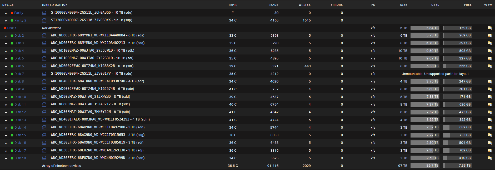

ok how to start i have a array of 20 hdd's with 2 parity
about 3 days ago i had a HDD go bad thats ok im waiting on the RMA which should becoming tomorrow
so disk 1 was being emulated
and today i come home and found the server off  when i rebooted i have my 2nd parity drive disabled and another disk from the array was saying
xfs Unmountable: Unsupported partition layout

done a restart of the array and disk 7 is Unmountable: Unsupported partition layout
also as i have 2 parity drives ok parity 1 is disabled for some reason im sure that was from crc errors
parity2 i hope is standing in for disk 1 which im waiting for my RMA today at some point
what is the best thing to day about disk 7 ?
as it looks like ive only got 1 parity drive running
Edited by gavin_UK

Since you have parity2 you can rebuild parity1 even with missing disk1. That would be better than your current situation, since you have no redundancy now with 2 disabled disks.
This is what im worried about
when i get the replacement disk for disk 1 and go to start the array its going to say do a parity sync to copy data back over to the new disk

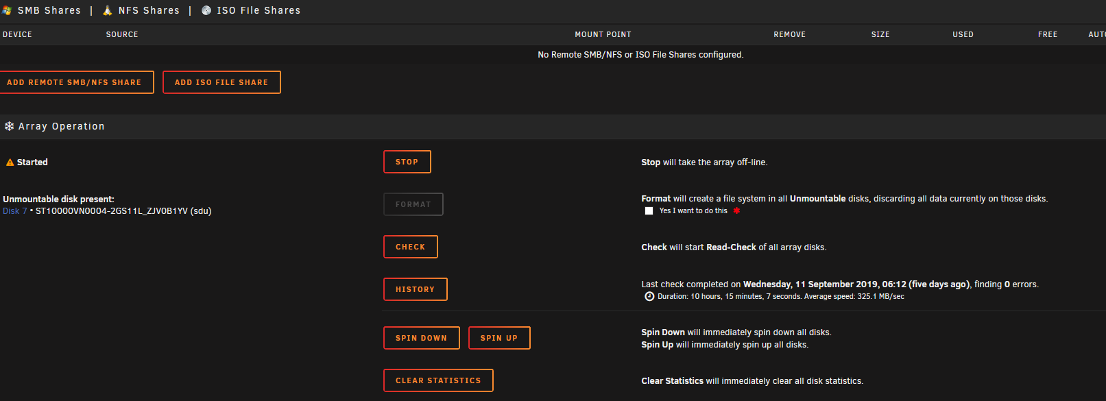

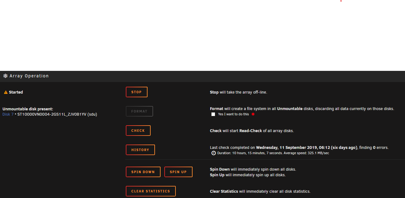

would it also force Disk 7 (discarding all data currently on those disks) to format as thats what i keep getting on the Array Operation panel
ive only got one parity drive working with a 2nd faild hdd being emulated with a 3rd hdd Unmountable: Unsupported partition layout
it dont say it's disabled or being emulated does that just mean the files are not being seen
would it not effect disk 7
ok its doing a parity sync on to the 1st parity dive only 26 hours togo
disk 7 was able to stay as it was
would you say after that i should replace my disk one with the new RMA'ed one and the do a parity sync to just that
or
format disk 7 and replace disk one and do both at the same time
12 minutes ago, gavin_UK said:
format disk 7
Are you ok with erasing all the data that was originally on disk7? That's what format will do.
wouldn't it just be replaced from a parity sync ?
Look closer at your screenshot. The Format button is disabled. It won't format unless you check the box to enable the button then press the button.
Format is a write operation. It writes an empty filesystem to the disk. Unraid treats that write operation just as it does any other write operation, it updates parity. So after formatting a disk in the parity array, parity agrees the disk has an empty filesystem.
