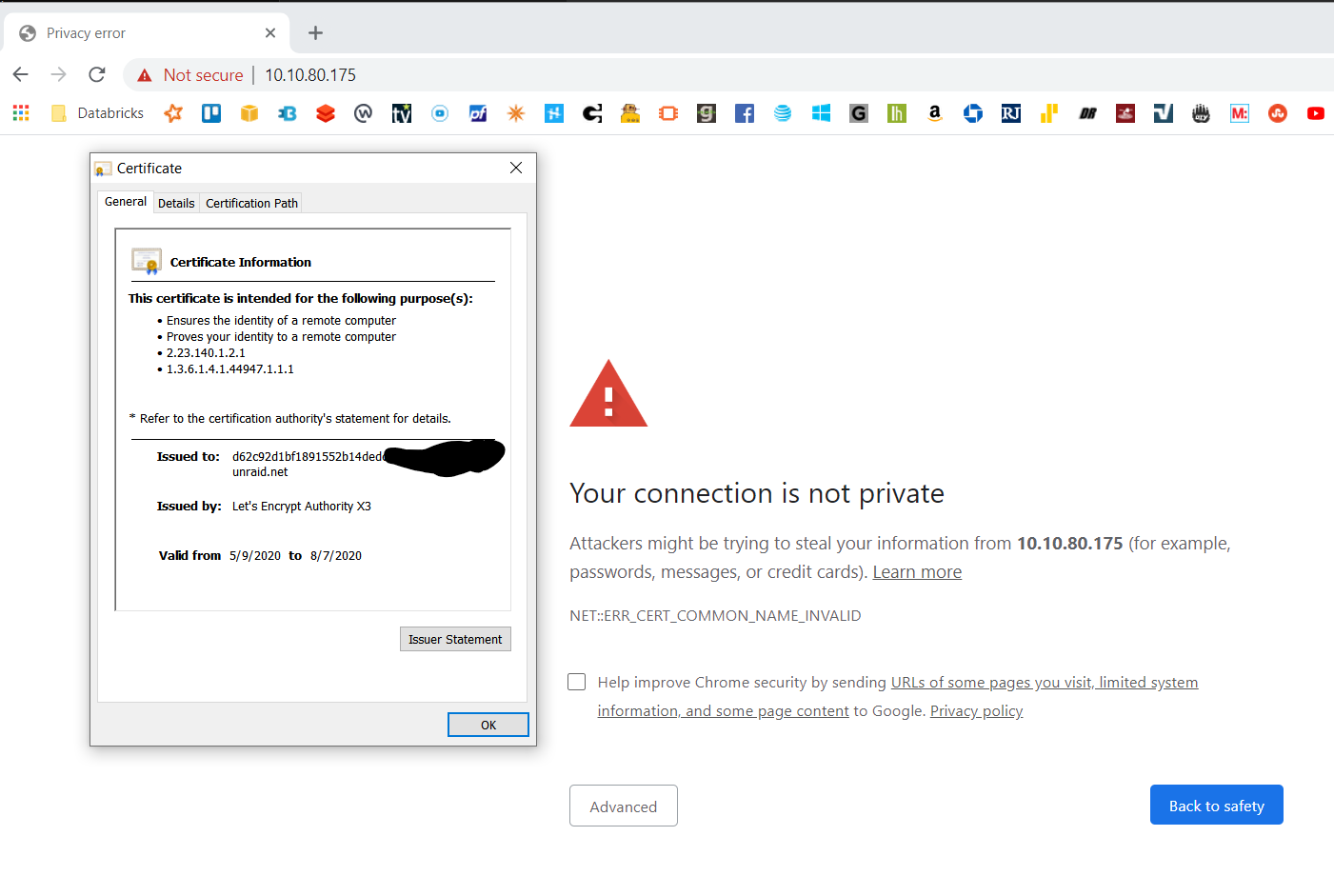

July 6, 20206 yr Hello, I've just switched from letsEncrypt to using my own certs, signed by my own CA. Everything is working with the public domains, but the local IP still appears to be registered with unraid and is pulling the let's encrypt cert from unraid.net. How can one deprovision their private ip and clean up the link with unraid's letsencrypt? Thanks
