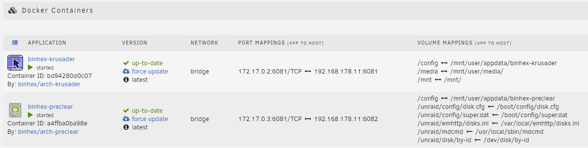

If anyone is able to help though, I'm experiencing a strange networking problem bringing my docker containers back online.
Before restore, I was able to run containers that used VNC, but now I seem to be getting some strange port conflicts.
I have a VM running, with VNC enabled, and now any dockers using VNC redirect to it.
I'm also unable to run multiple dockers with VNC, like binhex-crusader and binhex-preclear.
I get an "execution error", and I can't see the logs showing anything useful.
Change one of the host ports.  IIRC, they both use 6080 by default
Yes, they use the same port.
Why was I able to run them together before without changing anything?
Seems like something has changed.

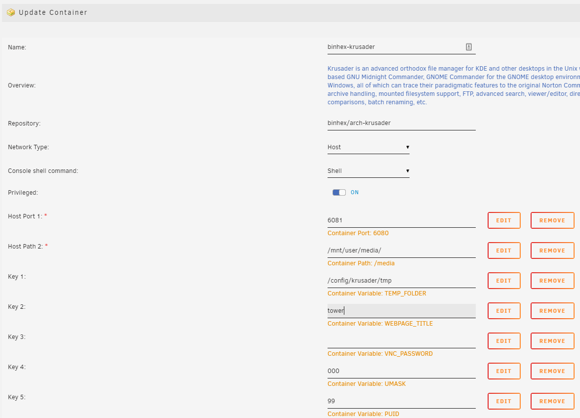

I manually changed the ports to 6081, and restarted containers.
Still redirecting to my VM, and it doesnt seem to reflect in Unraid UI.
Its the strangest thing, I set new ports in the UI.
I've ven tried deleting the container, and starting again.
And it still shows as 6080, even after deleting, new, set correctly.
I'm not sure what's going on.

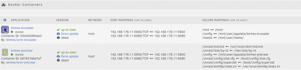

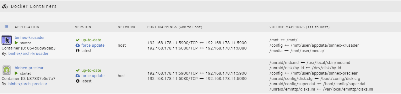

Switched them back to bridge, and they are still inaccessible.
New port shows up in UI, but nothing is accessible on those ports.
Emptied my browser cache, etc, which I've seen suggested in other threads.
I'm starting to think that this installation is borked.
Edited by KptnKMan
And hitting webUI when you click on the icon also does nothing
I'm afraid not, it's very strange. It seems like the docker UI is somehow only half connected to the config.
When I changed the port, I noticed the the Web UI link did not update, but I fixed that and it still doesn't work when pointed to correct port.
My VMs start fine, and the dockers can start, but the docker networking seems to be all weird.
