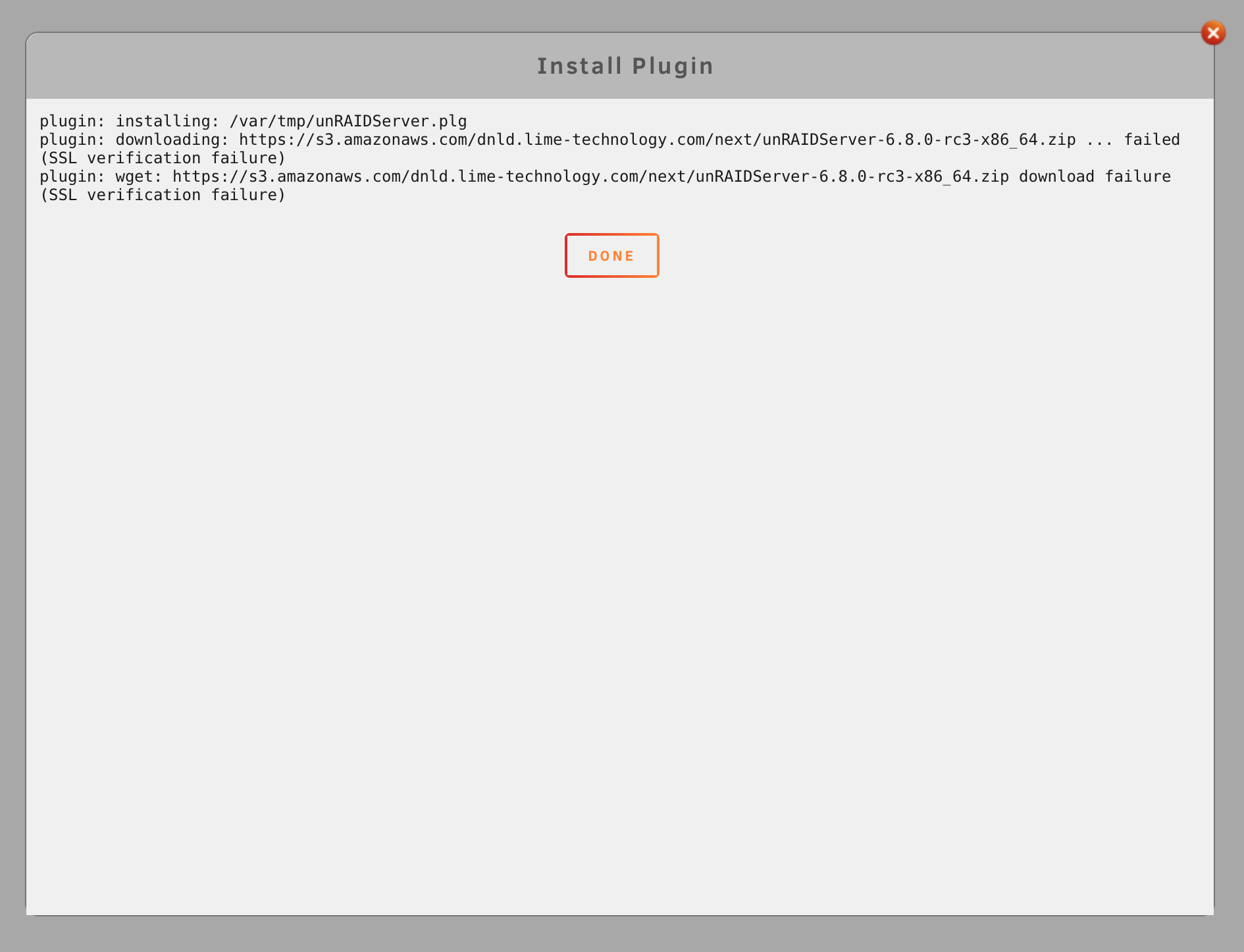

For some reason I can't upgrade to the latest RC3 (from 6.7.2). The webui is acting strange. I had to click the button several times to upgrade and after that I receive a error. See the screenshot posted. When I manually copy the link in the browser it downloads the zip file from Amazon. Your thoughts?
Looks as though there may be some issue at the Amazon end?
If you can get the zip file then you can manually upgrade by extracting all the bz* type files overwriting the versions the flash drive
Other people had similar issue and turned out their network was wrongly configured.

Yes, that could be the case. I struggled a bit with the setup of my network. I have add-on 10Gb Nic and I wanted that to use.
I also have issues with updating Docker containers. It shows updates but there aren't because the download is 0kb. Maybe that is related.

I investigate a bit and I disabled "bounding" in network settings. It seems that my problems are solved now. I upgraded to RC3 and the Docker containers updates also the right way.
Please if my Network setting are not properly configured let me know!
Edited by MvL
Bonding interfaces which have different speeds (10G and 1G) usually gives problems and is not recommended to do.
You did the correct change.
